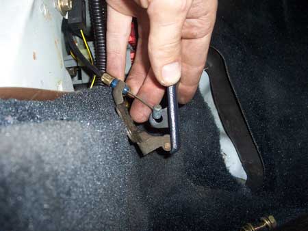

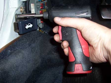

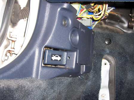

Remove the plastic kick panel cover. Remove the two 10mm bolts on the handle.
Detach the cable from the handle.

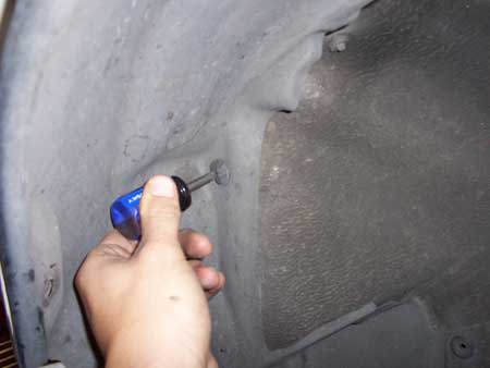

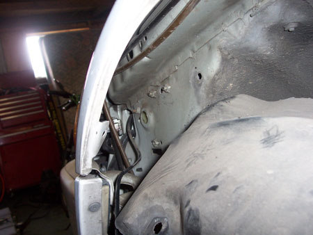

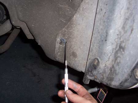

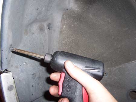

Remove the splash guard in the fender. A lot of times it's easier just to pick the plastic screws out instead of screwing them out.

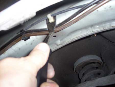

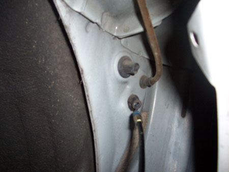

Pop out the tabs that secure the cable to the inner fender and then pull the cable through.

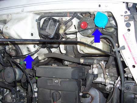

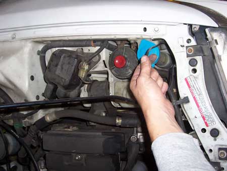

Open the hood and pull the cable through near the headlight/turn signal.

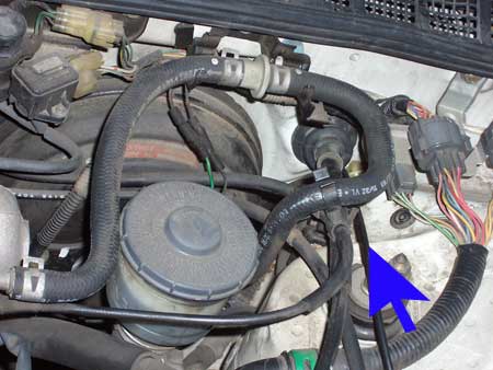

You can start re-routing the hood cable from the tab behind the headlight. I ran it underneath the cruise control to secure it in place away from the accessory belts. Run the cable through the engine bay as efficiently as possible because you are going to need as much slack as you can get. Later you can come back and secure the cable with zip ties.

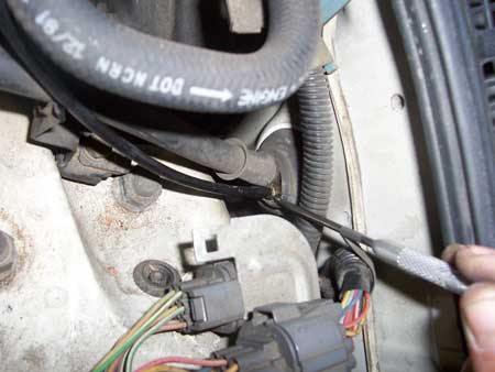

I made space alongside this other cable using an angle pick and a flathead screwdriver. On some cars you will have to drill a hole or run it through a wire harness grommet. If you're going to cut into a wire harness grommet, first disconnect the negative cable from the battery.

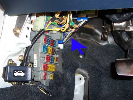

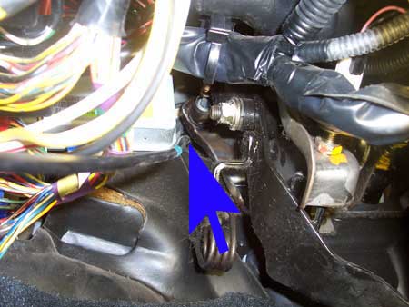

The cable drops down behind the clutch pedal interlock switch.
Use a deep socket or extension 10mm to remove the lower bolt from the under dash fuse panel, then run the cable behind it. Connect the cable to the handle and reinstall it. You may need to pull some extra slack through. Test it and make sure it works.
