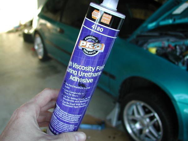

3. You'll be setting the mount on it's side to fill it up, so tape the back off to hold the urethane in.
4. Fill it up! Let it sit for a few hrs before moving, let it sit for a day before you use it in your car.

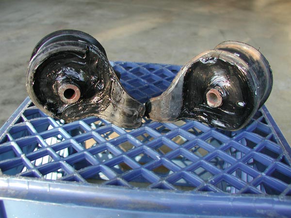

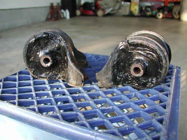

some pics:
some pics:
