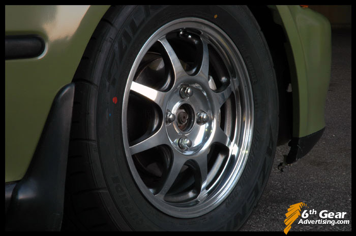

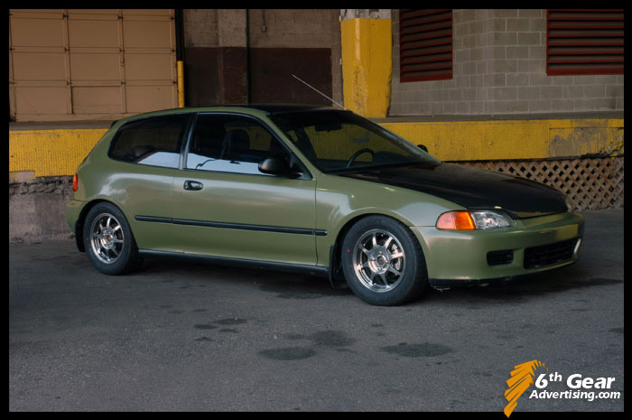

edit: finally, here's some finished pics:
