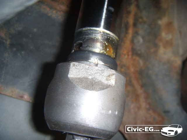

I've got these old school ball joint seperators which have only ever worked for me once. Normally they just tear the boot
Today was not my lucky day...
You can see grease from the torn boot. I had to end up hitting it out with a mallet which is bad for the ball joint. That's ok though because I am replacing the Inner and Outer tie rods and the outer has the ball joint.
