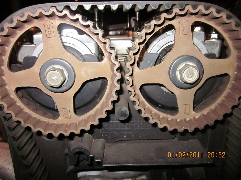

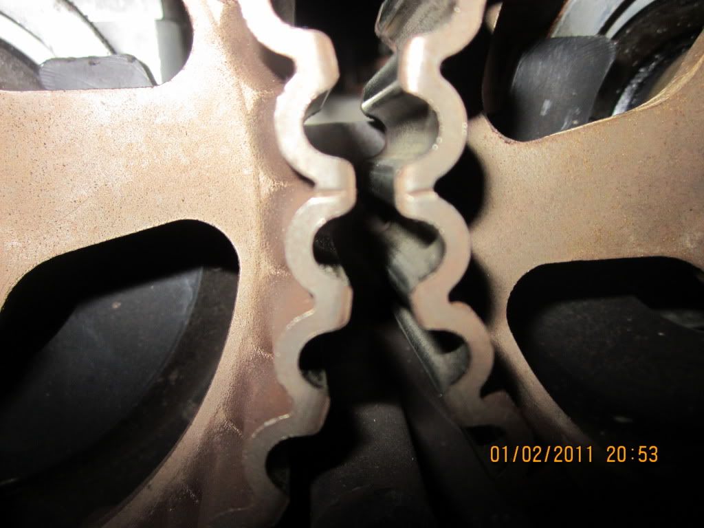

#231268 Ya'll tell me what you think, I'm a noob! Does this look good, or not....(timing)

#231308 In my opinion, and I'm not a turbo guru by any means, but you would be better off to just go and get a proffesional tune. I've heard weird problems arise with turbo setups, tunes usually solve the problems 9 out of 10 times. Go get the tune.

jrhdominos wrote:In my opinion, and I'm not a turbo guru by any means, but you would be better off to just go and get a proffesional tune. I've heard weird problems arise with turbo setups, tunes usually solve the problems 9 out of 10 times. Go get the tune.
Yeah I agree, but the dyno shop sent me a base map that it should run with. (but not hitting vtec or boost, just idle.)
I want to make sure everything is RIGHT before I take it to the dyno, that way I'm not working on the car while it's sitting on the dyno. That gets expensive.
I just decided I would put it back together since I didn't get a response here or on the other forum I'm on, the timing looked good to me I just wanted a second opinion. Also, the plugs were pretty black so I clean them and gave her a go....

#231320 your cams looks accurate in those pics but is the crank mark for tdc inline with the pointer on the black t-belt cover?
also yea i wouldnt take it to A dyno not running. that would prob end up costing more money than throwing parts at it.
maybe its the base map? where did that come from?
maybe try throwing a b20 ecu ecu in it for a minut and see if it will even stay running for more than 2 seconds with it in.

93hatcheg wrote:your cams looks accurate in those pics but is the crank mark for tdc inline with the pointer on the black t-belt cover?
Man, I'm a complete noob with this stuff, would you explain that alittle more?
The base map came from a shop in TN, called DynoSpeedRacing.
