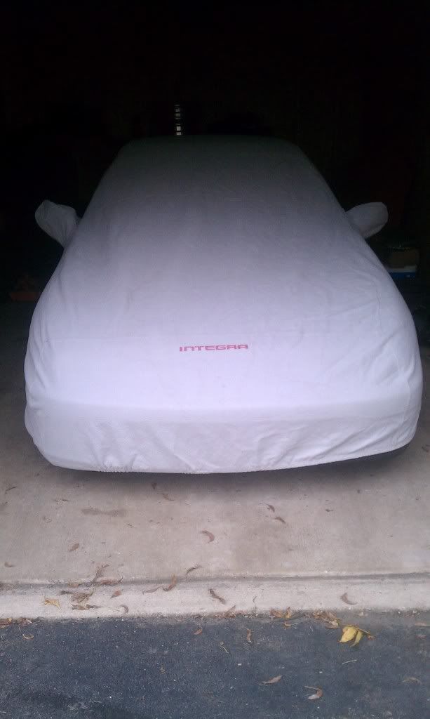

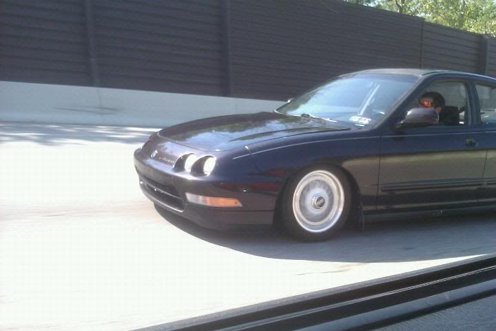

#284019 This is one of my current projects and I have big plans for it I've done quite a bit to it already which I will post up here after a bit but it still has a long way to go.
My future plans are to do a ground up build and leave nothing untouched.
Anyways enough talk on to the pics
The car is currently in storage covered due to my wife and I being in the middle of buying a house but as soon as we get our house the build will be under way.

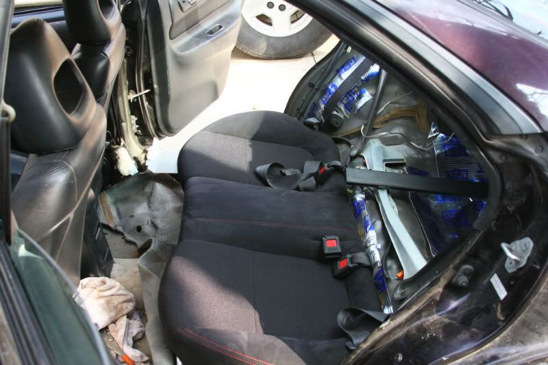

So I started with pulling the front and rear seats.
As you can tell the carpet was ultra nasty.

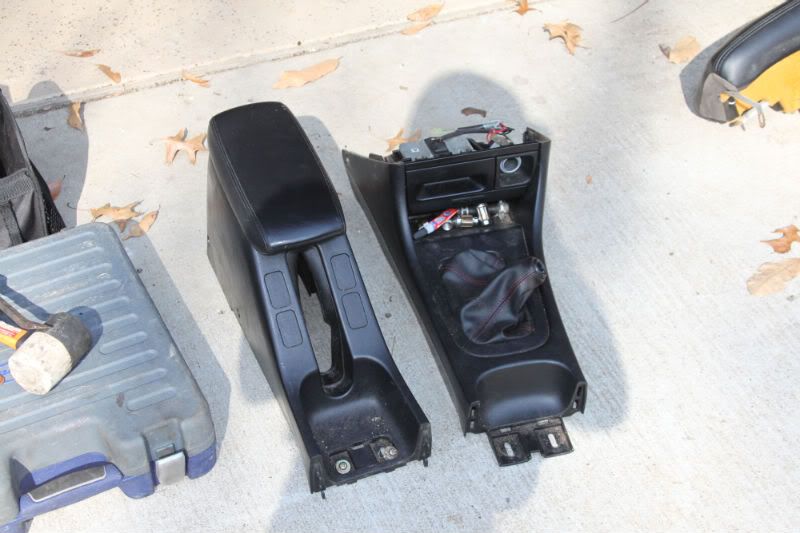

Next I removed the center console.

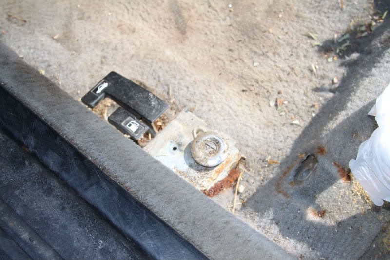

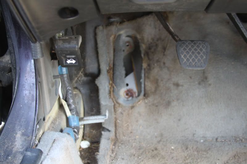

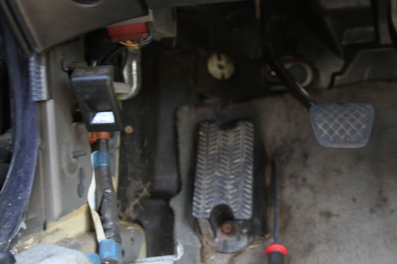

Next I had to remove the few misc things like the trunk and gas door latch and dead pedal

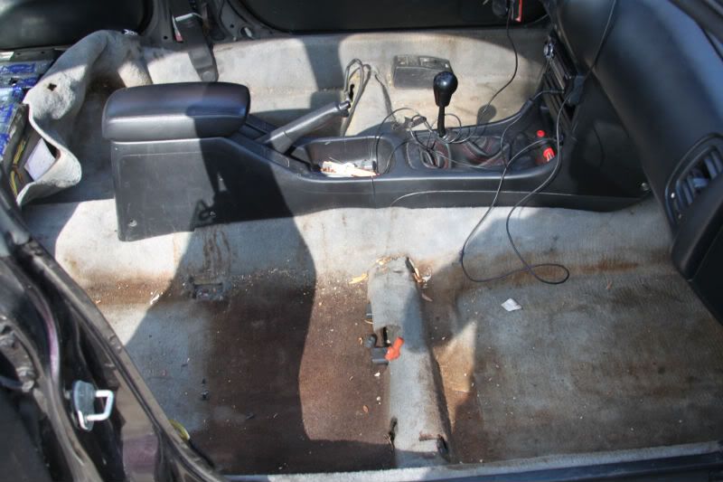

By tegpower18

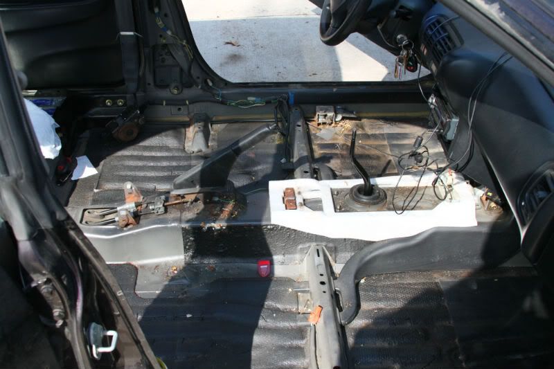

#284087 Also you need to remove the side covers under the dash also

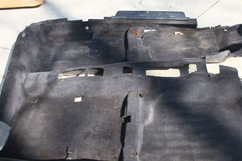

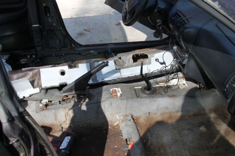

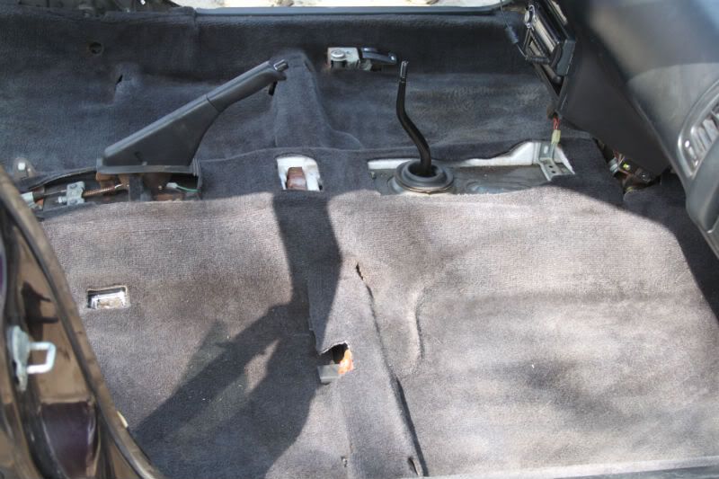

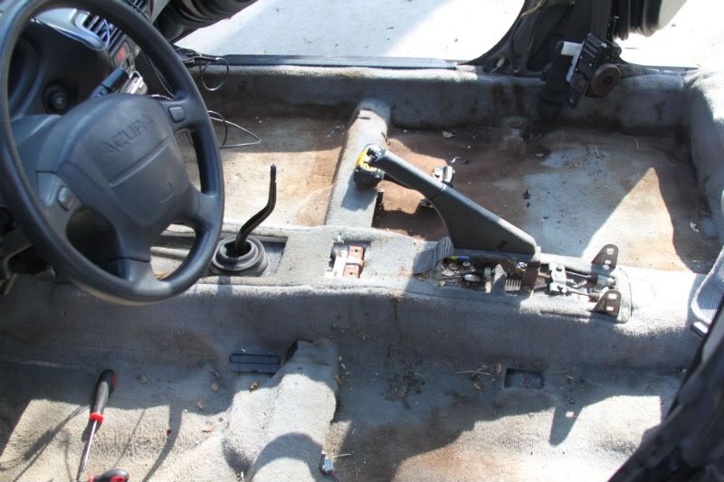

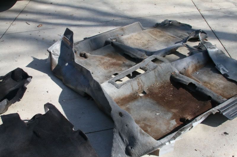

Then I started removing the carpet and the step side covers on on the outer edge under the doors.
Now the carpet is removed. If you dont feel like removing the whole dash to remove the carpet you have to cut it up towards the firewall. But since its hidden no one will ever know.
Old nasty carpet out

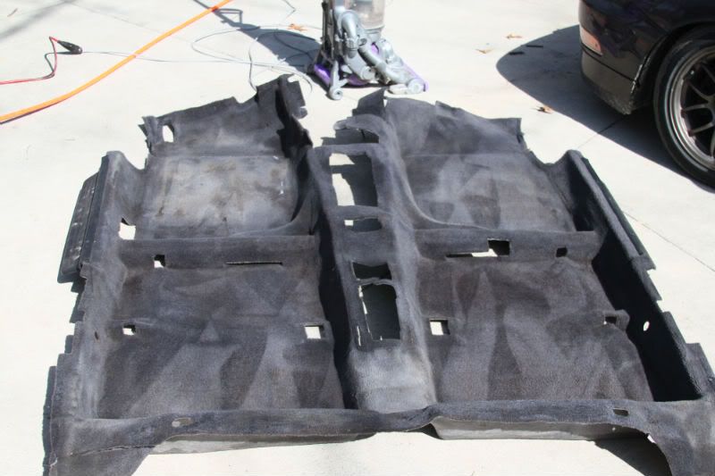

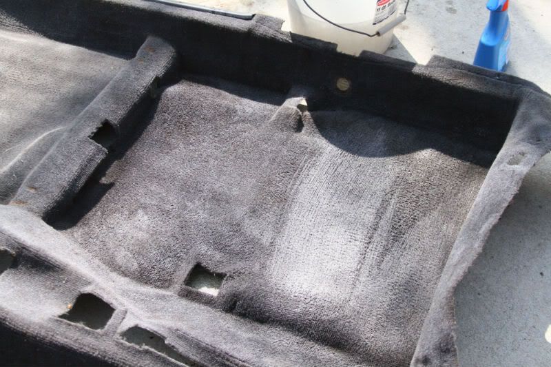

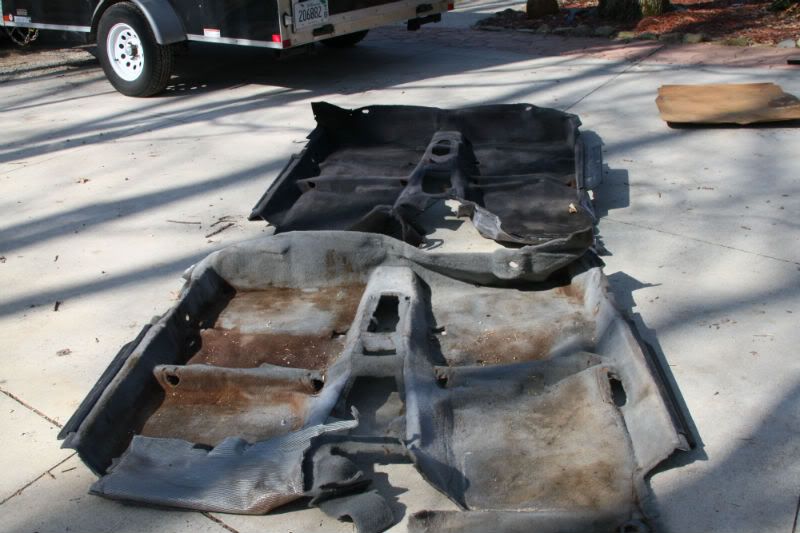

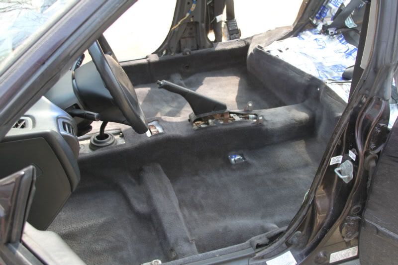

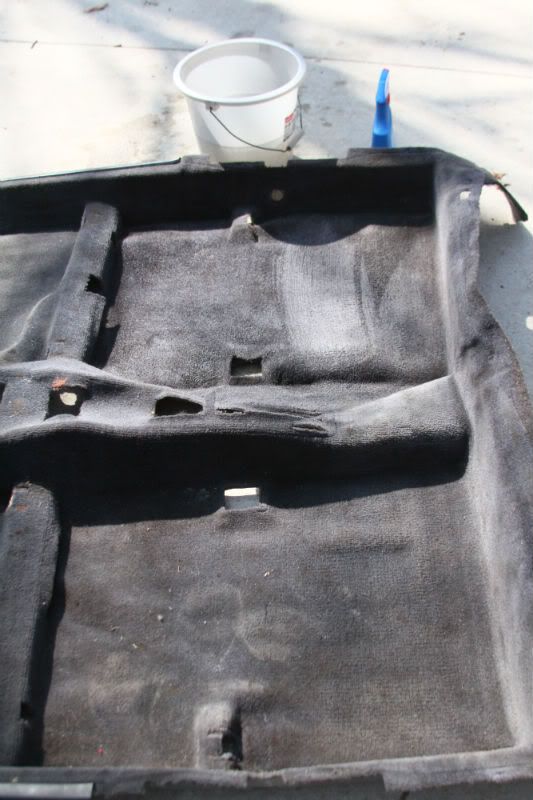

#284088 Old carpet vs new but as you will be able to tell the new dark grey carpet still needs some work an cleaning
And as you can tell it needs some work
And so the scrubbing and cleaning starts
In this pic you can see the three sections finished vs the worst drivers section

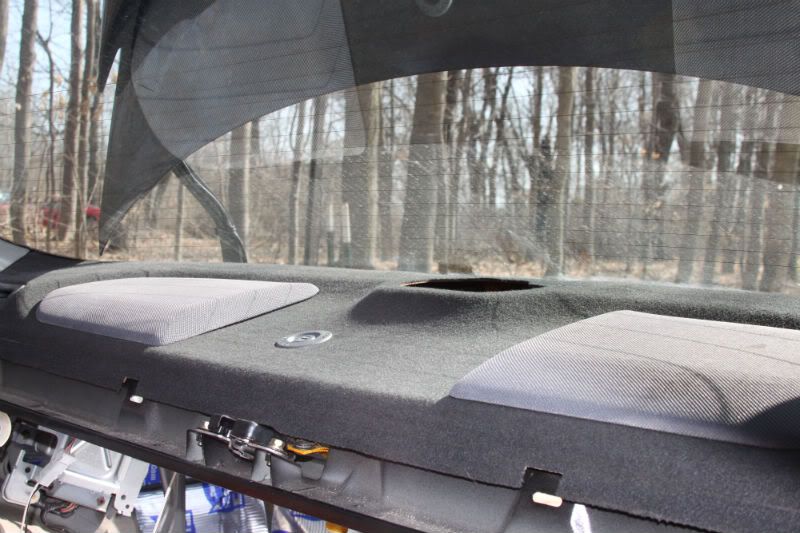

Now it was time to start on the rear speaker cover
By tegpower18

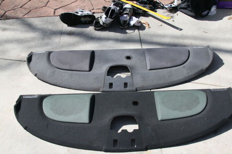

#284089 Now here they are side by side now as most of you along with myself can see how bad actual covers look that came on the dark grey cover So I decided to switch them and was very happy how better it looked
So here they are switched MUCH BETTER

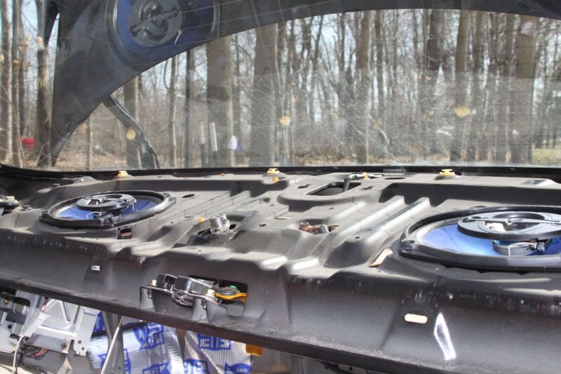

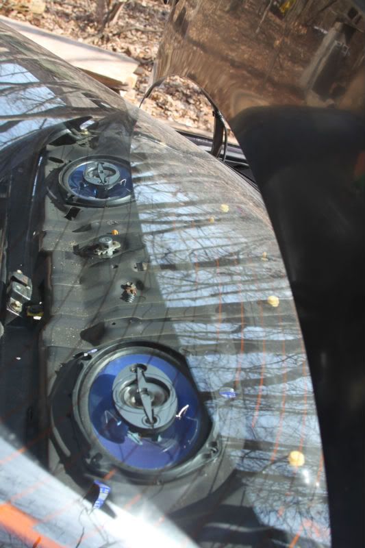

Cover off with nice new 6 1/2" pioneers. I was worried about them actually fitting but they did which was nice

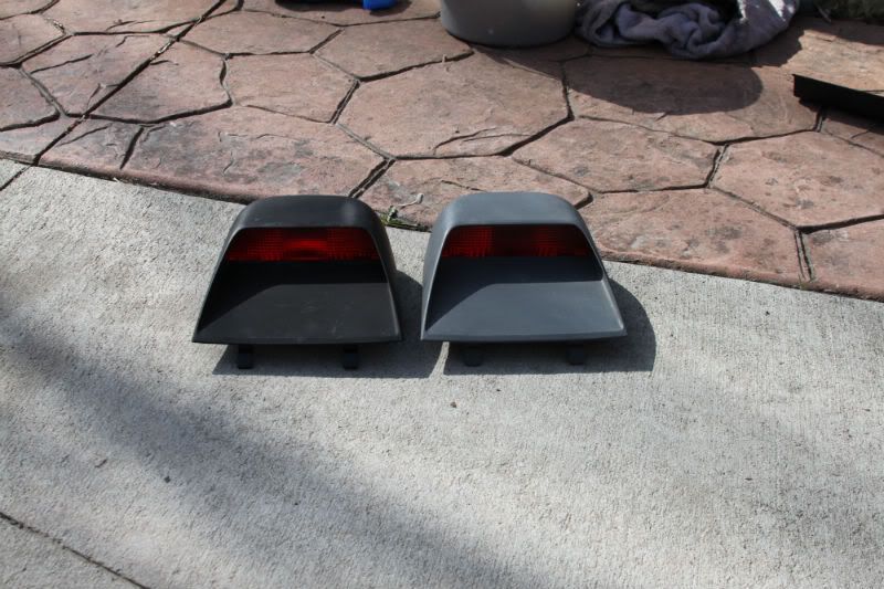

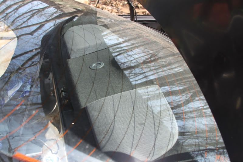

I also decided to change out the third brake light cover also which is black and matched the other pieces much better
New cover installed

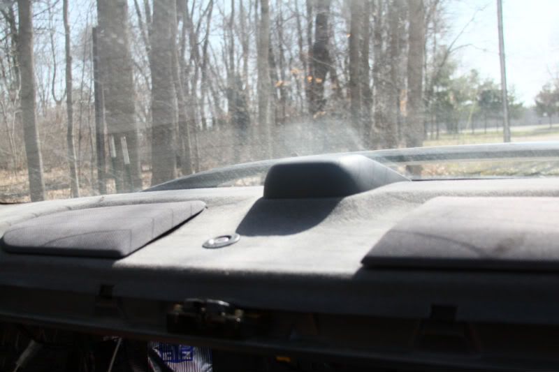

#284090 A pic from the outside
I was very pleased with this even though its something so minor it made a huge difference.

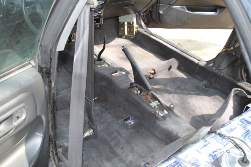

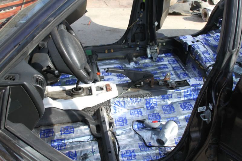

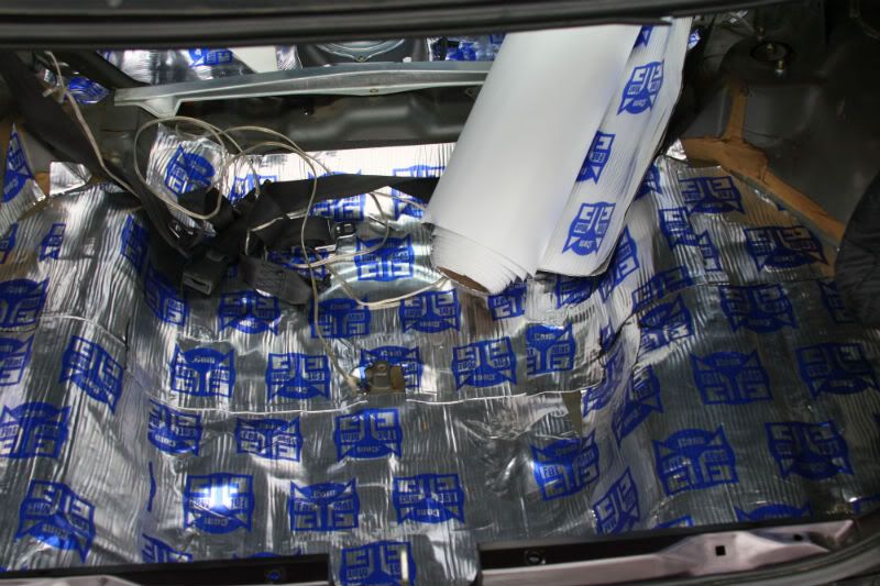

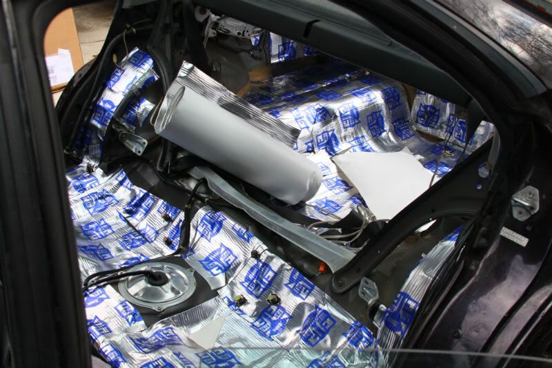

Next I started the sound deadening material
Now that thats finished it's time to install new carpet.
Ahhh so fresh and clean

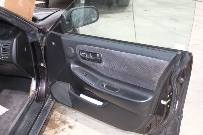

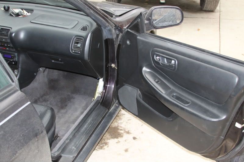

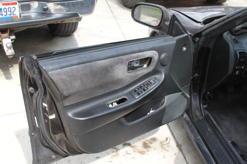

#284091 Next was the door panels here are the old black/light grey cloth door panels
Here are the new black leather door panels installed so so much better

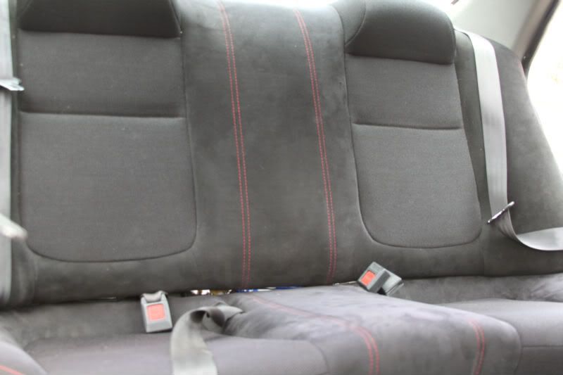

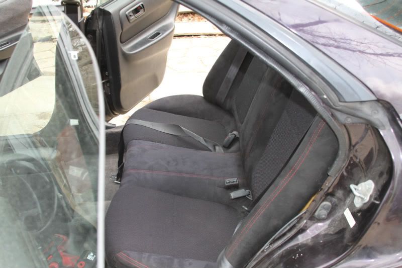

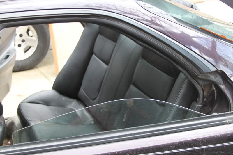

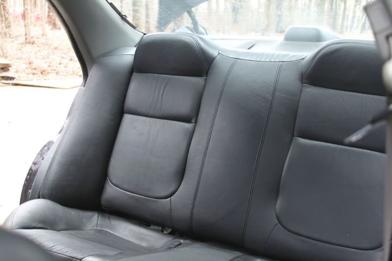

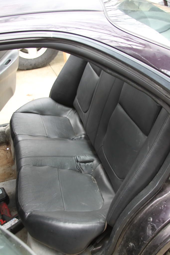

#284093 Next I went ahead and installed the rear black leather seats but wasn't planning on leaving them in very long

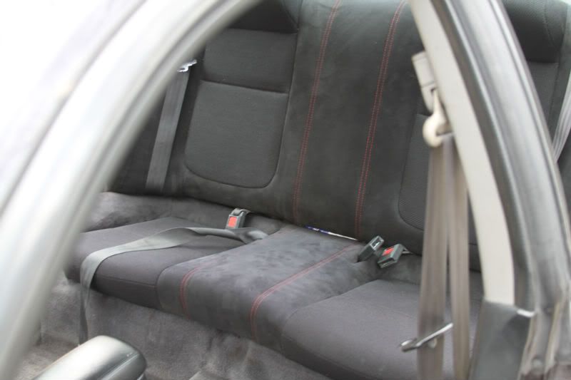

Only reason for not keeping them in long was because of these sexy beasts going in....Ultra minty db8 itr rear seat 9.5/10 condition Super rare in this condition

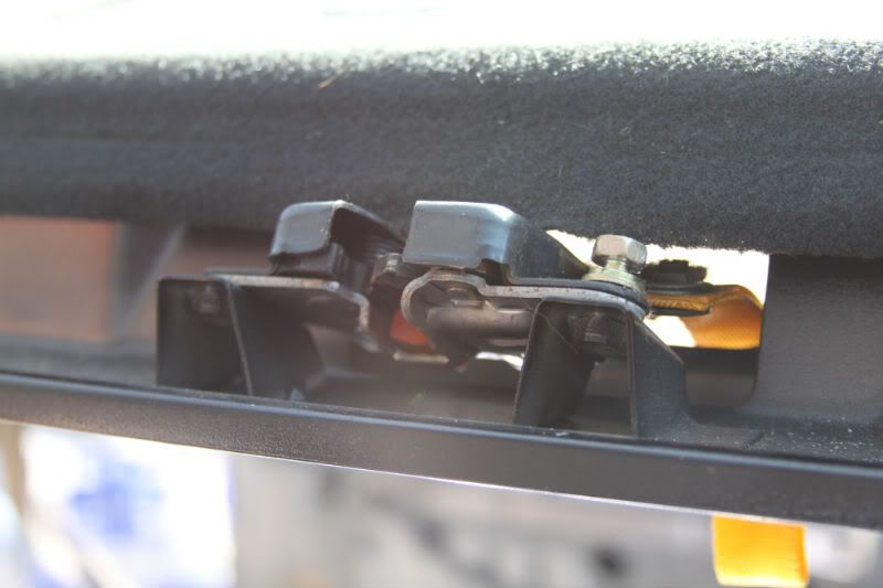

Ok so now to show how I got to this process because the db8 itr seats dont fold down and are a 1 piece back pad instead of a 3 piece and have an extra tab to hold it in place. So I did not want to modify the seats since obiously in the first place its hard to come by let alone in this condition. So I decided to modify the car the correct way.

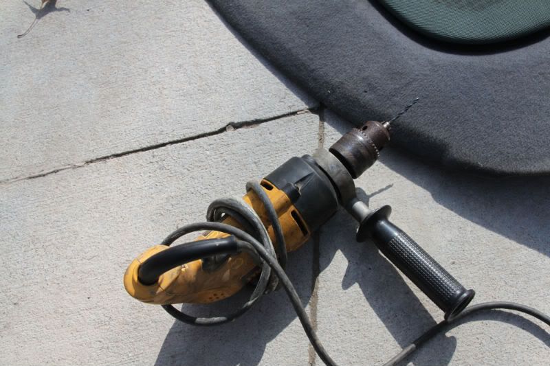

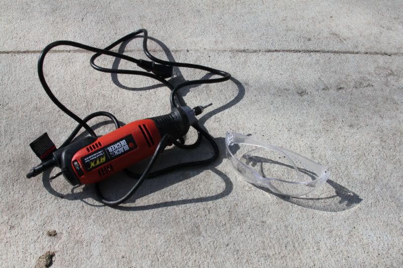

So I was gonna need some tools
First I removed the latch and lock because I wouldnt be able to use it and it was in the way of what I needed to do

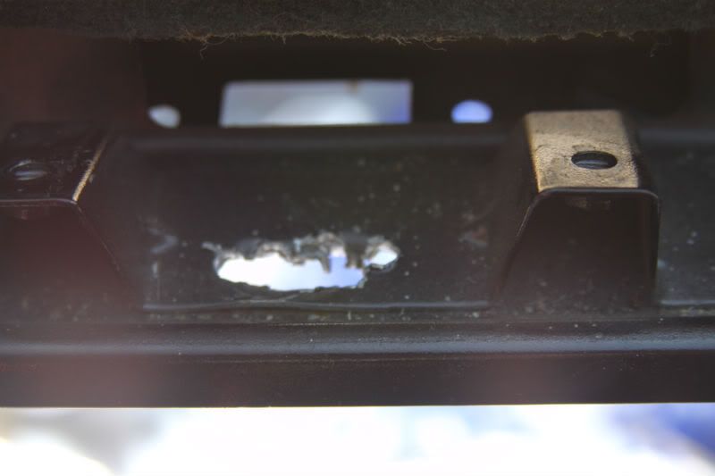

#284094 Then in the following picture you can see the prestamped outline of where the middle "third" tab would be normally for the itr seat.
So next I started cutting which didnt work out so well at first because I didnt have the correct attachment for my dremel
I then started thew fitment process
But afterwards I got the correct attachments and cleaned it up considerably and then installed the seat. It didnt take much just alittle tweaking and some time much better than cutting the tab on the seat and it fits perfectly. I had talked to several people and they said that since they cut the tab the seat wouldnt stay and fit properly.
By tegpower18
#284095 In the last pic above you can see a minor gap that was becuase I hadnt touched up the cut out yet and it was not open enough for the tab to fit all the way in so it was keeping it from sitting flush.

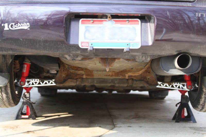

During all this I also decided to switch out my lca's for some f7's because my blox ones were junk within 7 months
By tegpower18

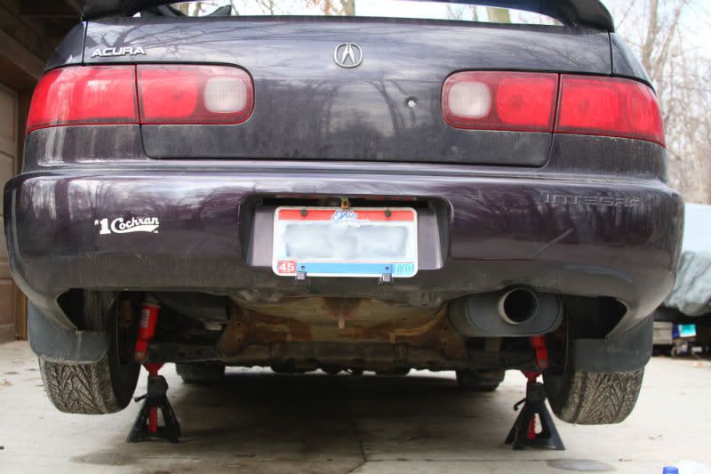

#284096 Dont mind the rust the car is currently tucked away and waiting for my wife and I to get our house so I can get it into a garage and start tearing it down and rebuild it from the ground up
