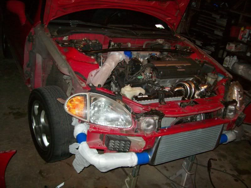

in the morning half way to work i layed into it, at about 6500rpm she fell on her face and sputtered...
ok so i figgure keep it at around 5500 rpm shift ill be fine...
between lunch and after work i prolly did about 6-7 pulls like this 2 gears each pull...
made damn sure to let her cool doown and warm up each stop.....
well on the way home i loose track and hit the 6300 mark and she kicked a check engine light and went into safety...
well i pulled the backup fuse, and let her sit for about 20 min....
after that i drove up to mijer and she seemed just fine....
after mijer (30-45 min later) i get out onto the main road taking it easy because there is no reasion to push it...
well about a mile down the road i look in my rear view mirror and see some smoak trailing me... black smoak... oil smoak

well ok the oil smoak... no rhyme or reasion to it and lots of it... no set pattern, i tried goosing it,
engine braking... its so random that i was going streight line constant rpm she would smoak real bad (embarrisingly bad) then stop then a half mile later start smoaking again....
ok so here is what i came up with ;
A: oil seal in turbo is already shot (even tho i was running a restricter vavle at 3/4 open)
B: valve stem seals, throwing it out there, unlikely because usually they are just slow drippers, most the oil you see is on start up.
c: ring/piston crackage, again unlikely to me, yes i did have that good knock earlier, but it would be smoaking all the time, not just really really bad once in a while...
at the moment i dont have the time to take the turbo out of the equation and put the stock headder back on to troublshoot, and this will be a wasted effort if it is the engine...
i have no real effective way to test the valve stem seals other than eleminating the other options...
so i investagated the ring/piston crackage...
i pulled the plugs and looked at them....
ok not the best way but it works till i get my hands on my dads compression tester.
so as you can see they look just about the same across the board...
also today i closed down the restrictor to 1/3 open... if it smoakes less or not at all.. that would be a good indicator that the issue is the turbo oil seals.
tomorrow i will compression test it and if it turns out the same as pre-turbo, ill do an un-install on the turbo system...

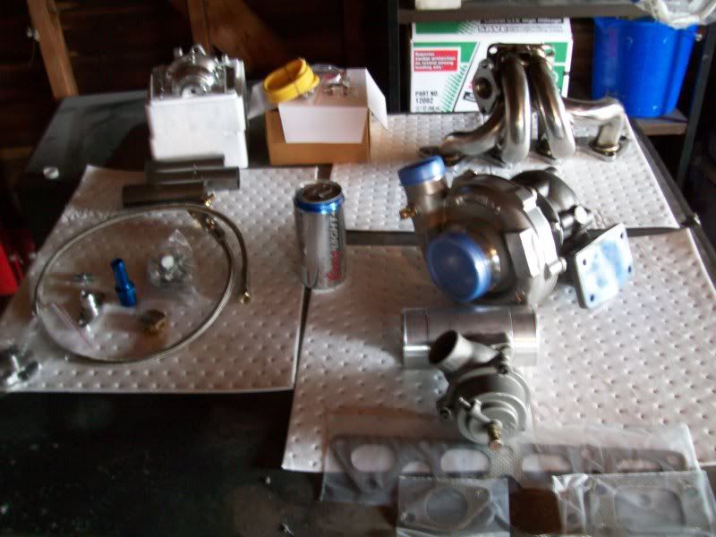

ran it just enough to get addicted to boost, im just blown away by the diffrence even at minimal output on the turbo's part....
i kinda assumed the turbo in this kit would be junk... but i never thought it wouldnt even last a month!!!
