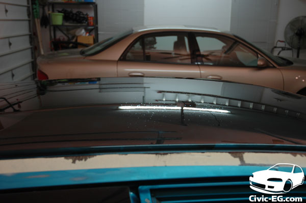

the secret is to to LIGHT coats. I see too many people making it too thick and it looks like truck bed liner when they roll it on. My first coat was too thick so I wiped it off and started again. This is the second coat after I removed the first coat.
it was actually a little too thin, but better to be too thin than too thick.
a few coats later...
someone opened the garage while this coat was wet and got a shit load of dust in the finish
but it all sanded out and was fine after
I'm on coat 6 right now, I am going to do a few more coats.

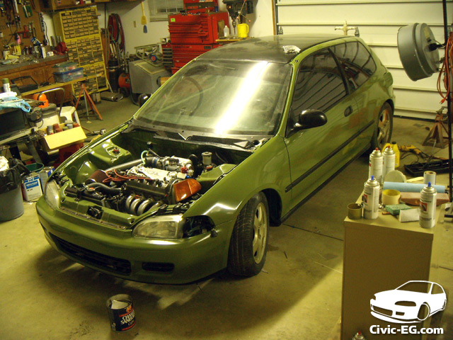

pics from last night:
overall I'm happy with the result! These pics were taken while the paint was still wet, so they look a little bit glossier than the final. After it cures, I'll do some wet sanding and bring that shine back to where it is in the pics, and then some.
There's a little bit of orange peel happening on the left door which will be taken care of in the wet sanding too. Not bad for doing it by myself in a garage
