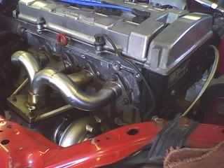

not shooting for anything crazy, looking for just over 200 at the wheels.
just went back over everything and all seems to be leak free still. I'm happy with todays progress of getting the mani, turbo, downpipe, oil pan, and oil lines all hooked up and running. only setback is i gotta get it up on a frame rack or get a good winch cause my front end needs pulled out an inch or two. gotta have that done so my charge pipes fit right plus the fan shroud is already up against the slave cylinder.

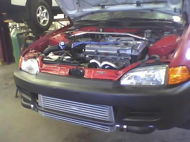

#218596 well... here we go again
couldn't look at that ugly cast mani and shit downpipe any longer...
twin scroll time!!
like my new front lip?? :P
not gonna keep the stainless steel IC piping on it forever and i really didn't care about hacking up the feebie aftermarket front bumper i had.
it'll be driveable by the end of the week once the downpipe gets welded up. I'm gonna go drop off the ECU monday to get a chip and basemap put on. it's goin down.. :twisted:

yes, i'm using the stock EVO internal wastegate and the reason i need the downpipe "welded up" is because...
well, my manifold is custom and i'm using a mitsu turbo. no one sells a downpipe thats gonna bolt up to the mitsu o2 housing and tie into my existing exhaust.. so that ish has to be made :lol:

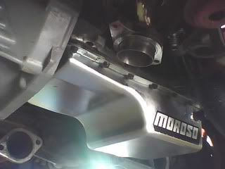

#219216 that is a very nice oil pan indeed.
