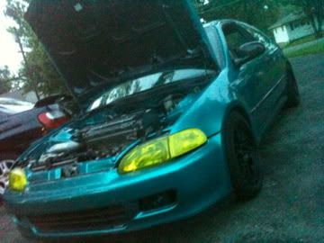

#260050 hey yall been a while , finished my engine and did a photo shoot. enjoy

#260052 wow! lookin clean!
By K!RK_180i
#260199 i dig the yellow headlights 8) i also wanna do that to my headlights and your car is looking very beautiful buddy :thumb:

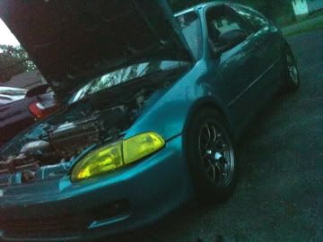

i also like the meaty look Teal, but at Auto X the tires are actually rolling on themselves a little, which brings me to this poll, i already bought tires, 225/45/15 , wider wheels are going help me plant more tread to the ground
already picked the wheels, not so sure about the color.
