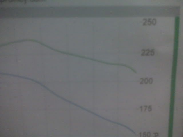

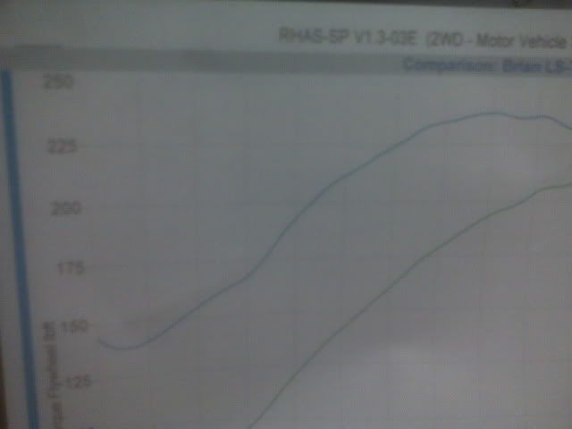

DYNO GRAPH! sorry for shitty quality
torque=blue hp=green
yes, that's max torque (238) @ 4250 rpms :twisted:
hp maxed out 236 @ 6100 rpms

Full boost at 3600rpm?! That's a quick as shit spool up!

he definitely knows what he's doing. spent "2 hours" on the dyno which includes getting all the shit setup.
the graph posted is of a 'high boost' run which is about 5 psi added in with the MBC. we started without the MBC and were consistently hitting close to 195 whp / 210 wtq running on just the wastegate at 5 psi! so he figured out how much to turn the MBC back to run that 'low boost' setting if i'd like. even he was surprised with how rowdy it was!

#240741 195/210 on 5psi is crazy! That twin scroll must be pumping a huge volume of air at that low boost level.
By JUICE
#240793 ^ i know, i still can't believe how much torque it made :twisted:

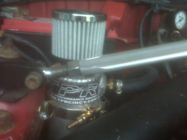

went out and checked over everything, all looks good :D
the new TPR can w/ moroso filter

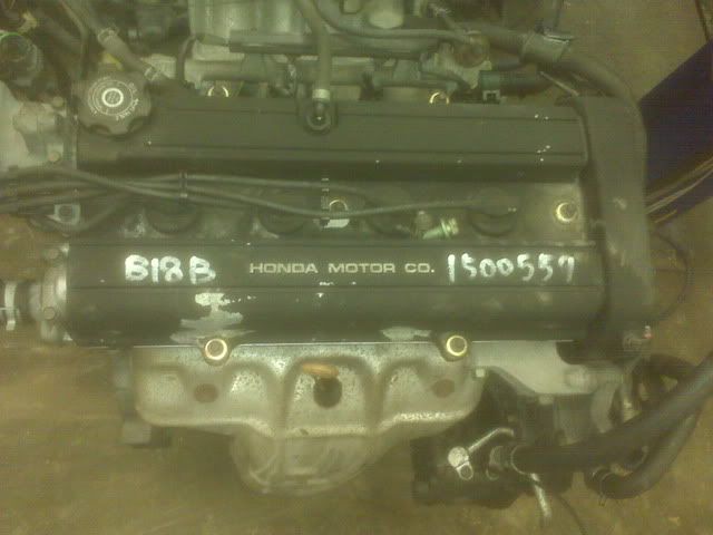

#240958 say hello to my new young japanese mistress 8)
plans..
-Golden Eagle head studs
-OEM head gasket
-PEAK cam gears
-OEM timing belt / water pump
-clean the shit out of it
if the current stays together till next winter.. might do a forged bottom end on it. i will at least take the rods to a machine shop and have ARP hardware installed.
we'll see what happens. backup motors FTW! :lol: :woot:
