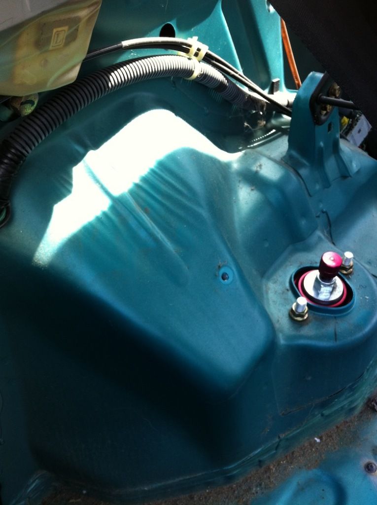

#317144 never seen that before :? but can someone help this man out?
imo it looks like stretches as if someone heated the car.
By jadeydrag0117
#317146
Aldo91 wrote:never seen that before :? but can someone help this man out?
lol. thanks.
i thought it was because i lowered and didn't get strut bars/ towers. :?
cause i also have these near my coilovers under the hood.
#317147 They are stress marks. They aren't uncommon on our cars with such thin metal. If your suspension is low/stiff, that extra force is being absorbed somewhere else. I see them on the front shock towers a lot on slammed civics, especially if they were ever in an accident.
By jadeydrag0117
#317158
teal_dx wrote:They are stress marks. They aren't uncommon on our cars with such thin metal. If your suspension is low/stiff, that extra force is being absorbed somewhere else. I see them on the front shock towers a lot on slammed civics, especially if they were ever in an accident.
so it prob help if i got strut bars huh?
