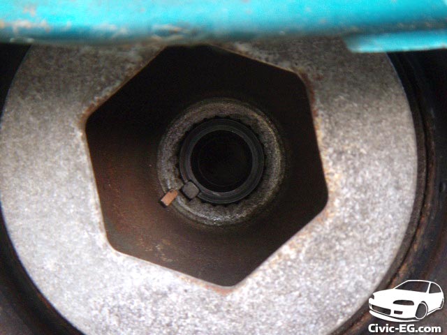

#11528 A while back when I was cleaning the floor, I found this near the front drivers corner of the car.
Right away I was like "I swear I installed the woodruff key on the crank pulley" And I looked... the woodruff key was installed, this was actually smaller, but similar shape. also this is very magnetic.
here it is next to the installed woodruff key.
and here it is on a wheel stud, to give you an idea of how small it is.
I have no clue where it could be from, but I'm pretty sure it fell off my civic at some point.
any ideas :?

#11538 theres a slot when you take off your cam gear on the cam shaft you will see it and it will make sense when you take off the cam gear and look at it
#11543 DONT fire up the motor till you check out the cam situation!!! BAD things could happen!!

AddictiveAllMotor wrote:DONTfire up the motor till you check out the cam situation!!! BAD things could happen!!
X like a billion

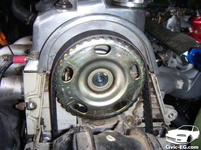

#11566 i dont think that looks like the cam gear key...not really sure what it looks like, are you running adjustable cam gears now?

#11572 take it off and check the resemblence :D
#11578 looks like the cam gear thingy to me... when i re-built my head a month or so ago i dropped mine god knows how many times... took me over an hour to find it one time :eh:
#11587 maybe the DOHC are different, but my SOHC does not have a key like the crank pulley does. It's built in to the cam gear itself, there's no separate piece.
#11588 thats what i was thinking...i really dont know what that goes to man
