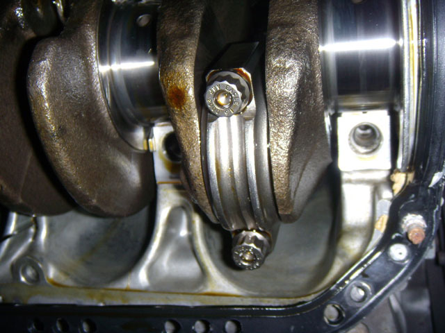

And now on to the rods...
First I took pics of each rod end to look for signs of discoloring due to excessive heat...
rod #1
rod #2
rod #3
rod #4
Look at Rod #2 at the crank... it is a different color than the other pics, and you can see it again in the background of the rod #3 pic. #2 bearing is probably bad and generating a lot of heat, but the rod end looks normal even though the crank looks like it saw some temperatures... Since the rod is not discolored from heat, it looks like the bearing has not spun
rod #1
rod #2
rod #3
rod #4
