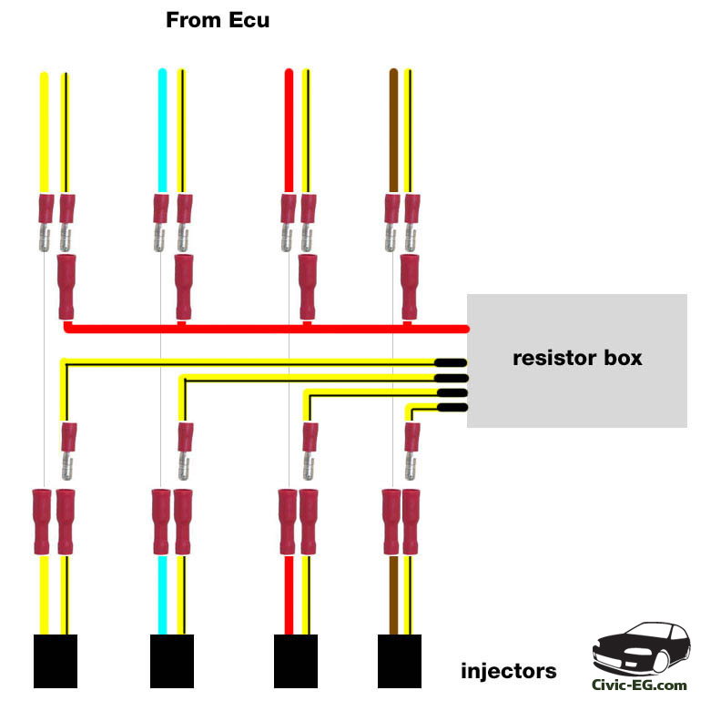

anyone know what kind of work needs to be done to fit them on my car or if they are even possible to use? im using the stock d16z6 fuel rail.
thanks.
wasnt sure which section to post this in but im sure it applies.
