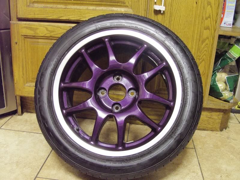

By Robbys89
#249513 the paint should hold better at the edges with the tire off i also did mine by spray gun so the paint was thick compared to the likes of a rattle can job.
heres two pics... when the paint at the edges chipped away i decided to polish the entire edge to save painting over and ruining the rest of the finish on the wheels.

#249517 thats super cool man, especially with the polished lip, im gonna be going the rattle can route as i cant put hammerite into the spray gun, and itll cost me R115.00 a can thats like 10 UK pounds or something, think ill be using a can per wheel to get it as thick as possible but do as many light coats as possible
