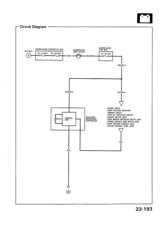

99cx wrote:okay i just ripped out the dash on my car to do some wiring.
has anyone cleaned up the wires back there so that it will be more neat?
has it been done before? or how would i clean this up?
I did on mine when i got the coin pocket.
What I removed was:
The button assembly where the light regulator is
the rear window heater button (because my rear window's heating lines were broken)
I simply just carefully removed them from my harness.
for dash lights i just jumped 2 wires (forgot which ones) - this way the dash light will always be on full.
The coin pocket replaced that 3-button assembly.
I then used one of the block-off buttons and placed it instead of the window heater switch. im liking it so far.
As for cleanliness - doesnt matter, unless you are running no-dash setup.
other than that you could remove the a/c wires and radio harness, but other than that you cant remove anything else.
