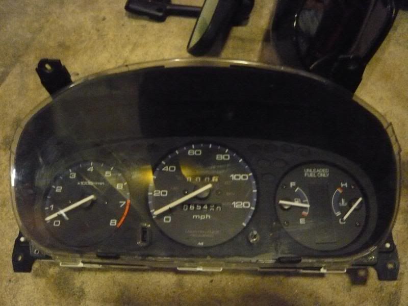

#177666 i was wondering if a auto trans cluster with tac still work on mine stick car if not can i use the speedo out of it cause my speedo doesn't work thanks
By DontHateonEG8
#177667 yeah you can use it without a problem
the PRNDL feature has a separate plug. so the cluster will work on your stick shift car and the only problem is that you will have those annoying PRNDL images and people will think you are rocking an auto :lol: :lol:
By EG95CIVIC
#177668 ok thanks i don't care about that i just need to see how fast im going cause it sucks not seeing that
By suspendedHatch
#177759 That's an EK cluster.
Just swap the speedo. I hope you got a cluster with close to the same mileage as your car. If it's less, then it's going to forever stain your title the next time you register the car.
