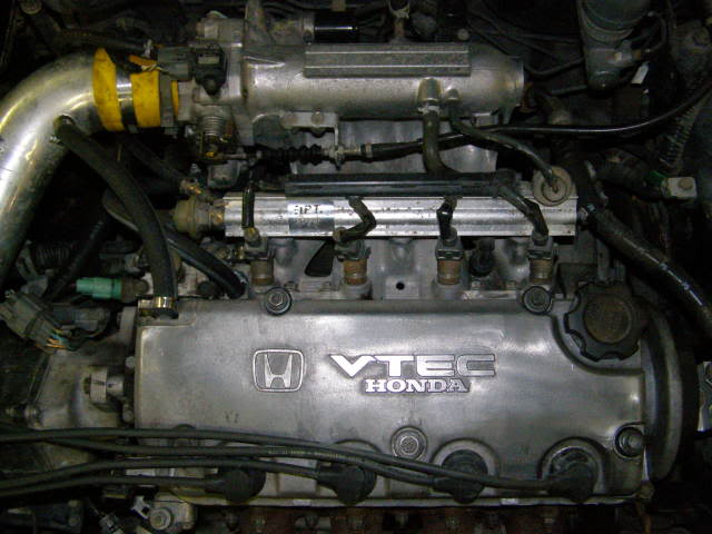

HOW TO INSTALL A PCV ON A Z6
THIS IS A EASY INSTALL 5 MIN AT MOST
TOOLS PLIERS
SHOT OF TOP OF ENGINE
LOSSEN CLAP GOING INTO INTAKE
PULL HOSE OFF
CLOSE UP OF PCV
LIFT UP AND PULL OUT
NEW(BLUE) AND OLD(NASTY) PCV
REVERSE TO PUT BACK TOGETHER
NEW PCV INSTALLED
I KNOW IT IS AN EASY INSTALL
BUT SOME PEOPLE MAY FIND THIS HELPFUL
