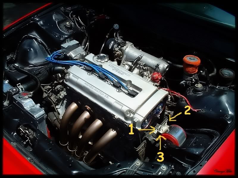

#110307 Well, if it has mounting point like the del Sol Vtec models, it's a 2 bolt design.
like this
But it really is all determined by this...
The part circled in red is bolted to the BLOCK directly. It will either have 2 studs in it and a threaded hole. Or it will ONLY have 2 studs coming from it. The one shown above is from a del sol b16a3. It only has 2 studs as you can see. Here is an example of a 3 bolt. You'll see how one is actually a bolt that screws into the block mount(see above picture with red circle).
If you need anymore help just LMK.

Thank you. And no, you will not be able to use the one from your DA. The mounts themselves are different sizes. I would just wait till you get the motor. Then go to your closest parts store and get the one you need. They usually keep them in stock and ready to go... Just another option.

#111156 Turned out its a second gen b16a, with a 2 hole design.... stock civic d series mounts worked
