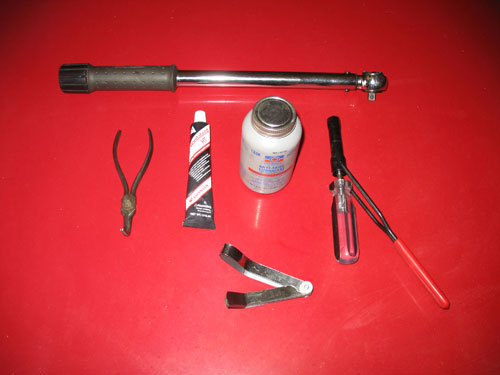

Tools and Supplies
Valve Cover Gasket Kit
Honda Bond (pref'd)
Anti-seize (copper pref'd)
10mm Jam Nut Tool Alltrade/Powerbuilt 648827 $13 Amazon
Feeler Gauges .006, .007, .008 inch Craftsman Part No. 40802 $10 Sears
Ratchet
10, 12, 19mm Sockets
16mm Spark Plug Socket
Long Extension
Jack
Jack Stand
Wheel Chock
Torque Wrench capable of 7 to 80ft/lbs
Needle Nose Pliers (bent pref'd)
