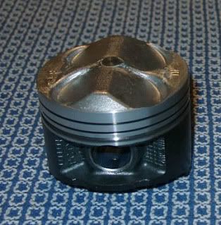

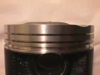

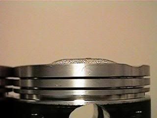

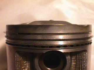

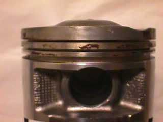

#229676 ok so i trying to figure something out. i read online that the itr, ctr, and b16a share the same heads and that they are stamped pr3 can anyone confirm this. i know the difference from the itr, ctr from the b16a is a hand port job from honda.
now the other problem is trying to figure out the combustion chamber ratio on all 3 motors. if they all have the same cylinderhead then why is it that the ctr has a lower compression then the itr.
for an example
ctr pistons in a b16a will yeild 11.1 ish. but ctr piston in a b16b has a 10.8
it should be the same if i put ctr pistons in my b16a if they got the same heads also usdm itr pistons in a b16a will yeild 10.4 ish but they got a lower dome then the p30 b16a pistons.
the usdm b16a pr3 has a compression of 10.2
jdm b16a p30 has 10.4
usdm itr p73-a0 has 10.6
jdm itr p73-00 has 11.1
ctr pct has 10.8
Image usdm 99-00 or jdm 88-91 b16a piston
Image jdm b16a piston
Image usdm itr piston
Image jdm itr piston
Image ctr piston
#229731 yes, they all have the same head. each one has a completely different piston though. the reason the ctr doest share the same cr as a b16a is because it has the taller deck hieght of the itr/gsr block. for the compression ratio for each piston in a different motor you need to take into account the compression hieght of the piston. which is where the piston pin is on the piston. each one is different. the head alone doesnt define the cr in a motor. you have to factor in the bore, rod length, compression hieght and hg thickness along with the cc of the piston and head.
#229733 ctr pistons in a b16a equals a 11.9:1 not 11.1:1
ctr in a itr equals 12.73:1
