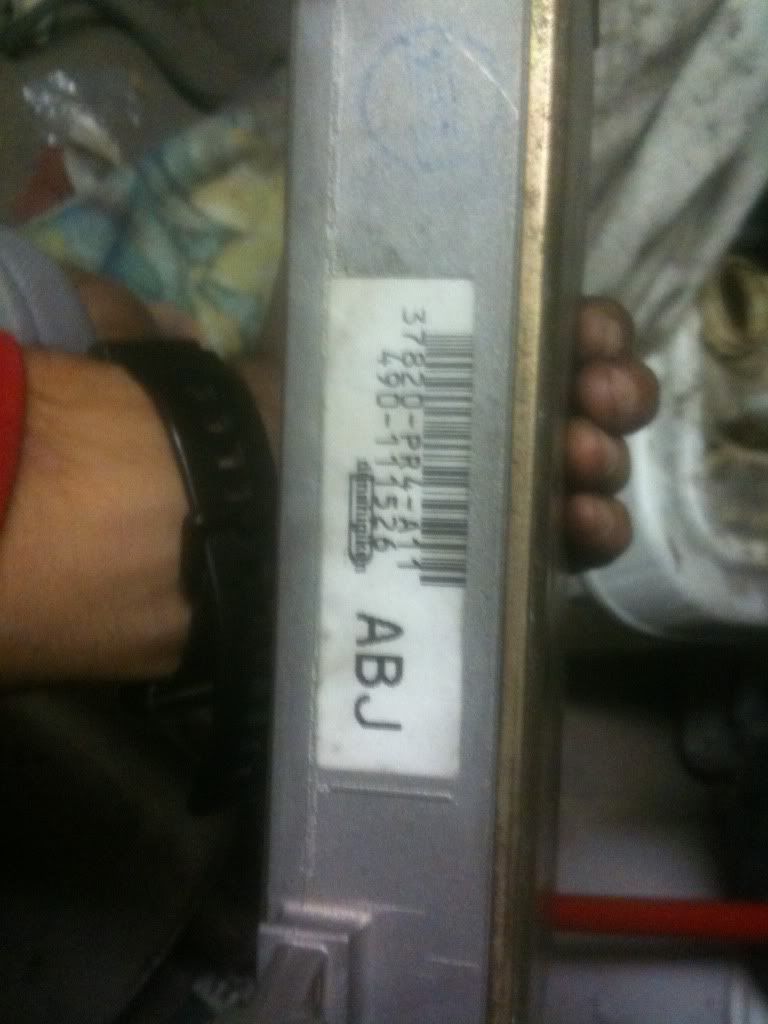

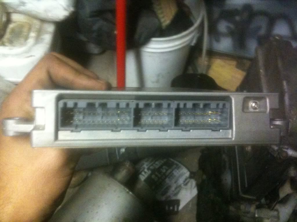

This is the ecu i got so it's 0bd1 rite???? Image an is there anyone who has swapped this into there car do you really have to convert it
#219673 Whats the number on the side of the ecu? I swapped in an OBD1 LS, not a obd0.

Greasedmonkey wrote:Whats the number on the side of the ecu? I swapped in an OBD1 LS, not a obd0.

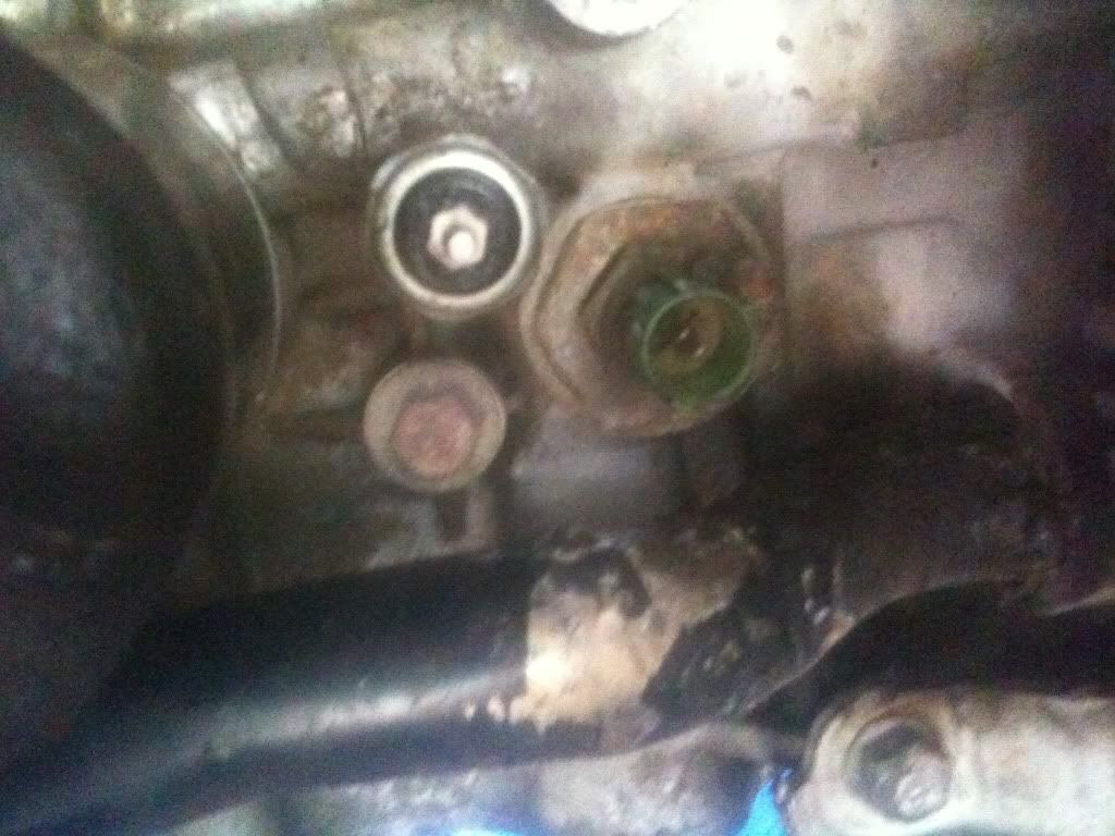

Image phone pic kinda blurry ... Does anyone know what harmonic balencers will fit my engine it is missing one
#219813 Does indeed look like a OBD1 ecu. The motor still has an OBD0 intake manifold on it though. Take a picture of the block, dizzy plugs and thremostate housing.

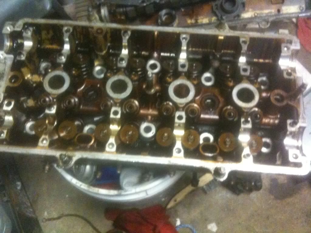

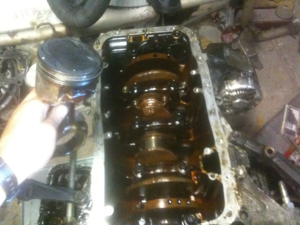

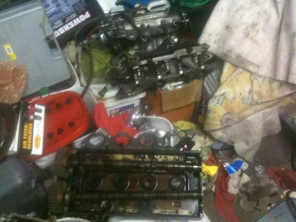

#219834 Started takin apart engine to replace gaskets an shit basically tune up
Mani valve cover cams
The head
Camshaft and piston

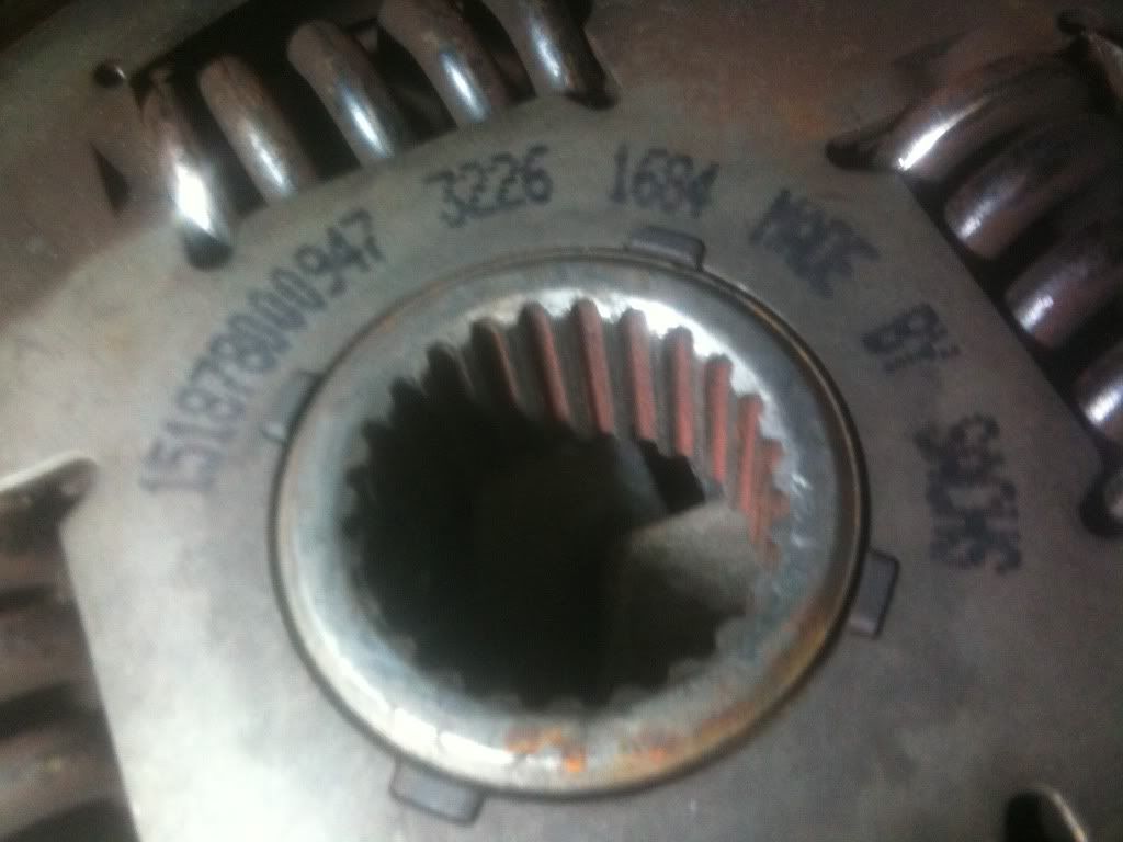

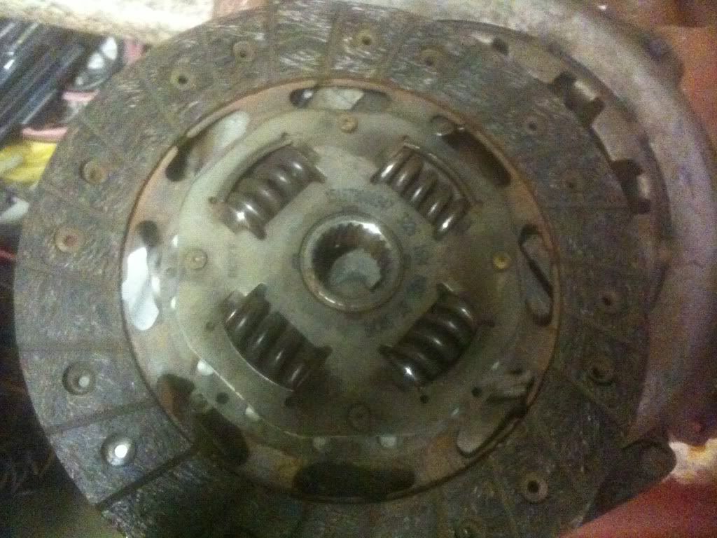

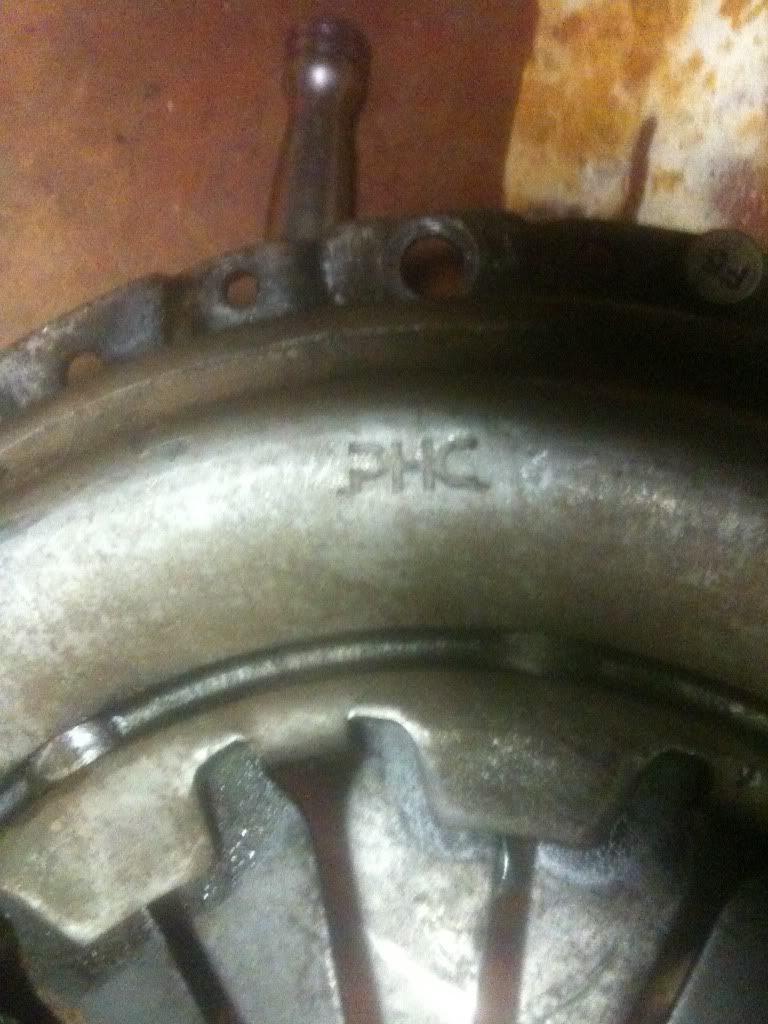

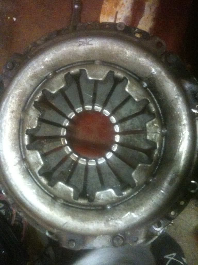

Pressure plate anyone heard of this brand is it good? Or stock???

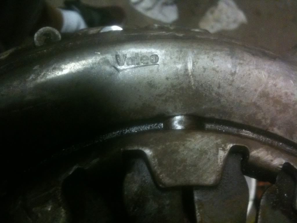

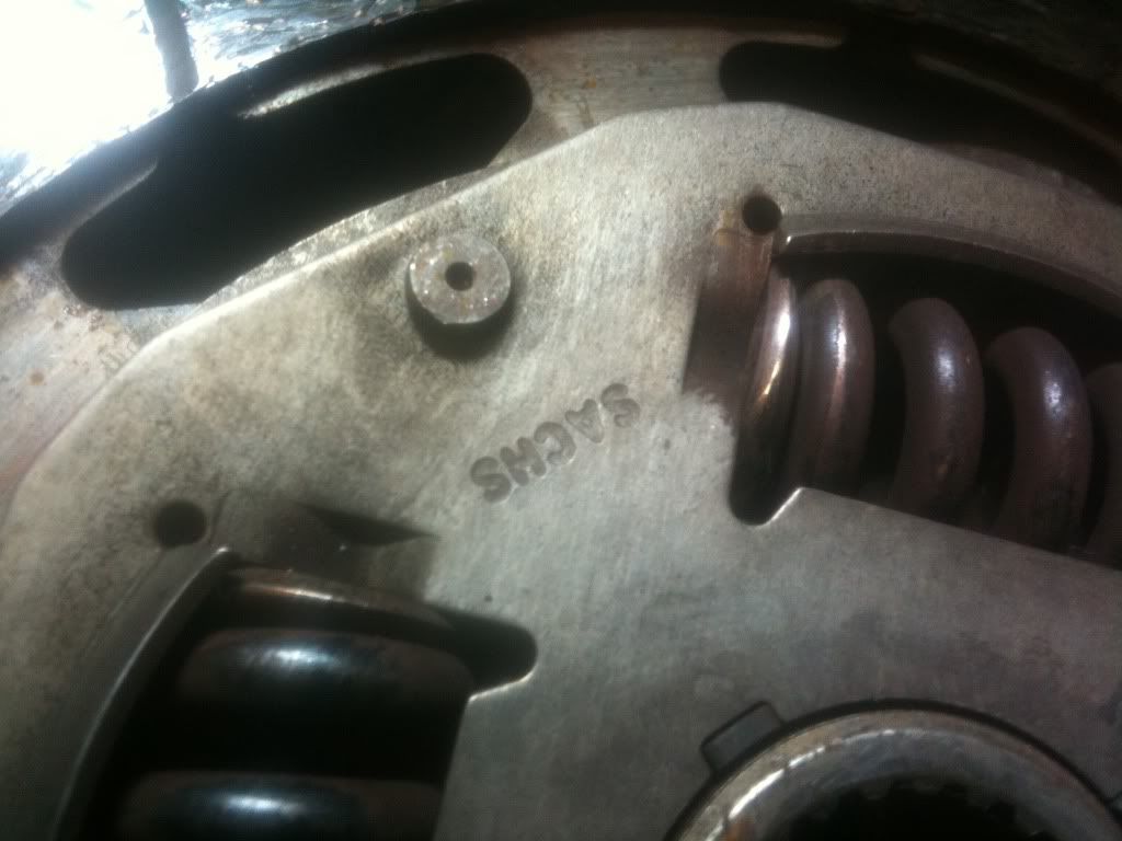

Clutch anyone heard of this brand is this any good all help wanted thanks

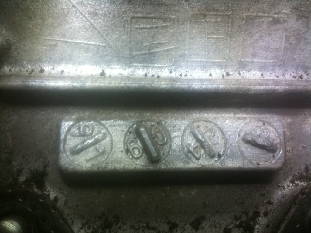

Image pic of numbers on the head

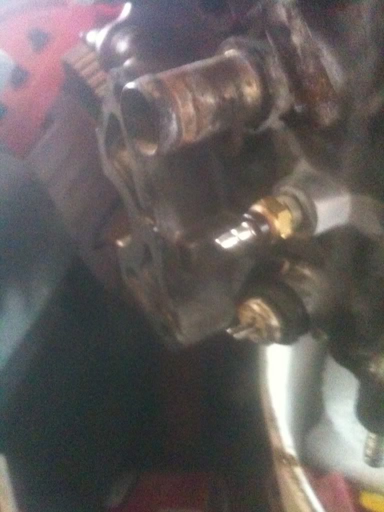

Plugs on head
Plugs on block some one let me know if this is a b18a1 from 90-91 (obd0) or 92-93(obd1)
By That One Dude
#219981 Looks like an OBD-0 block ot me. But I'm not a full on expert of sorts.
And that clutch is eitheran AutoZone or O'Rielly's special. It's comparable to stock, but it won't last worth a shit. Go OEM or high end aftermarket.
#220019 The casting on the head seems to place it as a 91 or a 92. Depending on the month it was made. Which puts it as a obd0 or 1. The plugs dont look familiar. What is the casting number on the pistons?
Thats a sachs brand clutch. decent, but not great.
