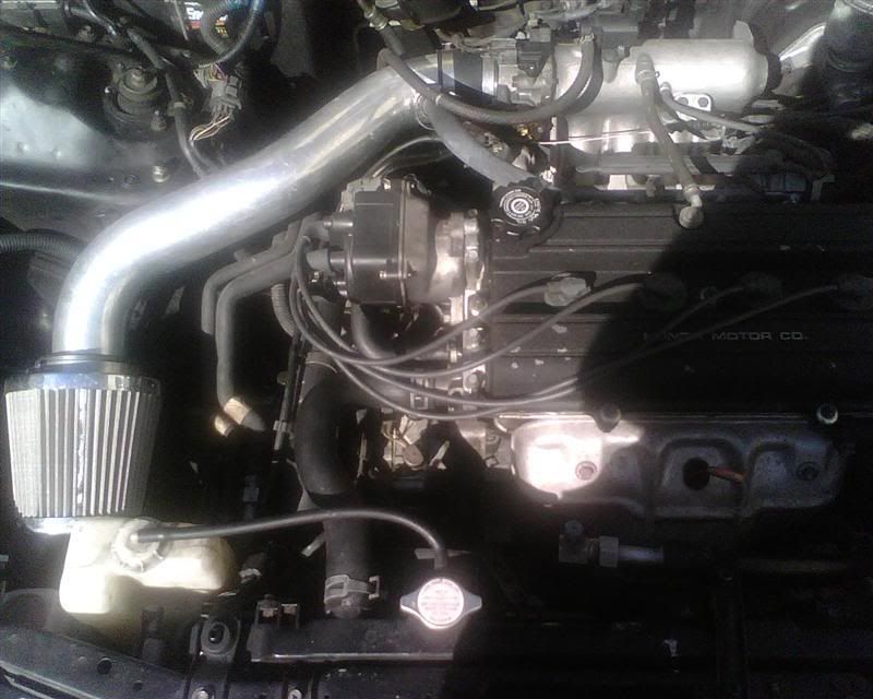

#89351 I Have this b18b on my car, and i came to see some oil today
around (under) the distrib. i was trying to find out the spot
but i couldnt, so right now im wondering if it's the head gasket
or the distrib., so i would appreciate if somebody would
tell me any ideas or has seen this before.
My plan for now is to wash all that stuff with degrease, run the car for a couple of miles and check for the spot. :?
this is the actual motor
#89367 under the Distributor would make it the Distributor O ring.
