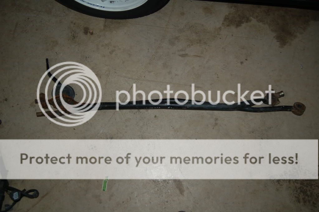

Bought a set of blackworks lower control arms, to replace the worn out ones
