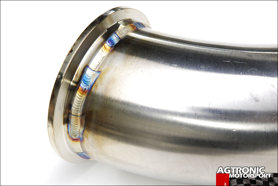

#97300 not the prettiest welds, but definitely the sexiest designs :thumb:
#97477 ROFL, busted.
Nice designe man, look forward to the other side being done.
By Faded_Milano
#97576 by, not the prettiest, I meant just that. Don't get me wrong, They're great looking welds. But these are the prettiest
By ee8
#97656
Faded_Milano wrote:by, not the prettiest, I meant just that. Don't get me wrong, They're great looking welds. But these are the prettiest
i know, no worries :D
those are tig welds, you cant compare that to mig.....
