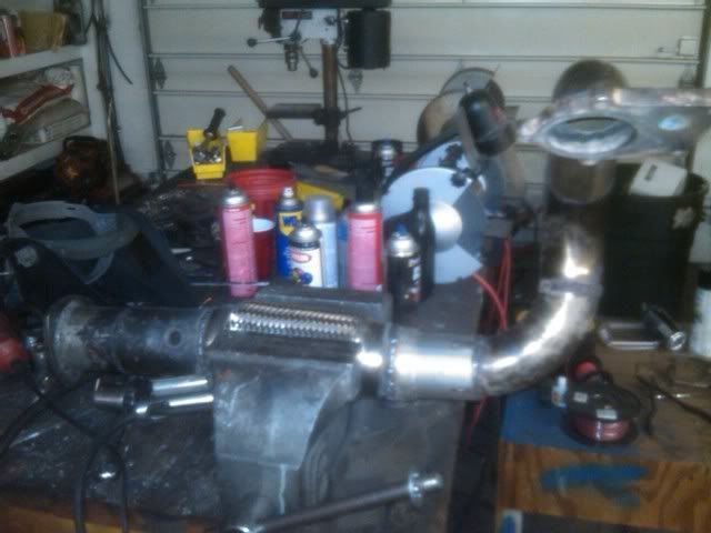

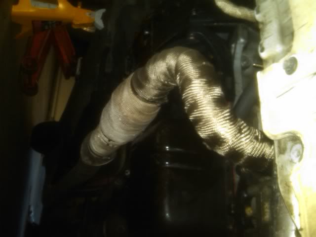

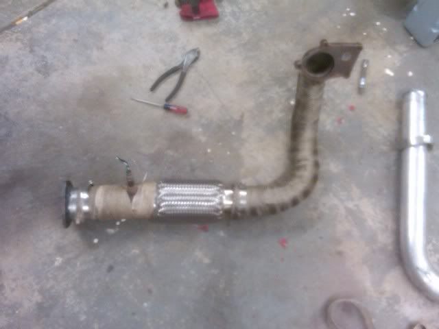

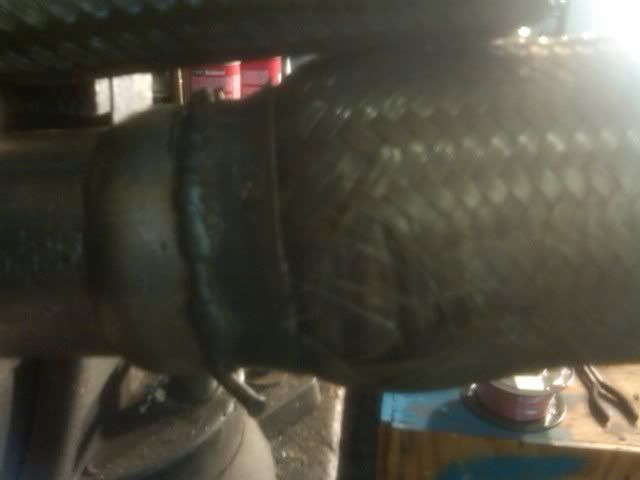

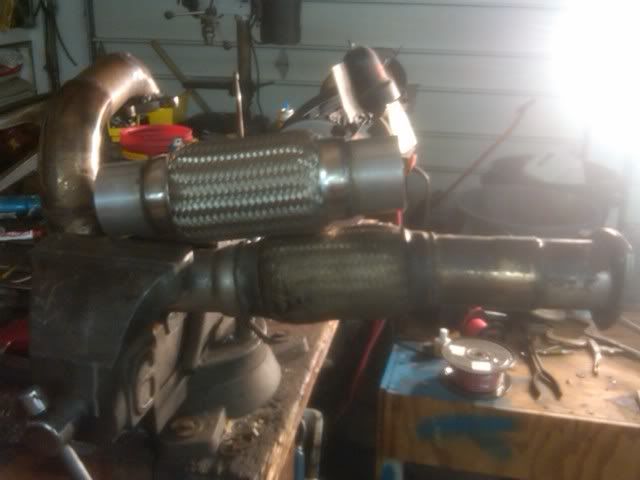

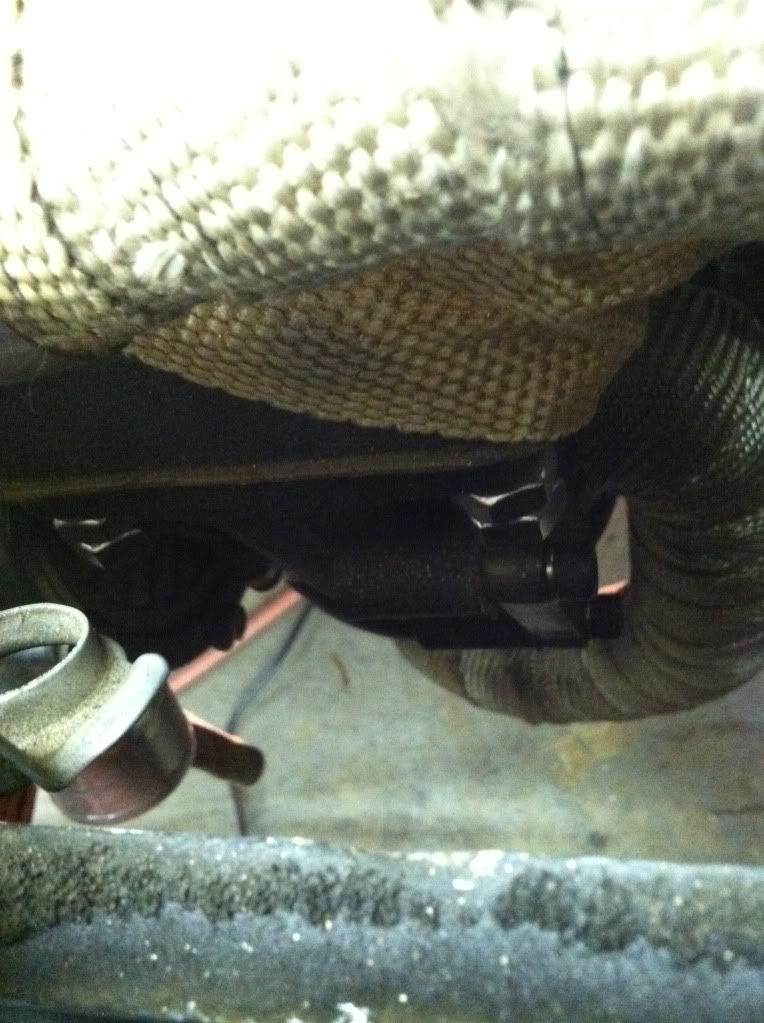

here was some in process of me fixing/dropping my dp to replace my flex section...
so i got her all wrapped up and used some CARBON exhaust wrap

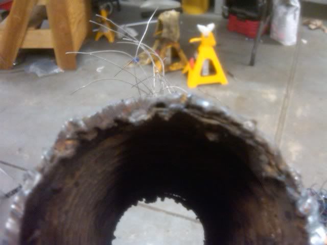

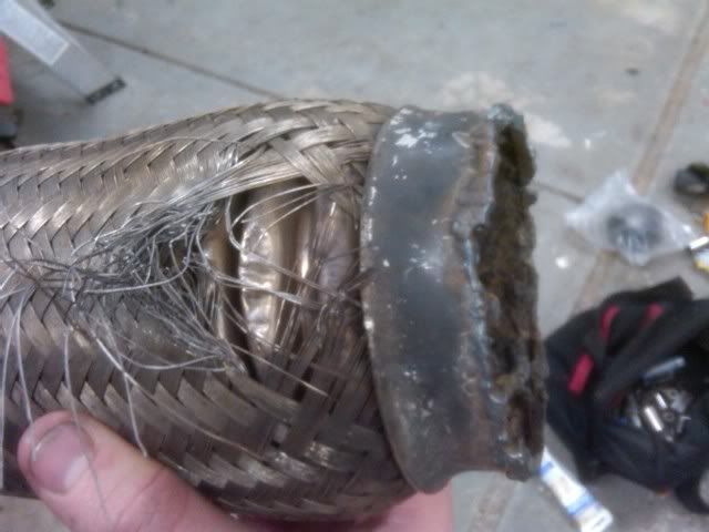

here is some pics of the busted piece..

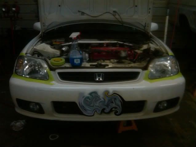

here was another whim i had.. to polish my headlights cause they were starting to fog because of the weather.
used this stuff:
taped off:
came out really well! was so much more clear... i did it because i was prepping for ....

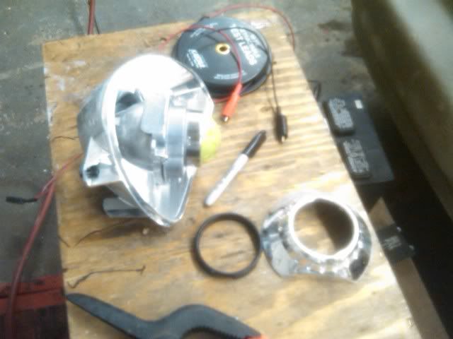

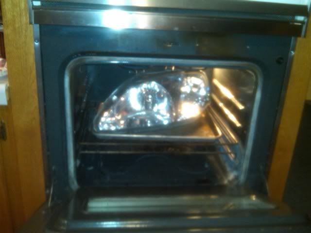

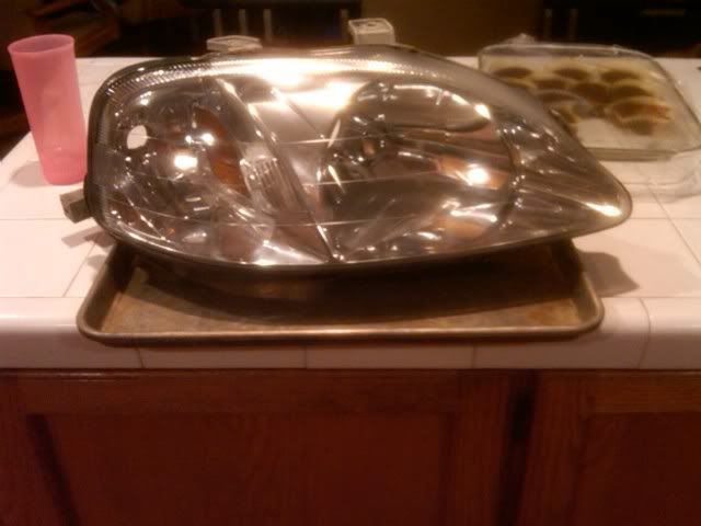

#249626 took out my headlights:
oven tray.. :lol:
yumm... it's what for dinner
broke them apart after 7 minutes in the oven...

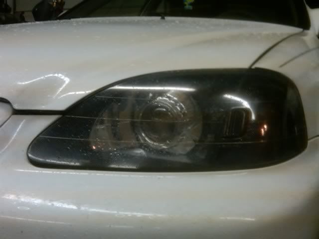

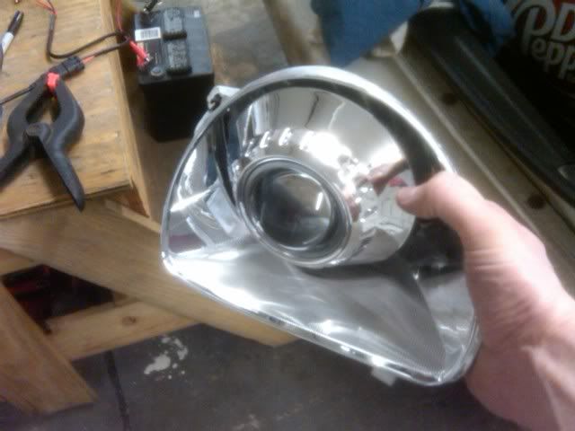

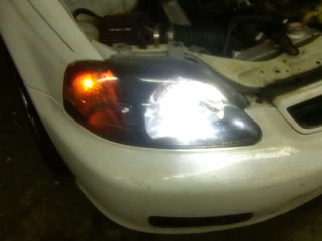

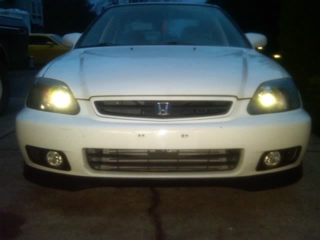

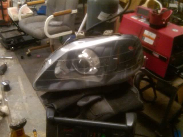

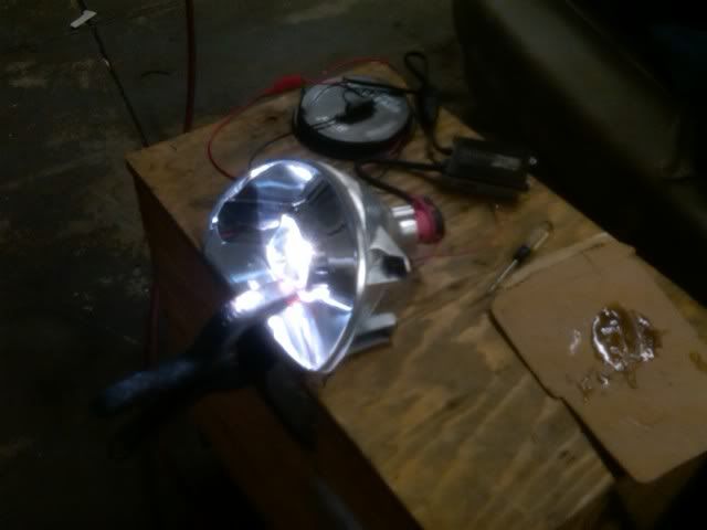

so i got a NICE package from retrofitsource.com and got the FX-R stage 3 kit... 4300K bulbs, morimoto ballasts, awesome!
here is the retrofit process....

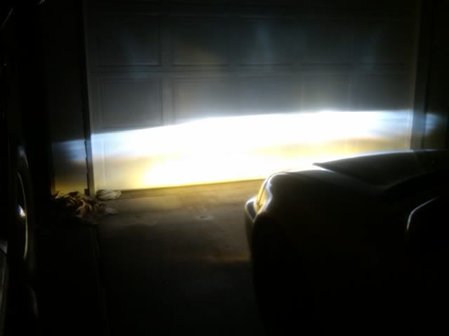

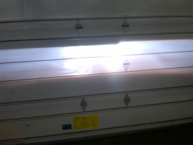

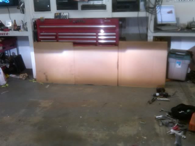

this is the cutoff line which makes it where you don't blind others and this is the point where you have to match up the cutoff line of the new projector to the halogen old cutoff

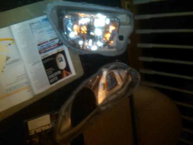

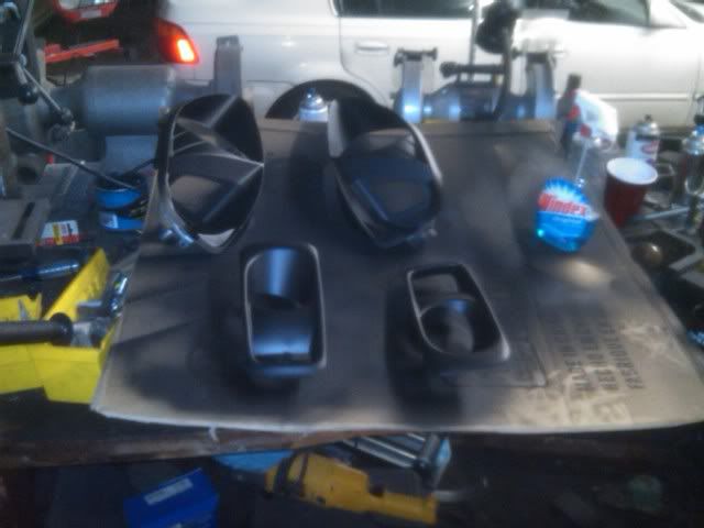

i painted the inside crome pieces and my fog light housing low-gloss black

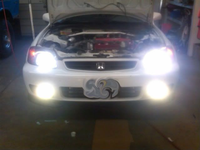

so here is a rough view of finished ...
got them installed...
here is a shot with the fogs... they rock!!!! love having 4 HID's
8)

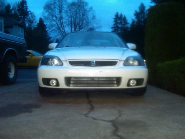

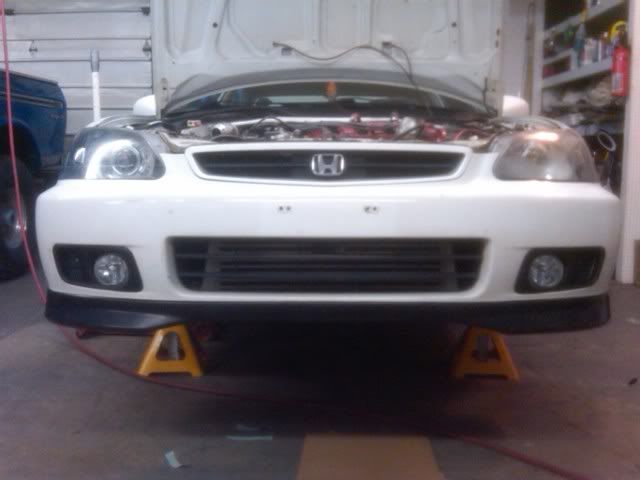

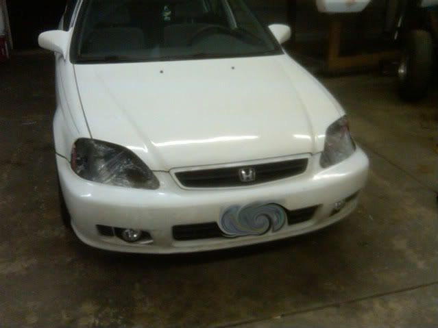

#249629 so today (Sunday) i took some time to install my front lip...wrap the rest of my DP and some minor things...
here is another pic of my headlight, turned on:
all 4 lit up...
here is the lip installed:
outside...kinda dark tho
annnnnd here is my DP that has been getting a lot of action lately...sadly :lol:
sooo question????
what should i do about the color of the lip? should i paint it white with the bumper so they will be the same color? i kind of like how it accents the fog housings, headlight housings and wheels.. what do y'all think?

#249635 i say leave it black it matches the grill and fogs nicely. great retro fit btw i would love to have tsx projectors and ballasts my self.
#250088 i love the hid retrofit, thats awesome.
The black lip seams to fit up front, however if its white it will make your car look lower. I like them both ways. If it was my car it would go white though.
I love how the car keeps progressing. It looks good. :thumb:

#252777
Apexracing wrote:i say leave it black it matches the grill and fogs nicely. great retro fit btw i would love to have tsx projectors and ballasts my self.
thanks man, the retrofit was kind of a bitch only because i had to go back and open the driver's headlight because it wasn't level, it was rotated off like 5 degrees or so.
you might want to look at the setup i have, it's a bi-xenon as i believe the tsx projectors are only low beam? might want to look into that, the high beams on these things are amazing! :thumb:

i'm thinking that it looks good being black but my whole bumper needs to be re-sprayed so i don't quite know, i like the black and white theme i have going on...

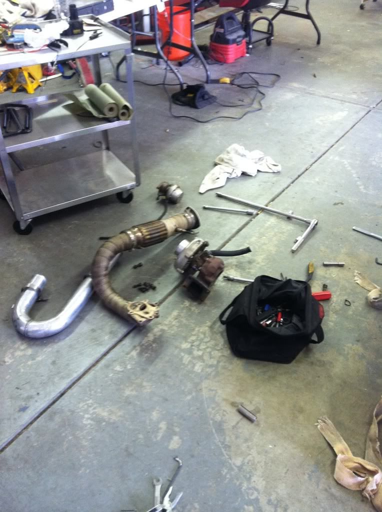

so after i got back i tore everything apart .. AGAIN

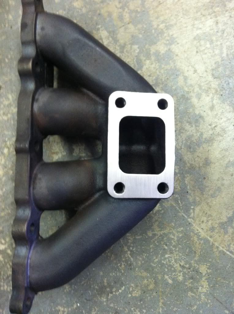

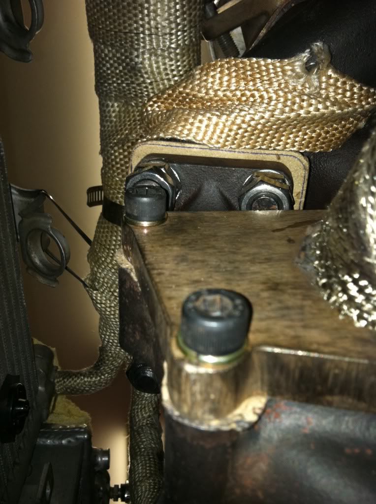

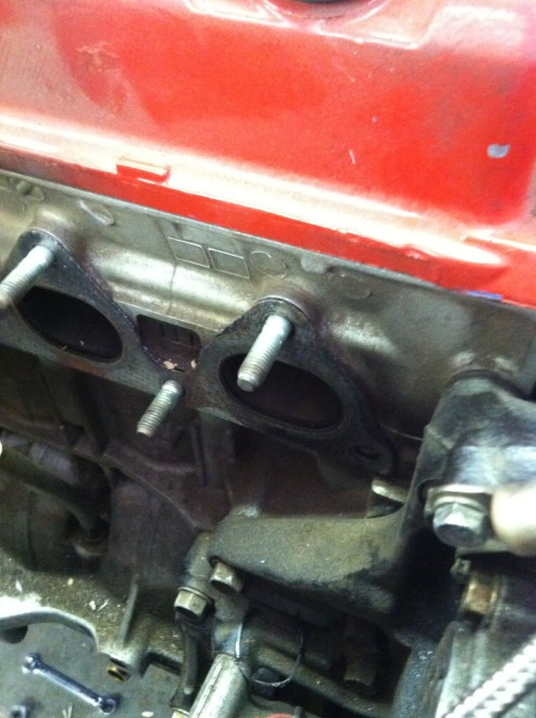

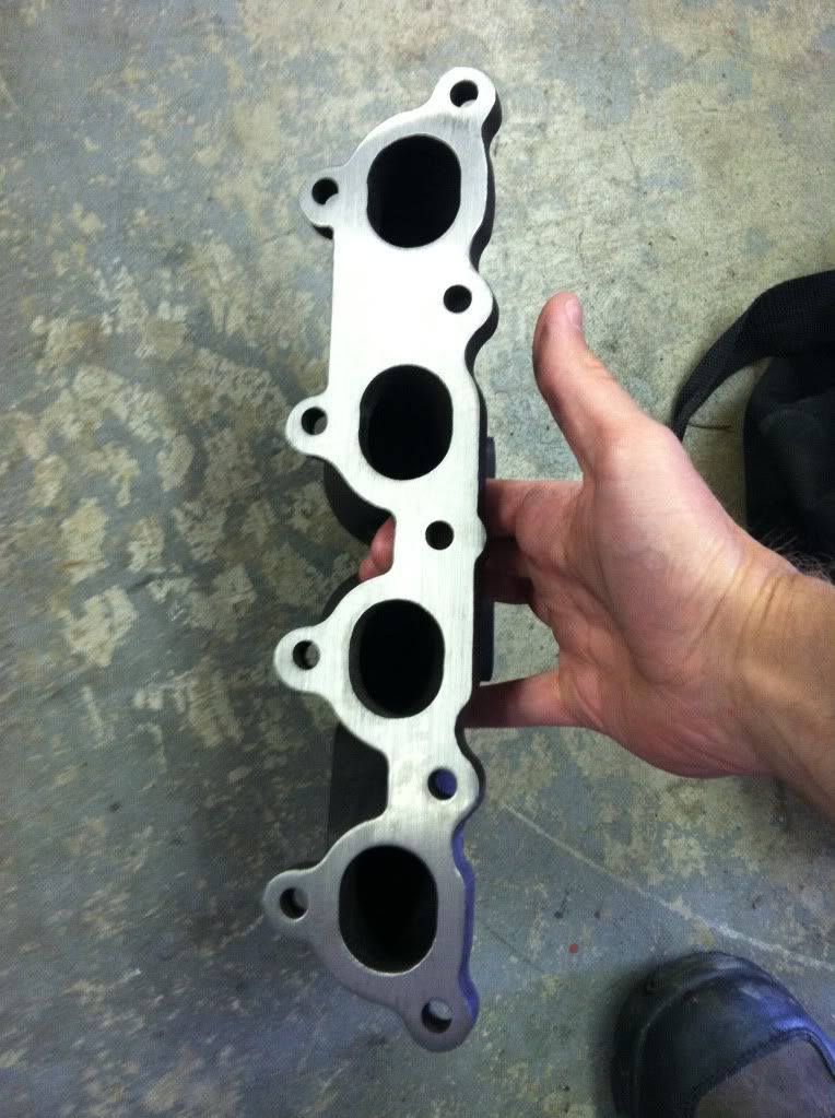

noticed i had a pretty big leak where the manifold meets the cylinder head:

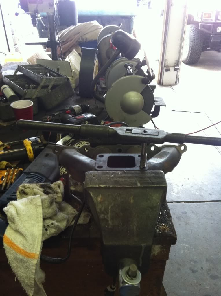

so since i stripped one of the 4 bolts on the 4 bolt turbo flange i re drilled and tapped the holes to 1/2-13 UNC thread so my options for fastening would be greater.
as a person suggested, i got the cast manifold machined at a local shop:

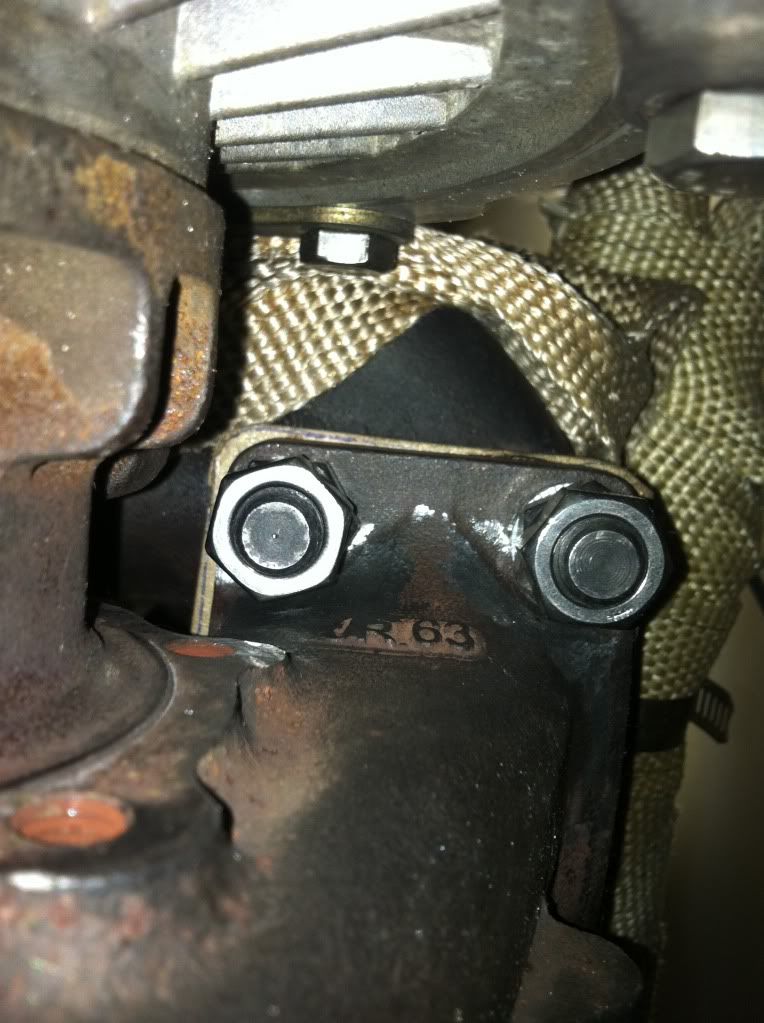

--> so i went to the hardware store and got some 1/2" studs, stainless jam nuts and washers, however, i had to re-drill the turbine housing and grind a significant portion of turbine away to accomodate these large ass nuts.

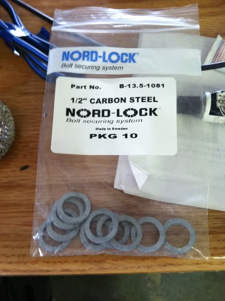

ANNND i got these badass washers from mcmaster-carr...
i watched this video:
http://www.youtube.com/watch?v=mgwmuZuJ02I
they work great so far.. about 2 weeks of heat cycles...

#259639 As you can, i have my double JAM nuts and sweet ass washers:
can see where i ground the housing to be able to get a wrench on it:

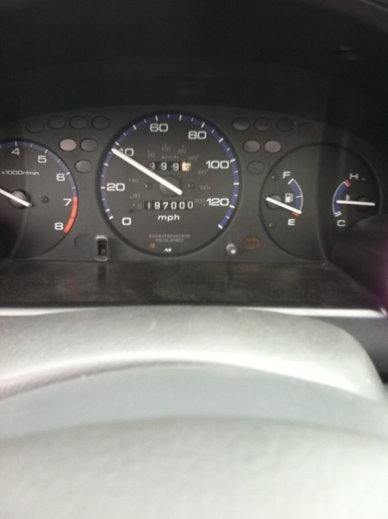

i Drive the Shit out of this thing.. getting close to 200k! :TU:
so that's about all i have done in the last 2 months.. just driving it about 60 miles a day

#259704 Nice update. Manifold leaks are never good, getting it machined was the correct call sir. Glad every thing fixed up nicely.
#259765 Sorry to hear about it coming undone on you. Especally on the way home.
I'm happy to see it put all back together. I like the double nuts on the manifold. Its not coming loose agian. :thumb:

Apexracing wrote:Nice update. Manifold leaks are never good, getting it machined was the correct call sir. Glad every thing fixed up nicely.
yeah thanks man.. i think it was a good call, i think i have a pinhole leak or something somewhere in the piping because it smells in the car at stop lights so i gotta trace that one down, rotate my tyres and i'm getting new front brakes :thumb:
chrono404 wrote:Sorry to hear about it coming undone on you. Especally on the way home.
yeah it was pretty lame, but these nord-lock washers really seem to be doing the trick and i use the double nuts as sort of a visual indication too... how has the sol been doing?
