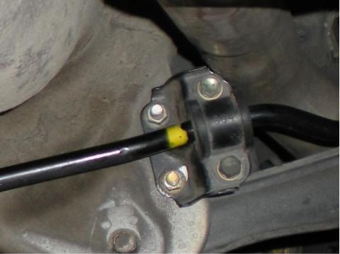

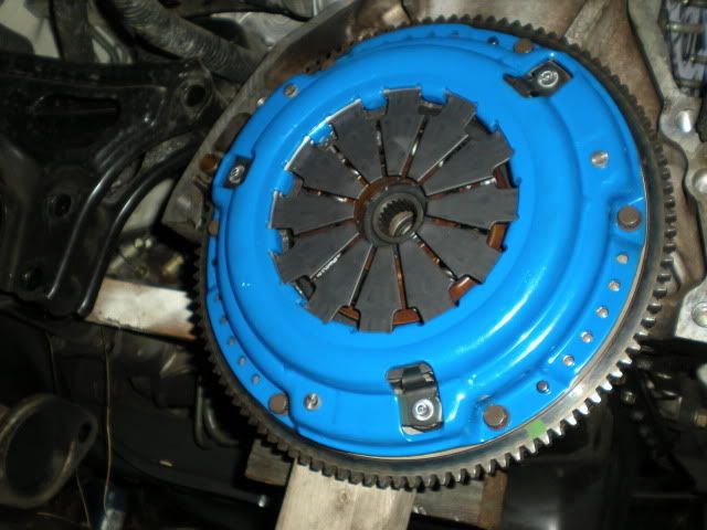

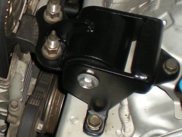

ok, well since then i have...
installed an em1 rear sway
it hit my exhaust pipe so i 'clarenced' it
replaced my clutch

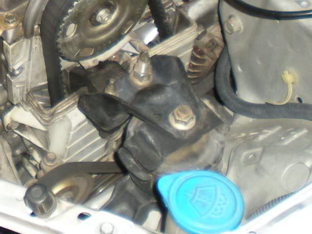

replaced the ghey 6th gen motor mounts

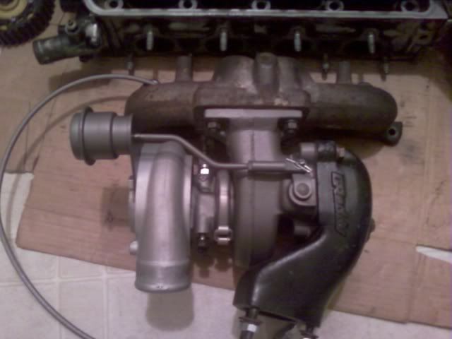

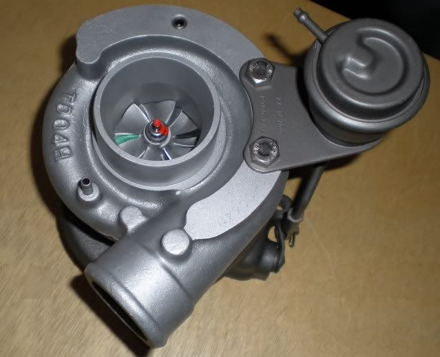

got my teency turbo rebuilt

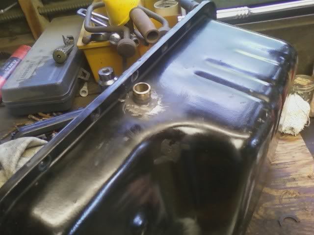

tapped my oil pan with jb weld and a garden hose fitting

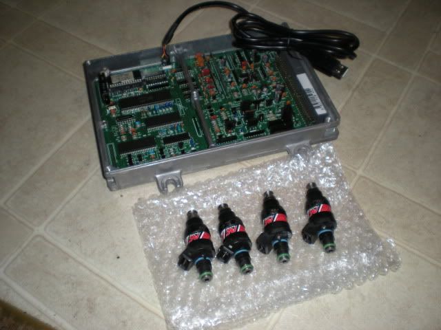

chipped my ecu

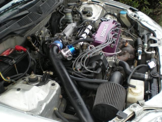

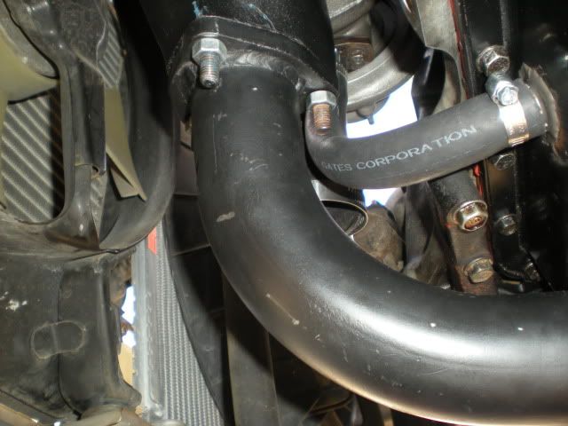

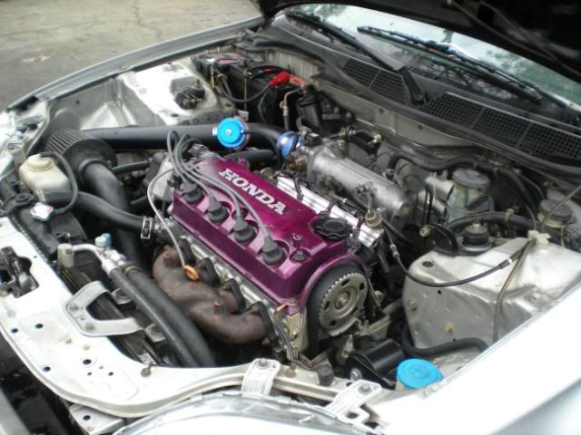

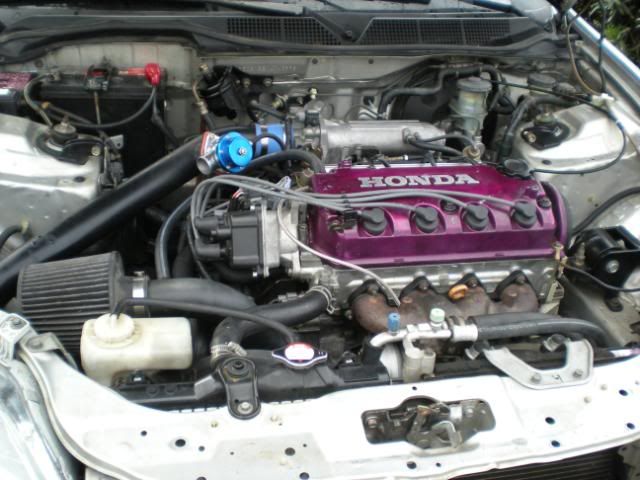

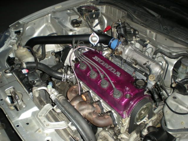

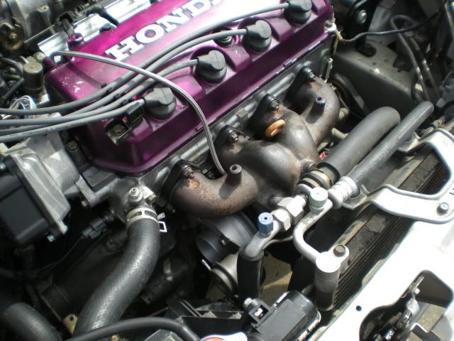

#246264 presently, i am installing my bastard greddy 15g kit
headstuds were installed when motor was in my old car
oil return line clears the downpipe
keeping the ac until summer ends
ic and piping fit now (sort of). it fit really well on my ej1, not greddy's fault
it gets dark early and has been raining so not so many pics. maybe this weekend...

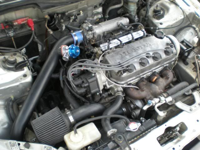

#246619 some more pictures

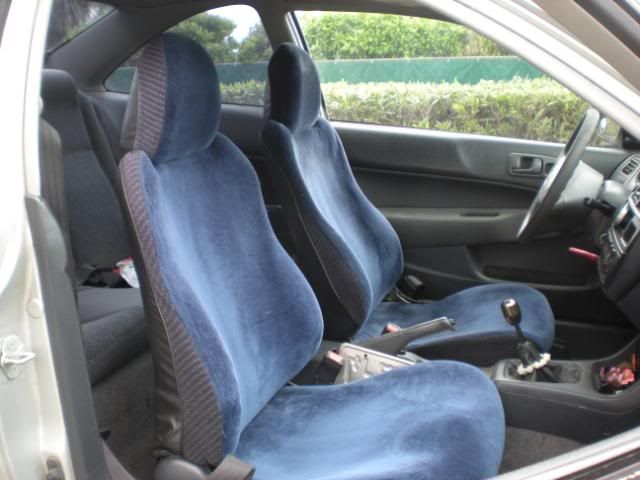

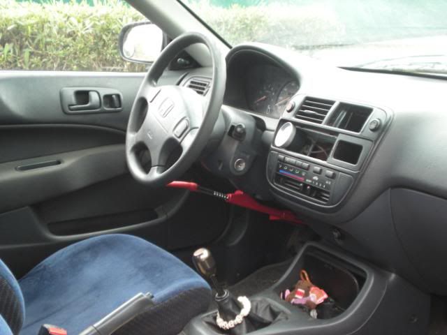

#246663 i love everything about your car. do you like the interior a lot more than the eg's? i cant stand the eg's cupholder. haha

#246726
94_jdm_ferio wrote:is she running yet?
idles good, no cels, no leaks but won't rev at all
have to look at my basemap.
i was hoping to get it tuned sometime this week, we'll see how that goes.
dbrooks wrote:i love everything about your car. do you like the interior a lot more than the eg's? i cant stand the eg's cupholder. haha
thank you sir.
i think so, my interior is stock, except for del sol seats.
ek seats are way to high for me, so are eg seats.
eg cupholders break very easily.
egs are easier to work on, ek's have minor differences that sometimes become a huge pain when you have to deal with them.

#247503
94_jdm_ferio wrote:wow that sucks
when you gettin it tuned?
hopefully tomorrow it will be tuned.
turbo started leaking oil, so i had to take the whole thing apart and tighten up some bolts holding it together.
put it back together, got a good basemap, she runs real smooth up to 5k.
i didn't want to beat on it with just a basemap.
damn, it was hot today
i have to raise the front so it i don't knock the intercooler off :shock:

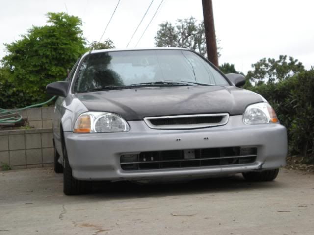

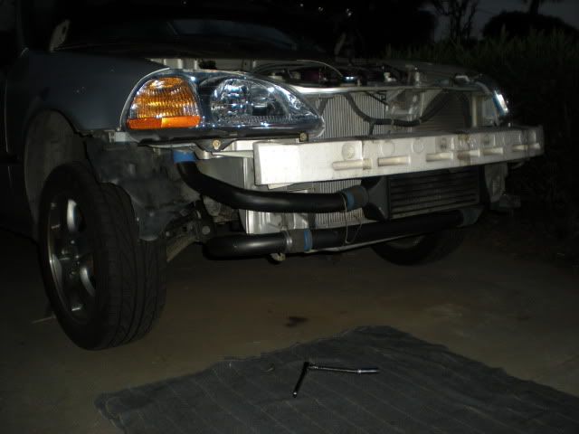

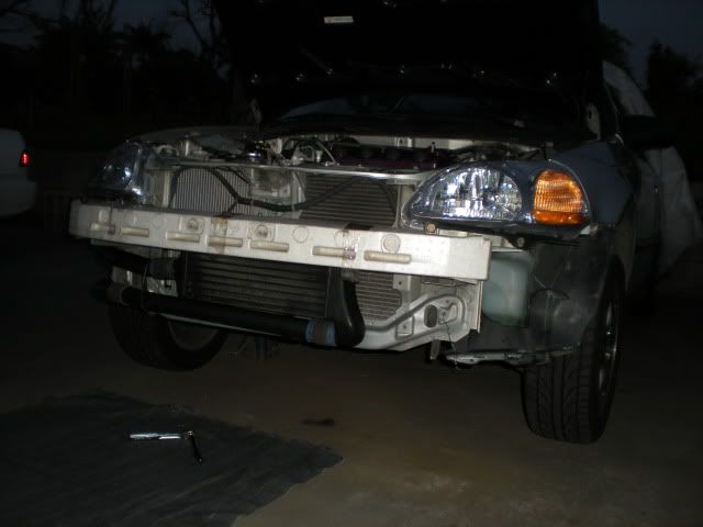

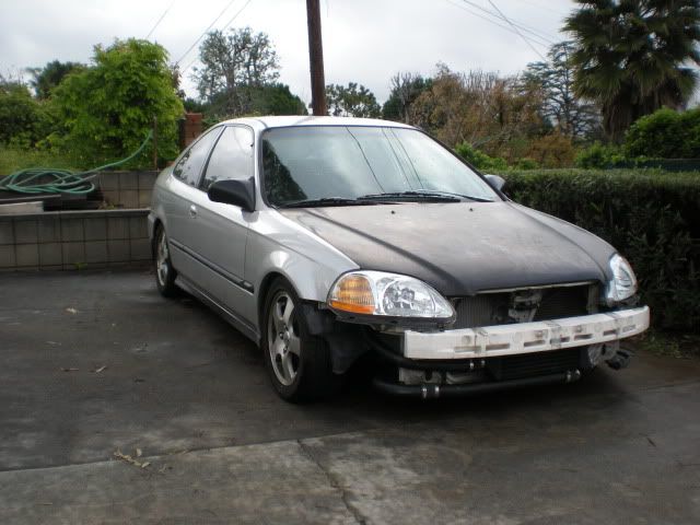

#248104 i cut my bumper to fit the intercooler, it came out pretty well
another look
inside
intercooler? what intercooler?
still haven't gotten it tuned, this week is my girl's birthday and i still have to do my taxes
