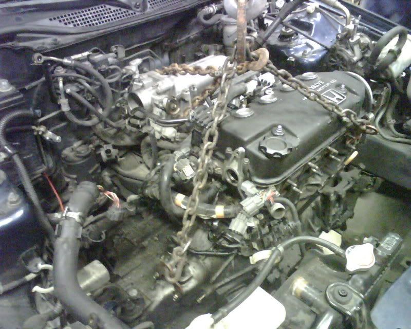

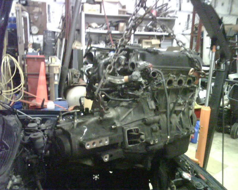

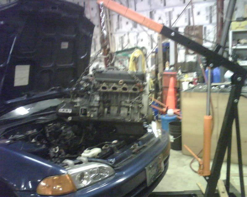

Started Work Wed, Pulled the Engine out.

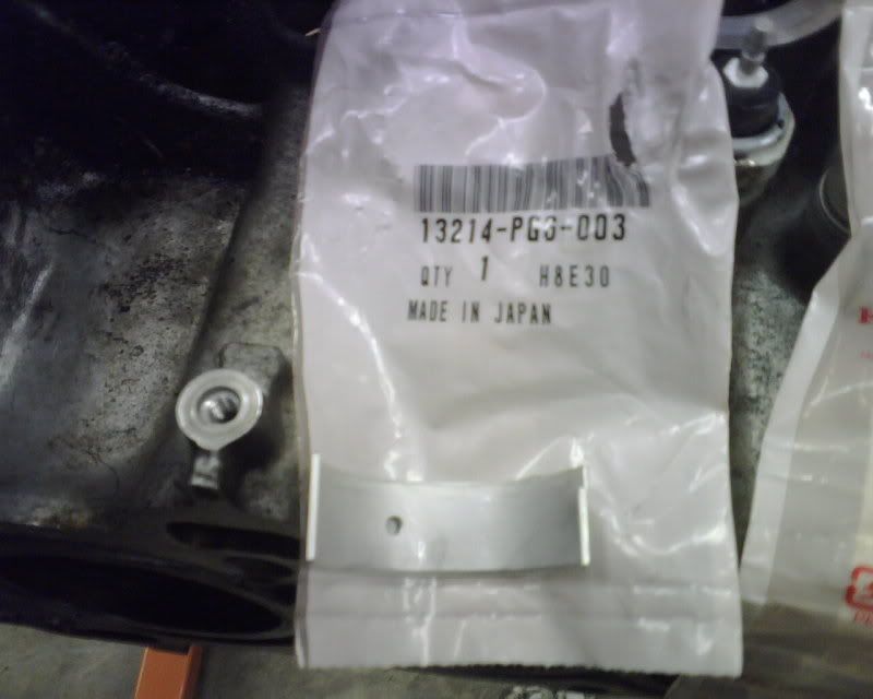

After that we set the Engine down and started taking things I needed off it off and put them on my z6. When we got to putting on the flywheel we noticed it was to easy to put the bolts on, no matter how hard we turned the engine it wouldn't go. Thinking the engine might have had moisture get it in the cylinders and rust we took the head off and found nice clean cylinder walls and pistons,

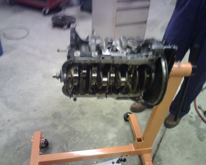

So the block got flipped over and we took the pan off, The pan was held on by some sort of glue, Deffinetly not OEM, Once we got in and took the oil pump scoop out and the bottom brace, we saw engine builder greese everywhere, so we loosened the rod caps, looked at everything and retighted them to spec. Cylinders 1,2,and 4 all have the right bearing and are at spec torque atm. However cylinder 3 has the wrong bearings. Atleast I found out why the engine was seized.

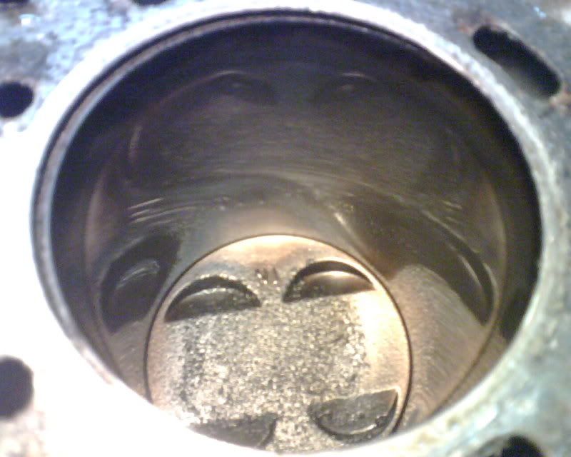

Cylinder walls look really shiney, There is no scoring on them at all, no signs of any ring troubles.

The rod bearings for cylinder #3 are the wrong size, which is why the engine was seized when I picked it up.
I will be measuring what I need and getting bearings soon, I will be rebuilding the z6.I dont want to just cop out and put together a Minime, They are functional, However the z6 was built to run upto 7500rpms, the d15b7 bottom end wasn't. The D16z6 will be a much more reliable Daily driver engine that will give me good vtec pulls when i feel the need.

#131631 Just a little update. I am going to use the z6 block that came out of my purple z6 Coupe. I got rodknock and built a mini-me for it.
Rod #4 had the knock. All bearings are Greens, I will be buying new Bearings for all 4 cylinders from Honda Monday, I hope to have everything I need to put a engine back together Wed, Which is my next day off. Then hopefully wed have my engine/tranny put together and ready to drop into the Sedan.

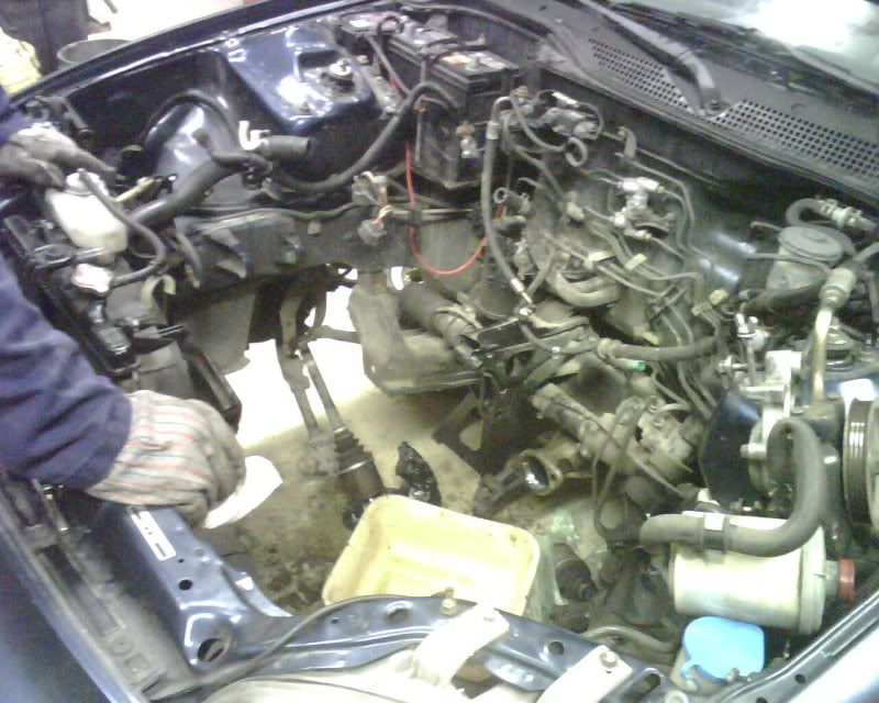

4x4 status up front, No engine/tranny, no weight.
I put the suspension back together and held up the axles,shift linkage with wire and pushed it outside so my uncle can use his shop for a few days.

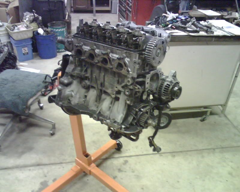

#132623 I Picked up an Engine Stand.
Also got my Bearings
Pretty much where I am at now. I have the head on, Pistons/Bearings in, etc.
Not much left to do to finish the engine, Just have to put on my new Water pump, Timing belt, and a few misc things, I should have the engine in my car come my next chance I get to work on it.
