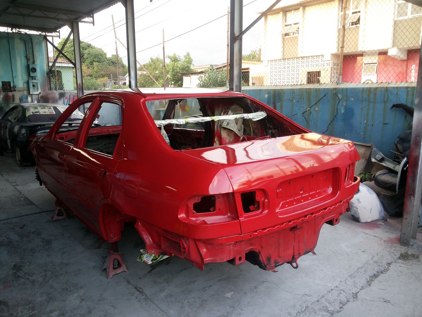

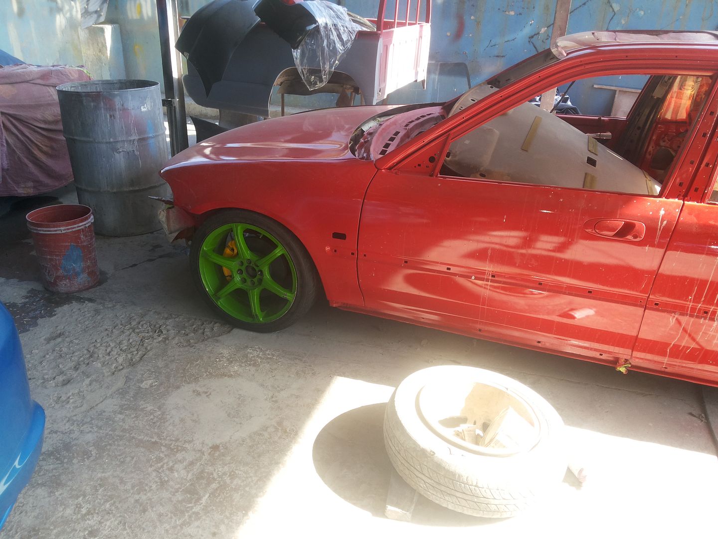

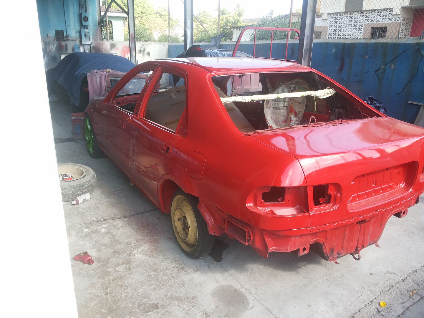

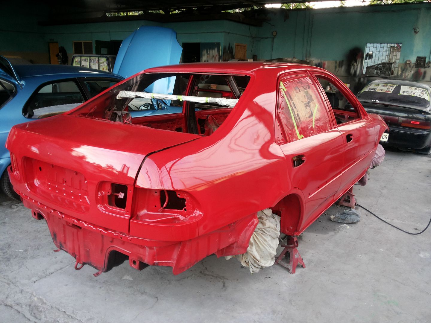

#352562 other bars .... i have removed the roofing since
By eg8civicJA
#352563 car resprayed since fixing the spots that were circled....

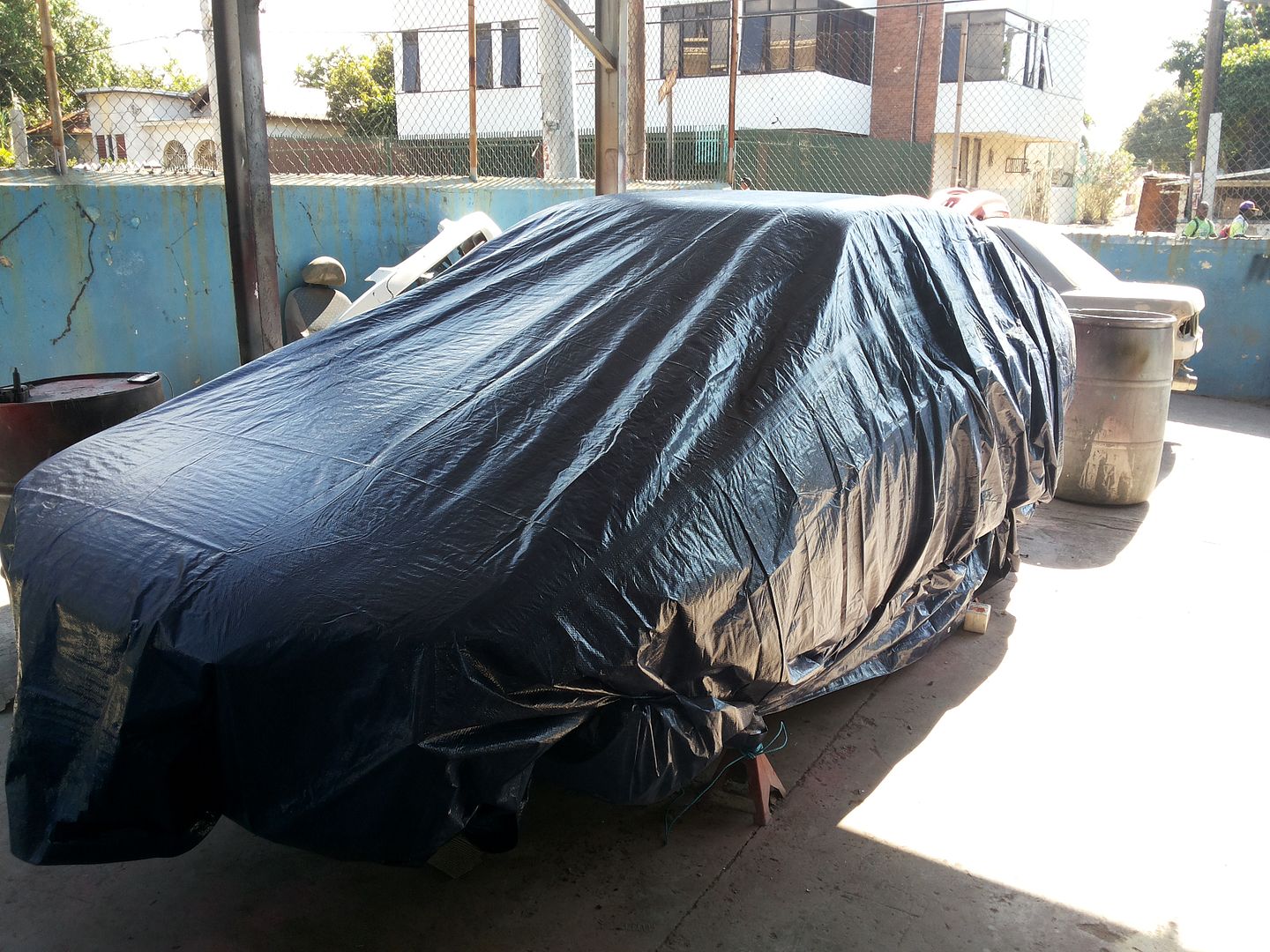

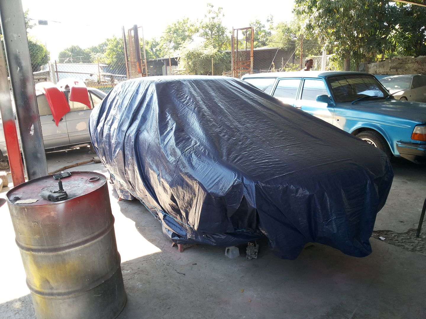

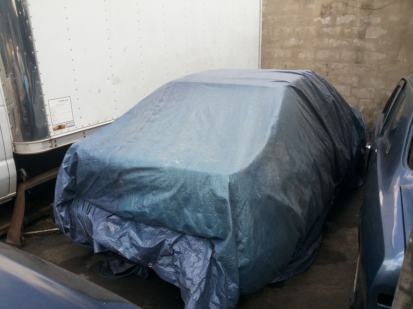

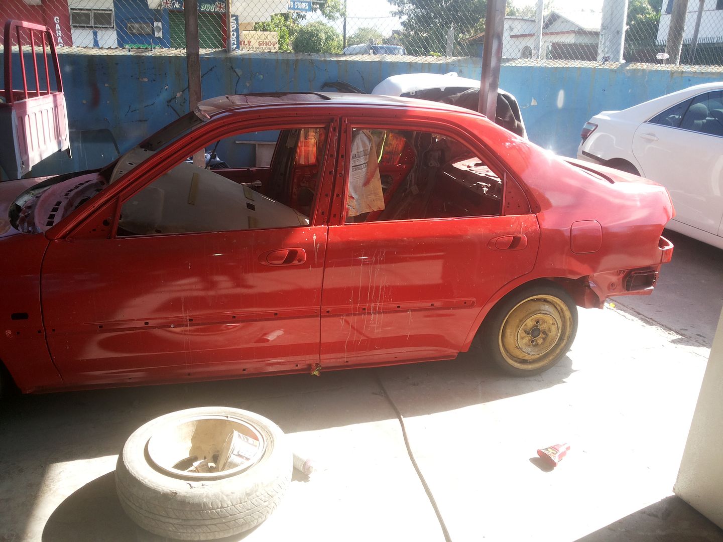

#352564 it was now the end of November 2014 and I decided to take a break until the new year.... my intention was to buy a car cover but decided to wait until the car was finished to get that and for now I would just get a really big tarpaulin
the car was left like this until January 2015 ... my next post will be about my intentions for 2015, as in parts list and plans

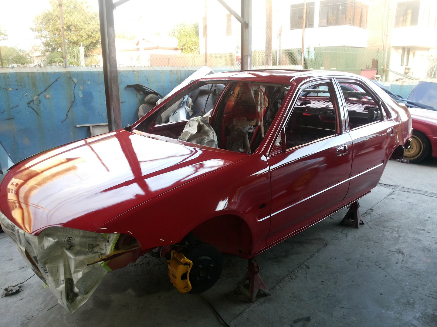

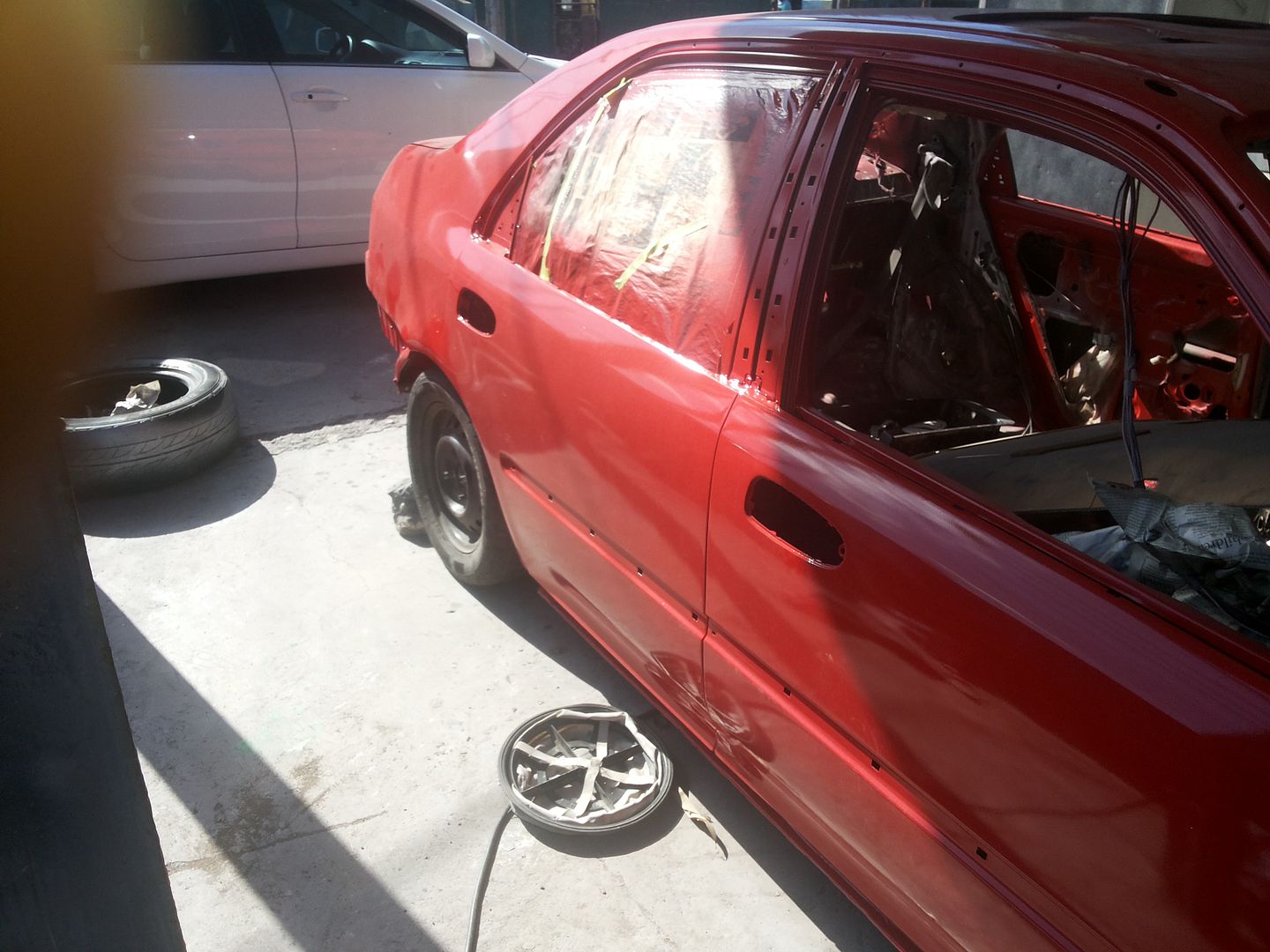

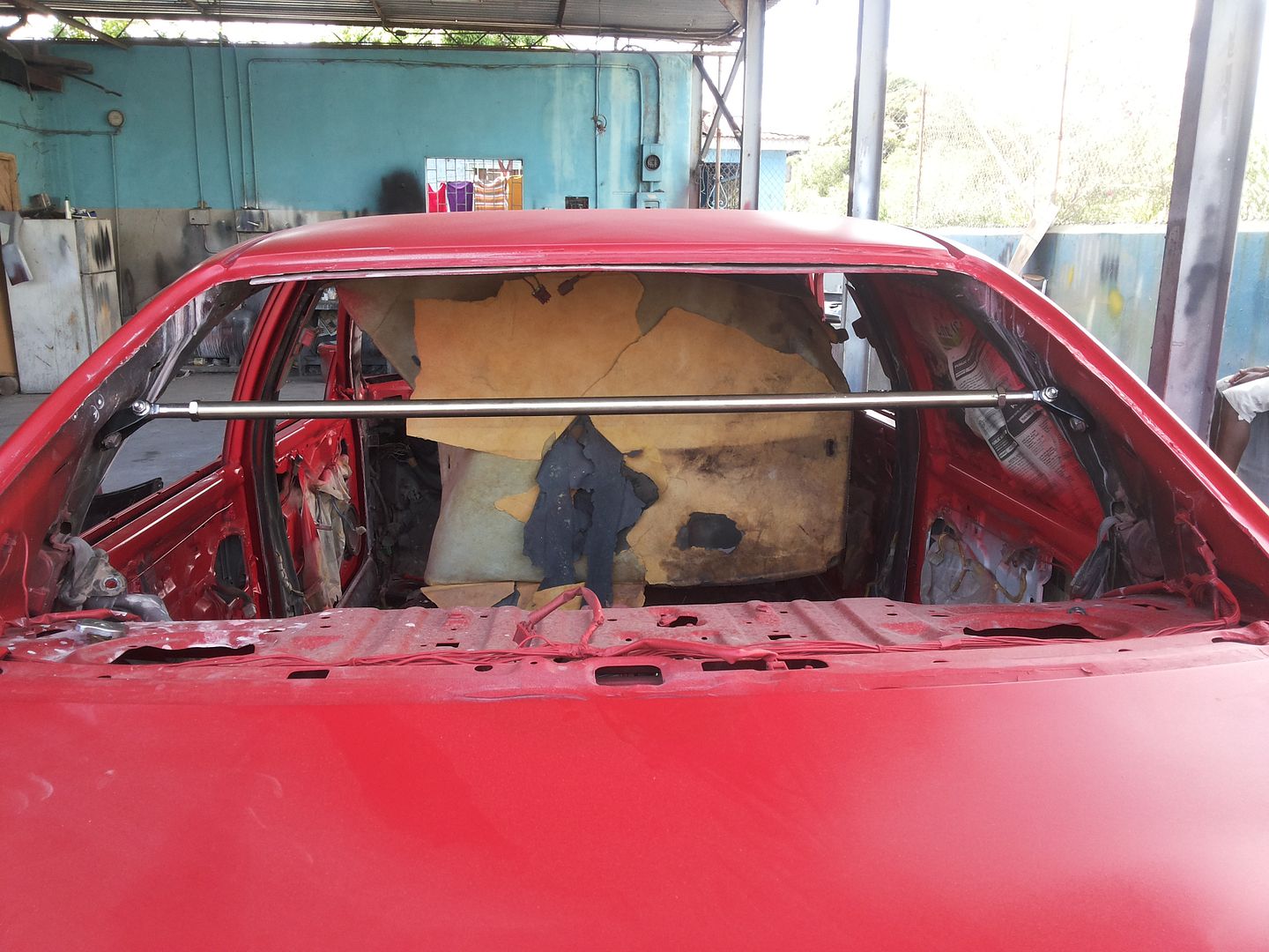

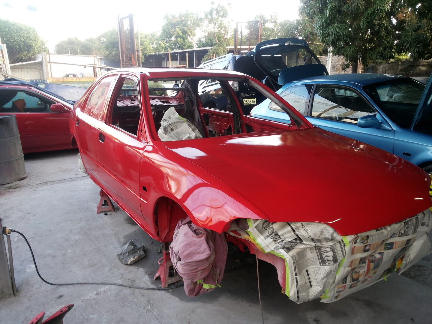

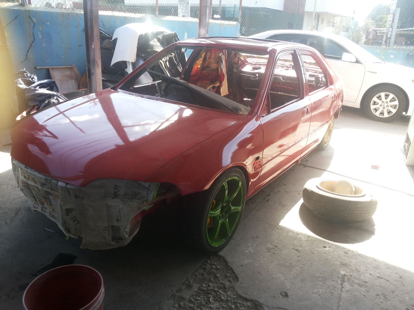

#352574 so its now January 2015 and i am ready to move the car to the mechanic..
but first i decided to do something with the car.... y? because i was still not satisfied that i was clearly seeing all the faults and never wanted to discover anything when i put on the actual paint
it cant be bad either for the paint job .. should look even shinier when done
i am actually happy i did it, because wales are now showing in my front doors and bonnet, things i couldn't see before i did this.. things that MUST be resolved before the final paint job
more lol
more
clear!!! it still needs to be buffed

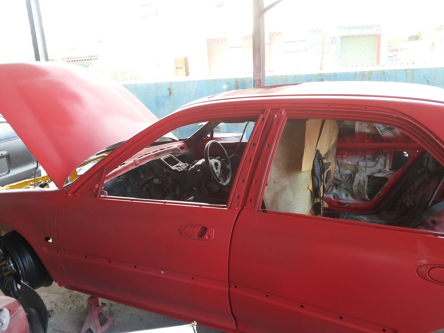

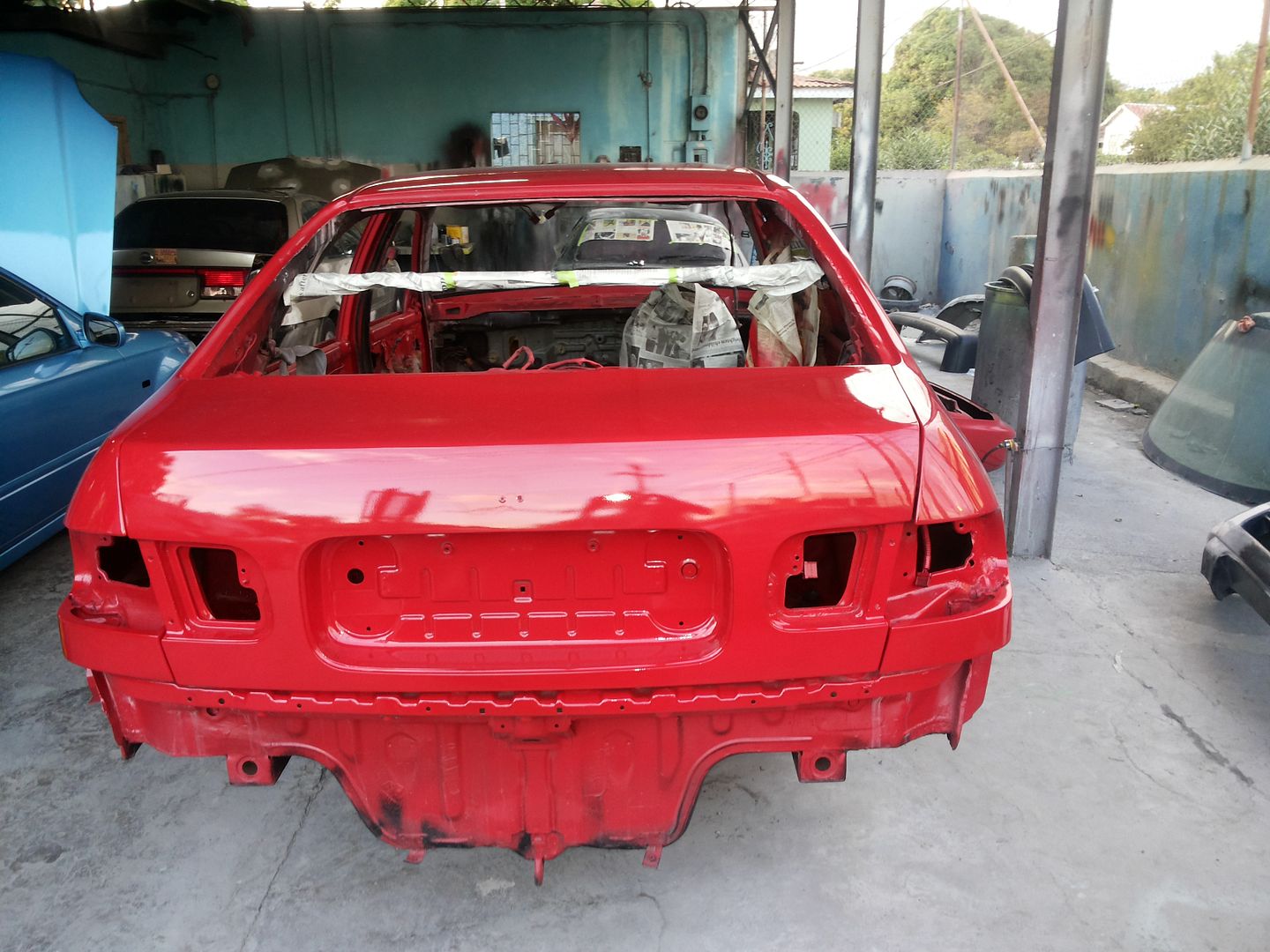

#352580 prepared for the move to the mechanic for setup... used the wheels off the other EG (crashed)
By eg8civicJA
#352581 reach to the mechanic ...
finally we are current.. March 2015 8)

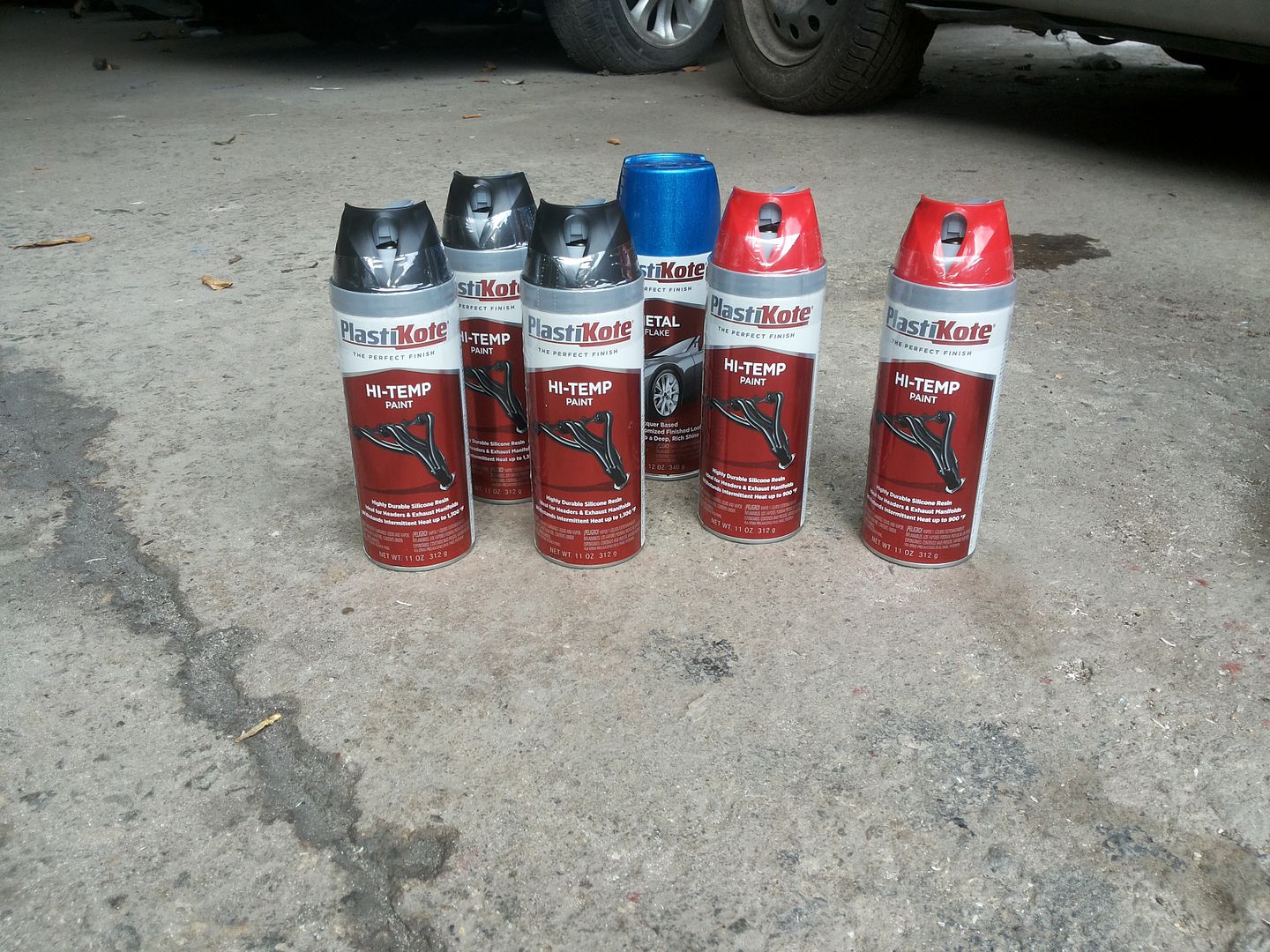

sorry for the late updates. i bought and delivered (to the garage) paint to complete the above from end of march, to date nothing has been done. seems i have to be there for any work to go on, which i dont have a problem with because then everything is done to my standard, its just a longer wait for progress
so i am trying to plan a 2 week vacation leave in June of which i will spend everyday at the garage (i am sure the wife will have a problem with this lol). the intention is to drive my car to work on my return (fingers crossed)
2 small changes in the plan above;
decided to spray my valve cover with the red spray first. will see how that looks first before i go the more expensive route (powder coating)
to save some money i decided to go with the stock manifolds and then see what the future holds. so they will be sprayed with the black spray
Hardlines BLUE
Valve cover RED
Block/Head BLACK
Distributor BLACK
Brake booster RED
Prop Valve RED
Brake master cylinder BLACK
Clutch master cylinder BLACK
Intake/Exhaust manifold BLACK

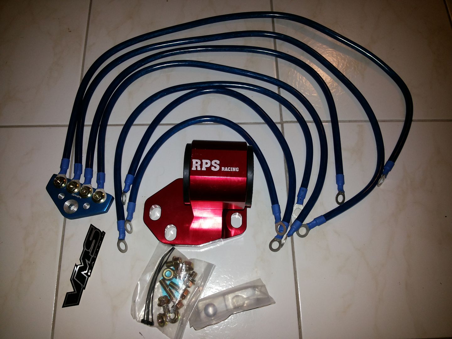

#353835 i got the stuff i had ordered
conversion mount
grounding kit
