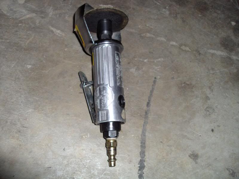

1. This thing worked wonders to remove pinstripes. No more heat gun and credit card. I put this thing on my air drill, and the pinstripes just vanished!

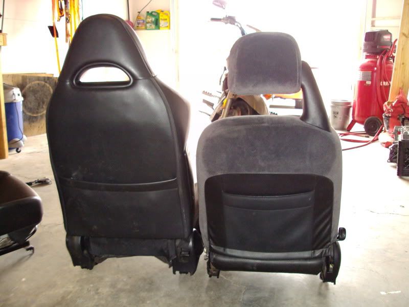

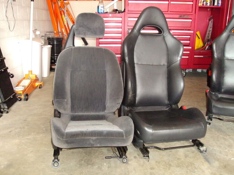

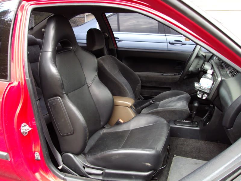

#239783 Picked up a set of black leather RSX seats to put in the car. It's a little late to get started tonight, so I will install them tomorrow. The guy I got them from said he had them in a eg, so the rails should already be modified.

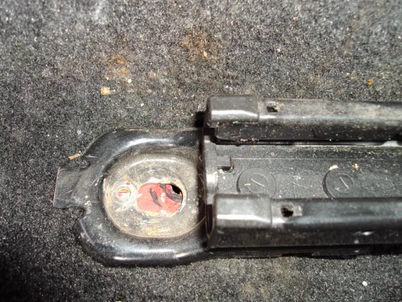

#239916 Well, I went to install the rsx seat and they are not an exact fit like the seller said. I'm going to have to cut off the rear brackets, move them up and re-weld them to the rails. The front bolts up fine. I dont have a welder right now, so that gives me an excuse to go shopping! LOL! Here are some pics.
The rear isnt off by much
The rsx seat will sit a little higher

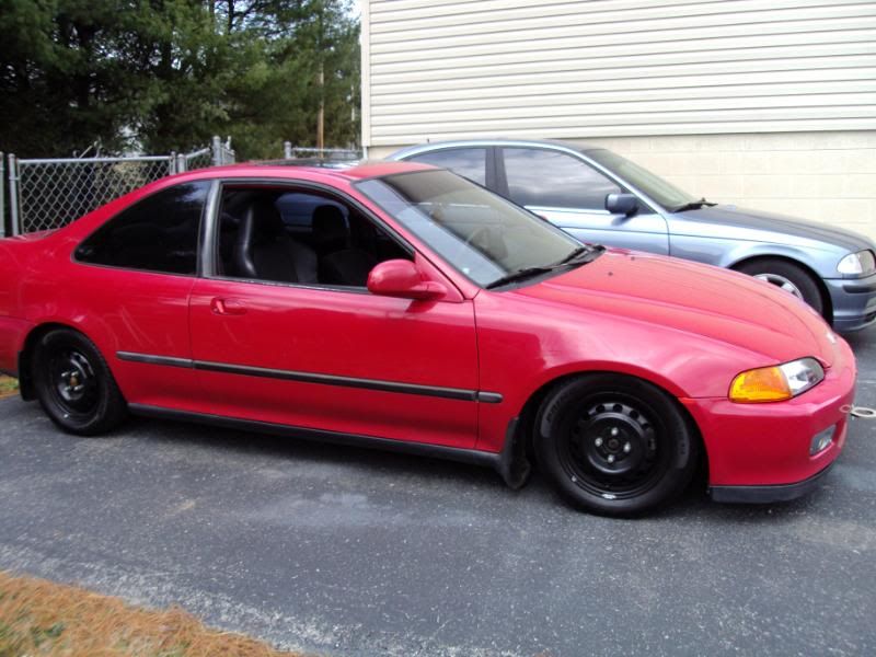

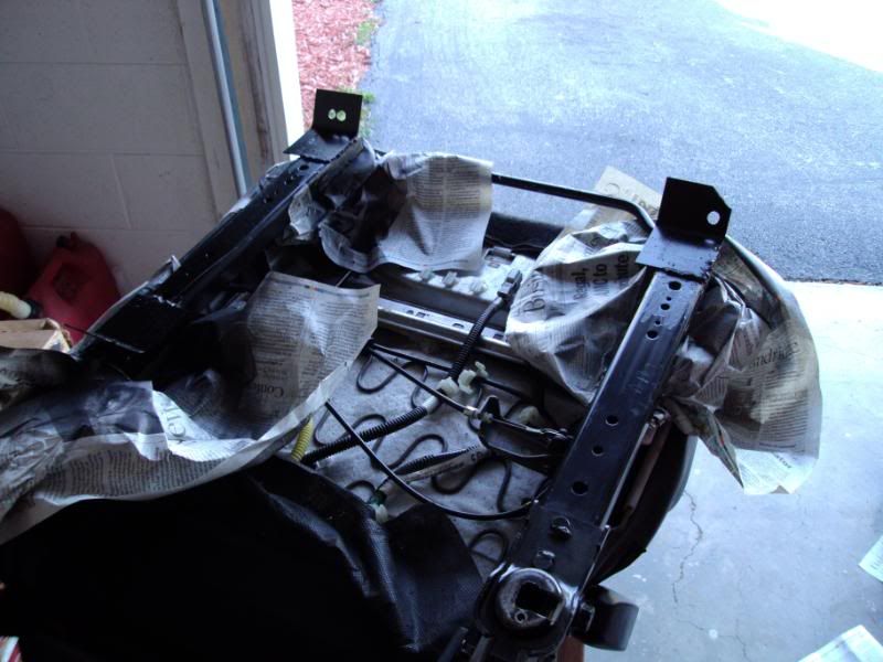

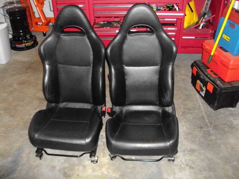

#243637 THE RSX SEATS HAVE BEEN INSTALLED!!!! (finally)

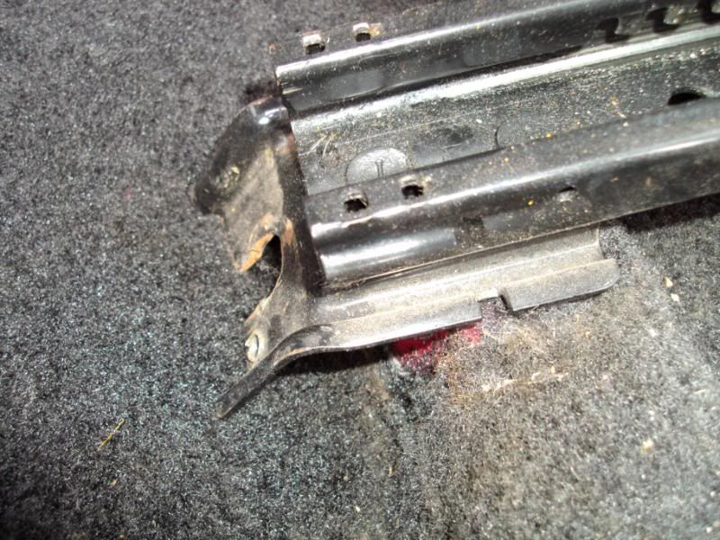

When I got the seats, the previous owner of them said he had them installed in his ej2, but they would NOT fit in my ej1 so I tried to modify the brackets to get them to fit. I didnt feel the brackets were safe so I cut/grinded all them off the seat rails but one.

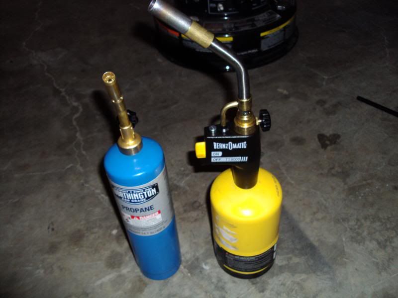

Used my trusty cutoff wheel and a little heat to get the brackets off.
took some flat steel stock
used some heat, and bent the metal to the angle of the brackets that were on the seat origionally.
By kingjmack

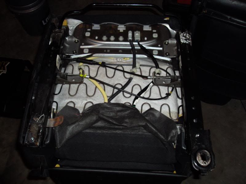

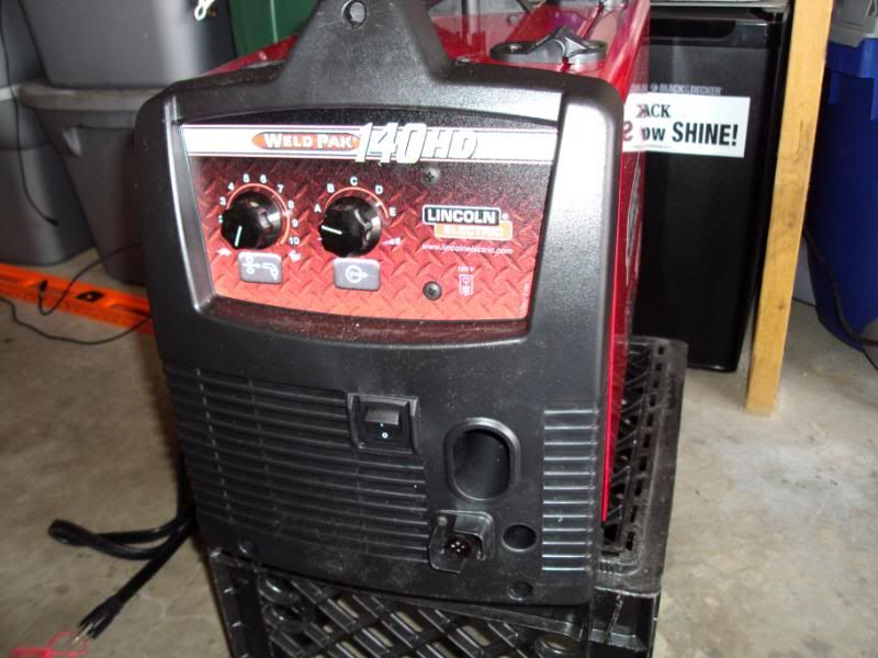

#243638 Then, I took my newly aquired welder
and welded the brackets onto the seat rails, and then painted everything where i had to grind and weld
The step I didnt take any pictures of is this. After i bent the steel, i put the brackets in the car where the origionals bolted to, and then set the seat in place so I could get a good idea of where the brackets needed to be welded on the rails
