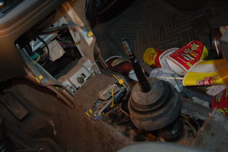

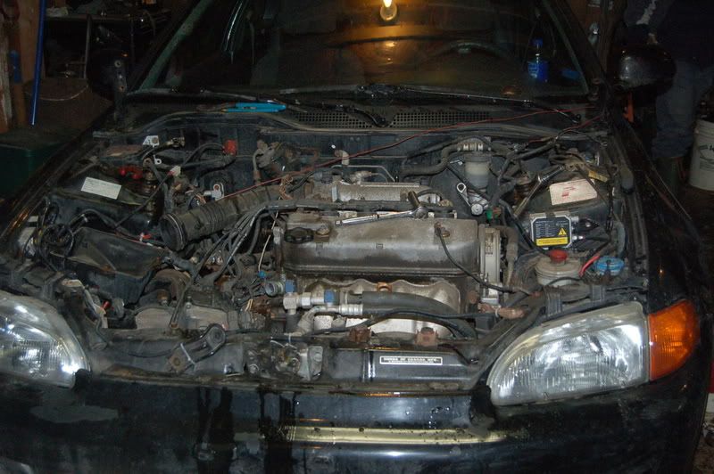

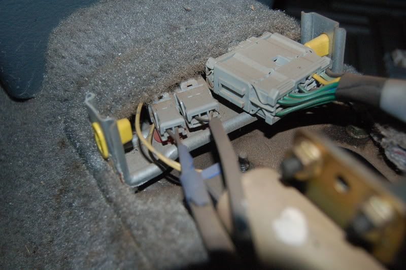

#37576 few new pics, of the harsh winter beating!
As for the auto to manual swap, I picked up a parts car a few weeks ago, its all stripped of the parts I need. Should be going the swap shortly.
What I had from my 92 SI
-d16z6
-SI tranny
-flywheel
-clutch
-shift linkage
-P28 ecu
-Manual starter
-exhaust manifold

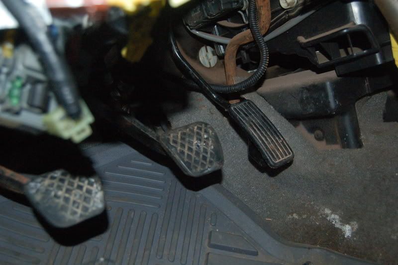

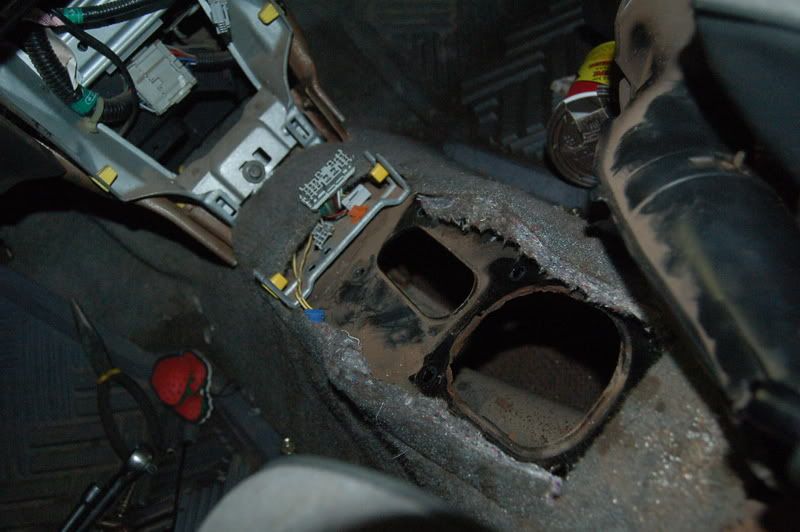

Off the parts car i got the rest of the stuff needed for the swap
-pedal
-clutch relay
-manual mount
-interior harness
-shift knob
-master cylinder
-clutch fluid container
-clutch lines
probably forgot to list something, but il keep this updated, and do a write up for those that are going to be doing the same swap.
clutch rely, good idea to have it, but not necessary.
I will take more pics, of the rest of the parts needed.

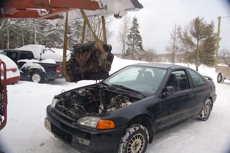

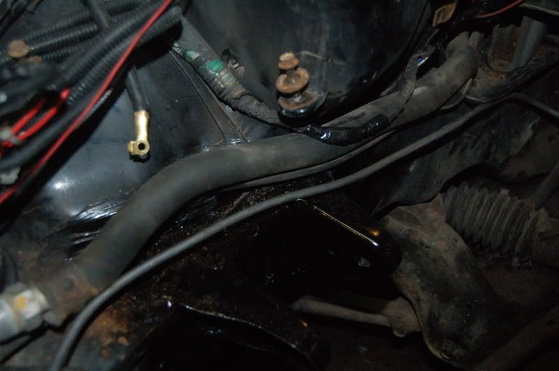

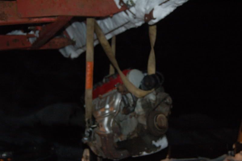

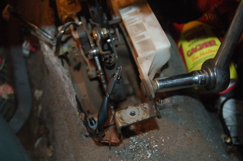

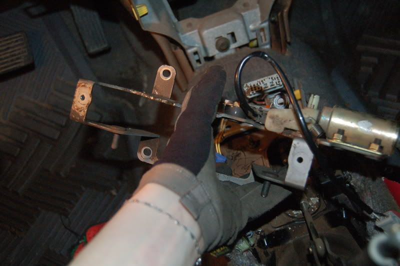

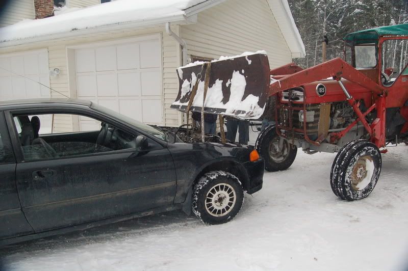

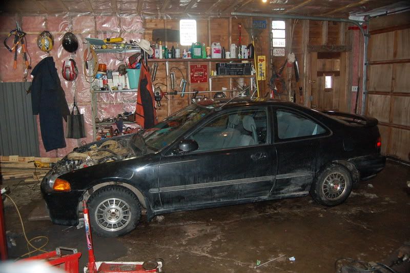

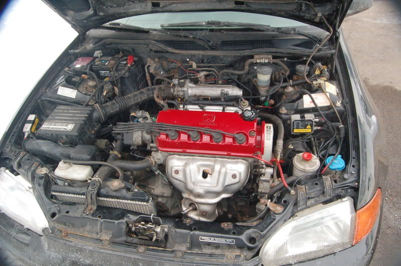

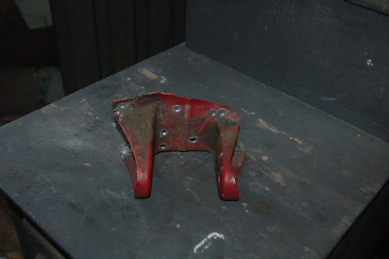

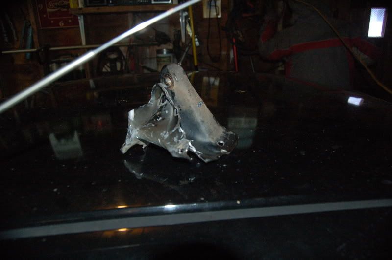

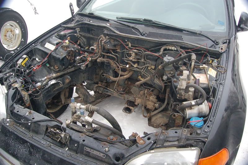

#44699 swap is done :D
So we got the auto to 5speed swap done this afternoon. Started yesterday took about a day and a half all together. Everything went real smooth, just had a bit of trouble with bleeding the clutch, it just didnt want to bleed lol!
any who heres the pics!
mangled auto mount we took out lol
5 speed mount :0)
welded in and painted
Woot! all in and running fine :0)
I do need to pick up a manual throttle cable and shifter bushing. Also the vibration mount was different for the auto.
#44700 :woot: finally done, just need to get yourself a shifte bushing now :thumb:
By Outkast-Jayco
#44707 OOooOOOoo pulling out engines with a tractor is freakin awesome!!! Nice work!
#48248 Sweet looks good
#48257 Using the tractor as an Engine Hoist was Epic. Made me lol so hard.
I am liking what your doing with it, If you keep it up it will be to nice to be the winter beater. :lol:

#48270
chrono404 wrote:Using the tractor as an Engine Hoist was Epic. Made me lol so hard.
lol yea were a little countyish :P
