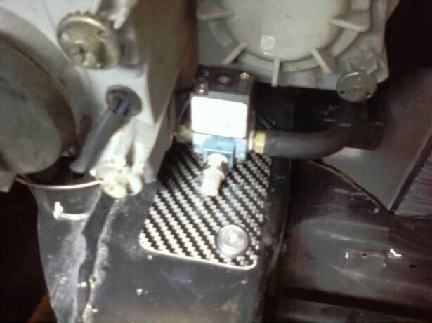

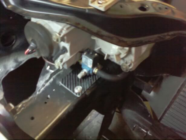

Made a carbon fiber mounting plate for my AEM boost solenoid,
I'll get better pics in the morning (not cell phone shots haha)

wow on that tranny...looks like someone has done some research :thumb:
i'm excited to see more updates on this beast...where did you get the carbon fiber?
Yeah haha. Guys making over 450 have a hard time (took a year to break the first one, which only cracked the case) breaking this thing, when normally they were breaking a trans 1-2 times a week.
First i bought a sheet from dragonplate.com, then i just ordered an ebay caron fiber lisence plate from for like 20 bucks, then used my jig saw with a metal blate to cut it up. i originally bought it to make my block plate/gauge pod, but now i've been using the left overs to make other stuff
