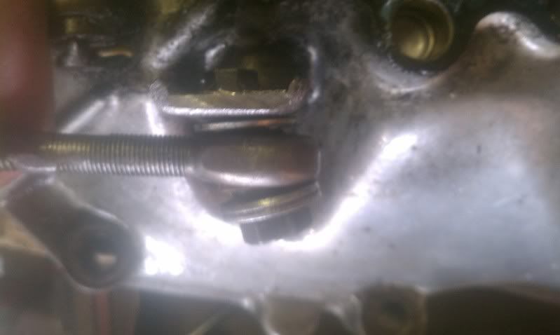

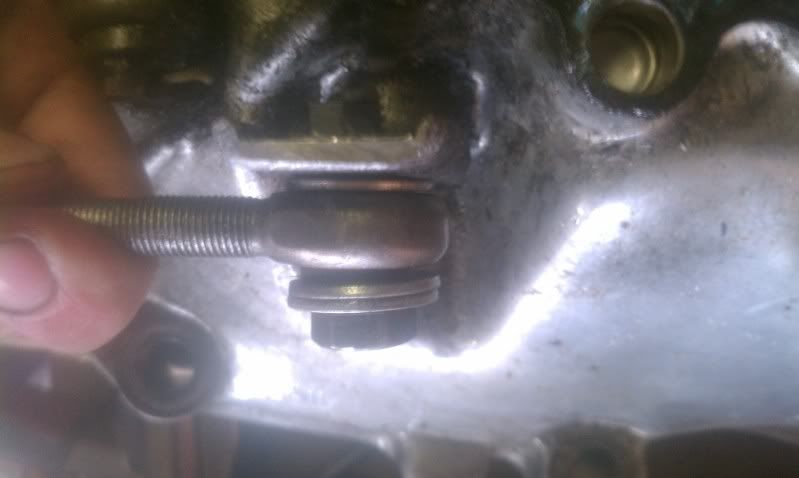

The bolt that i had on the clutch cable arm had a nut on the back side, well the nut is no longer there. The first pic shows the angle the bolt SHOULD be at.
This is how the bolt sat..
Meaning the clutch wasnt disengaging. So basically i did a 1-2 WOT shift with out the clutch. oops haha. Trans still works enough that i drove the car 30miles back home, and then to cars and coffee the next morning. Just skipped 2nd gear :P
