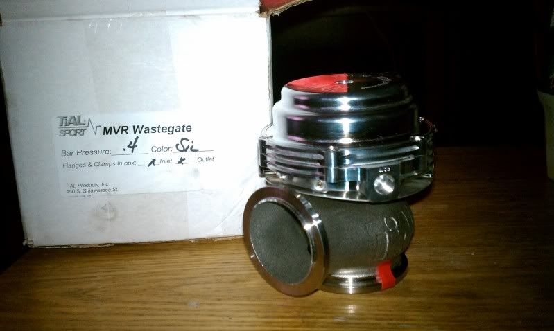

#227565 Oh hai. Last piece to the puzzle fellas,
Tial 44mm MVR wastegate :)

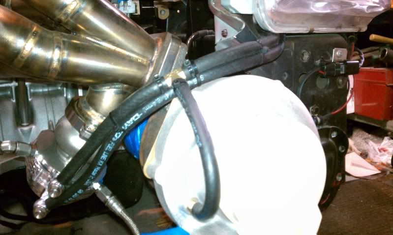

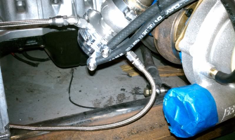

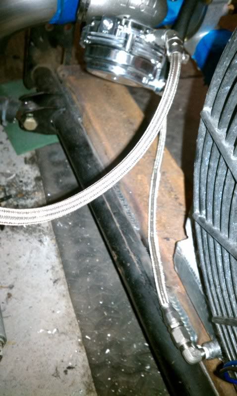

MVR's are water cooled, so here's the lines i ran.
Vacuum lines ran from the AEM boost solenoid.

{ikon}EM1 wrote:Do u have a line from the rad to the wastegate also????
Yeah, The water feed line is tapped into the upper rad hose housing, then water goes through the WG and out threw the other line and returns into the bottom of the radiator. :)

#227630 wow, a water cooled wastegate eh? that's pretty kickass, i mean they do get hot, does it just increase the longevity of the gate?
nice lines, is the turbo water cooled as well?
