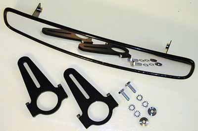

By Blk95coupe
#295367 Awesome build man!
Could you take some pictures of your rear view mirror?
By Blk95coupe
#295404 I guess it bolts to the roll cage?
By known
#295405 Yeah, I assume you could fab something up pretty easily without having a roll cage.
