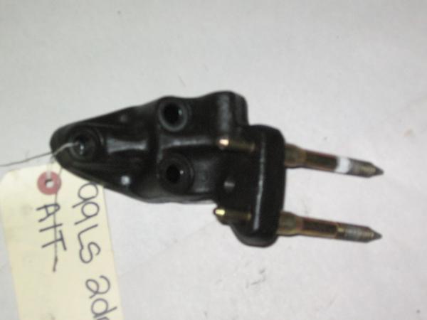

By asianrob
#213027
kapow wrote:So confusing :(
its not so confusing trust me
94-01 integra motor mounts is what your needing.
http://cgi.ebay.com/ebaymotors/Hardrace ... ccessories
http://cgi.ebay.com/ebaymotors/94-01-ac ... ccessories
this one will be from the block to the mount.
