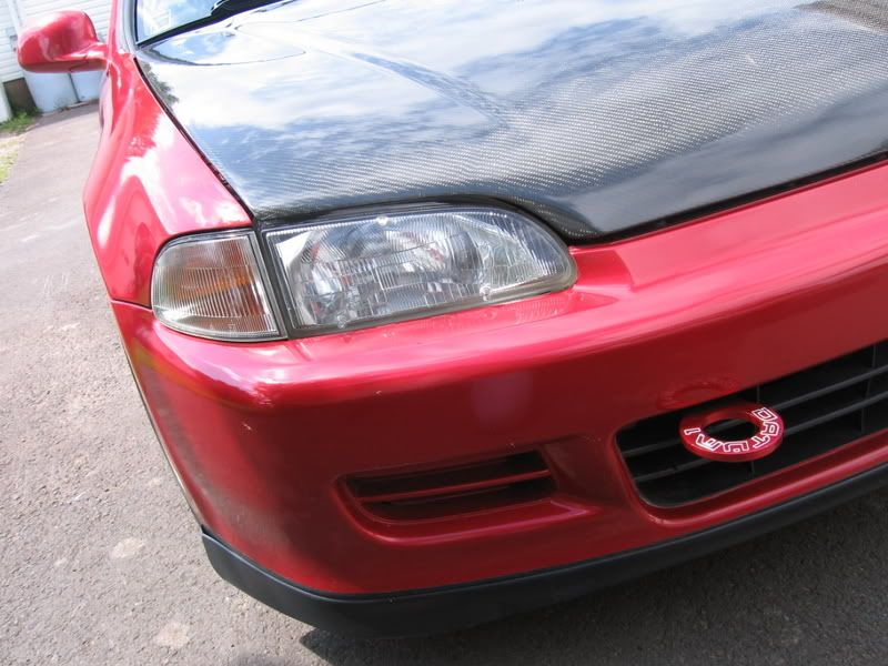

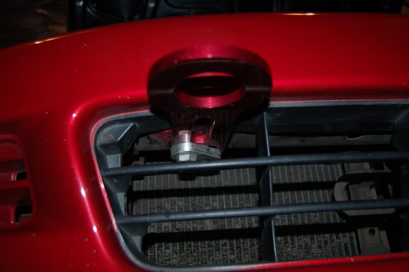

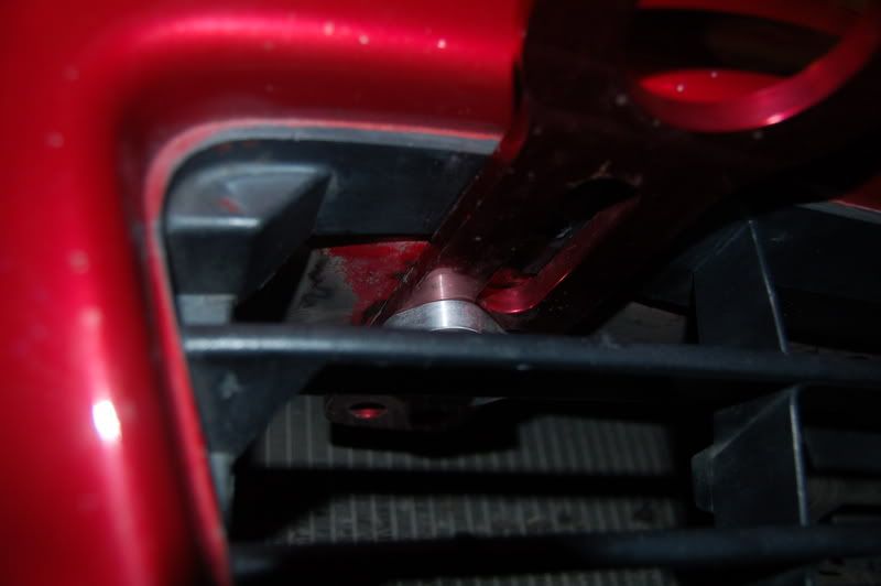

#49305 you shouldn't have to drill holes, I mounted mine right to the frame up front. I only used one bolt tho not two. I will try and find you a pic
#49309 Here ya go, I dug up an old pic. :thumb:
I DID have to drill out the holes.
