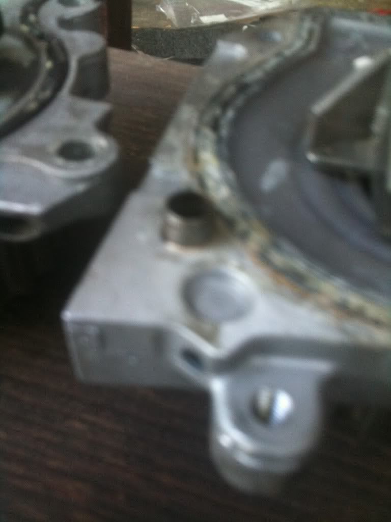

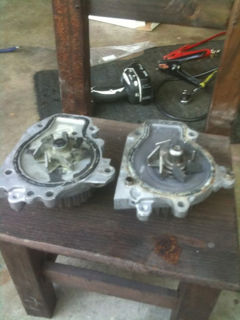

#270937 im wondering if a b16 water pump would work on a b18c1? as far i can tell the difference is the 2 metal things where the bolts go.. would they work thnx fellaz
b16 on left gsr on right
the difference i see

#270944 you can match up the part # for the next time but the 99-00 si water pump will work

#271546 All b series vtec water pumps are the same 22t. All ls and b20 96+ spec are the same 19t
Hope this is help :thumb:
