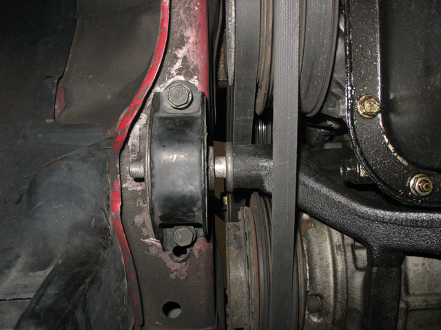

The driver's side torque mount barely exists. It's supposed to stabilize the engine by holding the AC mount bracket (even on cars w/out AC), but Honda wanted to avoid having the car vibrate at idle. The result for us is that this mount is ripped and worthless. It's pointless to replace with brand new because it will just rip again.

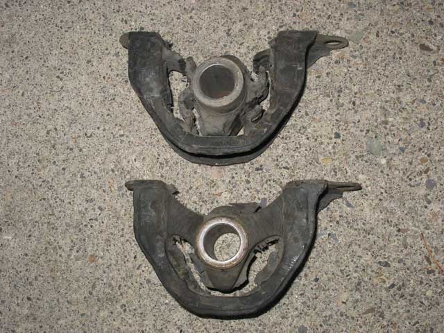

The passenger side torque mount has a lot more to it. I wondered how much vibration it would cause if they had used this much rubber on the driver's side.
Then I compared them to see what would prevent me from using a passenger side torque mount on the driver's side. The bolt holes line up but the passenger side is .5" thinner. If you slap the pass side on the driver's side stud, there's a gap that allows the engine mount to slide around, defeating the whole purpose.

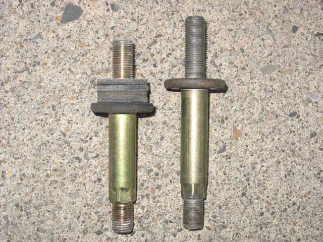

Here I compared the studs from each side.

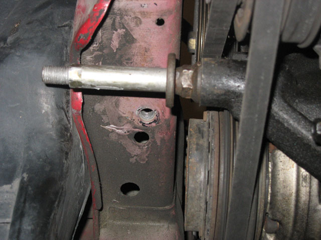

You can screw the pass side into the AC bracket on the driver's side, but then the mount wont stick out far enough to reach the frame rail.

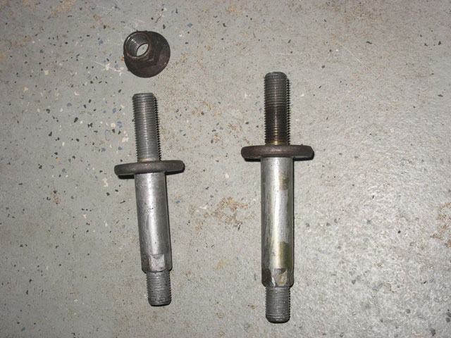

I then took the extra nut I had from the junkyard mount and used it as a spacer. Not the cleanest solution but suitable for this stage in the proof of concept.

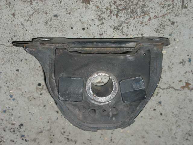

Later I found that the three bolts holding on the passenger side torque mount have thick washers that you can use as a spacer. You'll need the fourth washer that's on the end of the stud when you get the donor mount. This pic is from my Civic. When I add this to the site in my sig, I'll use the pics from my Civic EG.
