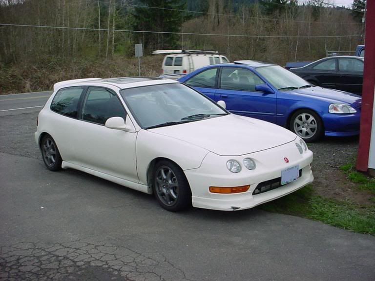

#40619 Hey im running into issues!!!! help haha i have the front clip and have been test fitting but i think im doing this wrong.
If any one has, like a step by step way to get it done that would be sick if you could help.
Some say use civic fenders and cut to match front bumper...
Some say use integra fenders
some say use integra coresupport, some say no coresupport IM LOST HELP LOL :? :? :? :?

more than likely you'll have to cut and match
you might have to use the integra rad support so it'll sit right too

#40760 The way I've heard it's been done, is you have to drill off the old rad support and put on the teg one. then use the back half of the civic fenders, and weld the teg front half (the side that would meet up with the bumper) to them, so the bumper and hood fit right.

#40778 i forgot my buddy did it to his coupe lol he used the integra rad support fenders and hood and bumper lights etc. looks ok i guess he did to an EG coupe

#40863 I can tell you flat out. Been there done that. I'm actually removing the entire front portion including core support just because it looked goofy. Yes you do have to use about 11 inches up of the rear of the civic fender, and the rest of the front of the integra fender. Straight up pain in the a**. but if you still want to do it, other than the body work it too me all of an hour or 2 to do the sawp.

#41056 wow imo that coupe looks DAMN good lol
By BAXTER_EJ1
#41057 I dunno, kinda looks like it's smiling in an akward way :eh:
#41060 Looks shit... Considered just buying a teg! :lol:
