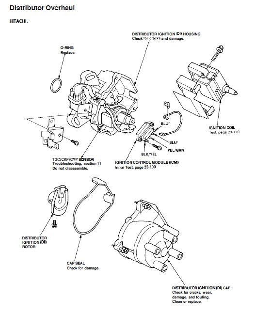

By Classiccarsrule85
#177560 Image
Ign. control module....
well if its a d15b i think you can use a D15b7 dizzy with it or something like that....id try and get it back up the driveway and try and locate a dizzy to test.....
like i said it might just be something that was going and haveing a brand new part making it work differently caused something to happen.......
but yea to be honest id jsut go ahead and try to get it out of harms way.....
also did you check all your fuses thats the first step since dizzy's depending on where you are could be a bit expensive btu yea shouldnt be too much
