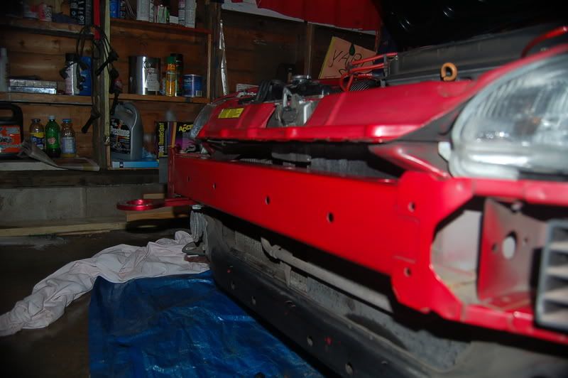

#78649 It mounts on the front support frame. It bolts right up no need to drill
#78717 I had the same problem bud. Just to clarify things up, the tow hooks arn't actullay designed to be used. They are there for show only. You can mount them anywhere, most mount it under the bumper at the front to the radiator support, which will require drilling. Also, as shown above, you can purchase that bar, and mount it to that. But that bar is also just as weak as the fron radiator support, thin metal.

......oh yeah, BTW, that front impact bar is nowhere near as weak as the front radiator support. Its like a 35 pound chunk of steel.
#78785 I wasn't talking about EVERY tow hook mate, I know tow hooks serve a purpose ffs... lmao I aint even gonna waste time typing because you're admin, and it aint worth the argument.
So yeah, bolt your front tow hook on and use it, watch your front rad support bend / rip off then, seeing as Honda only spot weld them on... and you know, seeing as I've had to replace 2. What are you gonna tell me next, that you can jack the car up on the front rad support :lol:
For the record, I had one of them front bars shipped to me from the US, and it was weak as fuck. OEM part too.

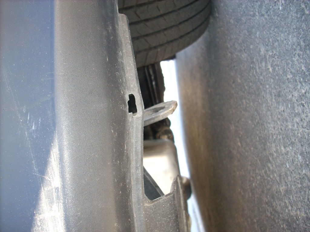

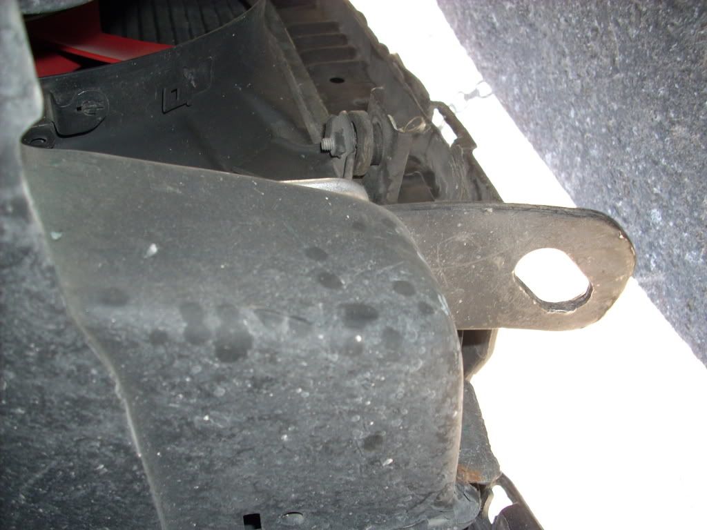

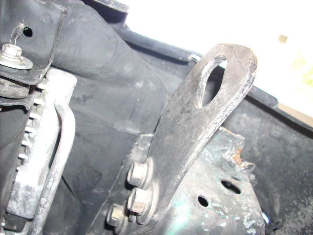

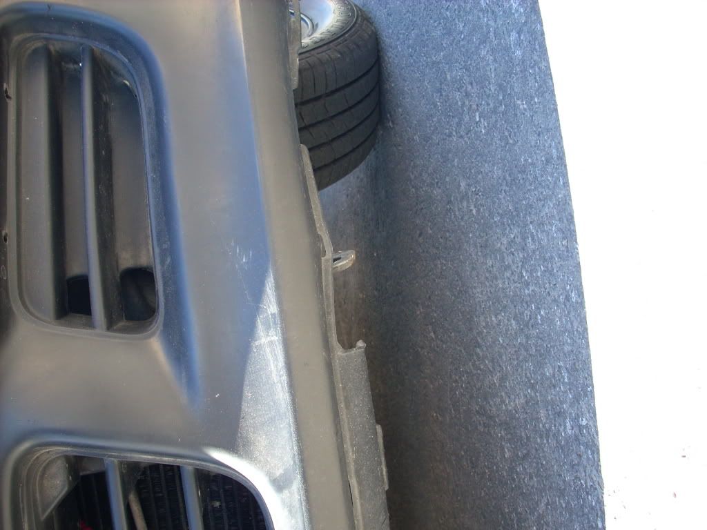

SlipCivic wrote:So yeah, bolt your front tow hook on and use it, watch your front rad support bend / rip off then, seeing as Honda only spot weld them on...
Mine is bolted on not welded :lol:
And the tow hook comes stock. It seems to do alright. Pretty sturdy.
#78801 Ok, firstly I said the radiator support is spot welded on, not the tow hook. Secondly, that OEM tow hook is not bolted to the radiator support, but the chassis.
From what I belive, it's a Coupe thing? As my Hatch didn't come with the front OEM tow hook, but my Coupe did.
The J's racing tow hook bolt up where the OEM one goes. The proper place where you should tow the car.
