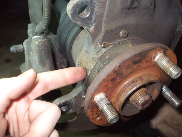

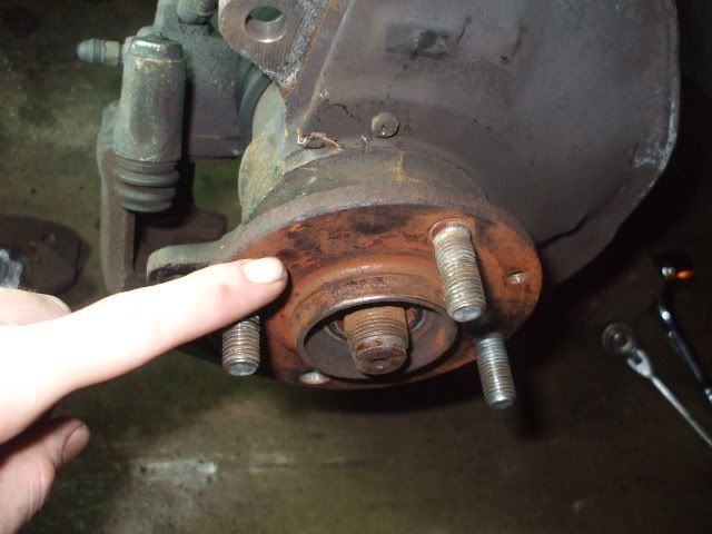

#162162 how do i get this
off of this
By asianrob
#162168 take off the axlenut, axle (does not need to be take out from the trans but from the hub), upper A-Arm, lower control arm, take off brake caliper.
assuming it you are going to replace those studs take it to get it pressed out any place that has a press can do it.
By Dippin_EG
#162171 indeed you wll need a press. and you also will need to take off the nut for the tie rod and bang it out... i hate balljoints :lol:
And props on the idiotproof question. :thumb:
By ikon
#162172 yeah man who needs paint shop :lol: i was hopin i didnt need a press but oh well. ill just replace all the studs and do it right. so is that the only way to replace the wheel studs besides grinding them down?
By asianrob
#162174 its the only way lol... might as well go ahead and buy a new wheel bearing and ball joint if bad. get them all replaced at the same time! or go to the junker and get another spindle
By sneepereg
#162178 make sure to post picks ill be doing this soon hopfully
