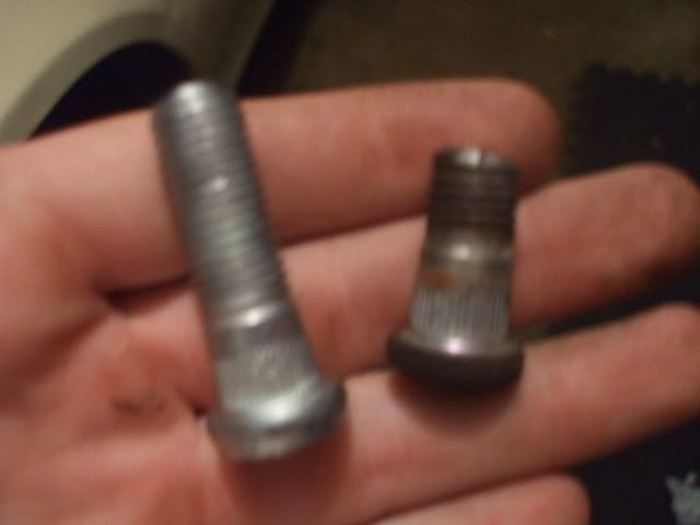

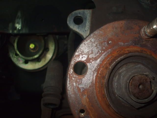

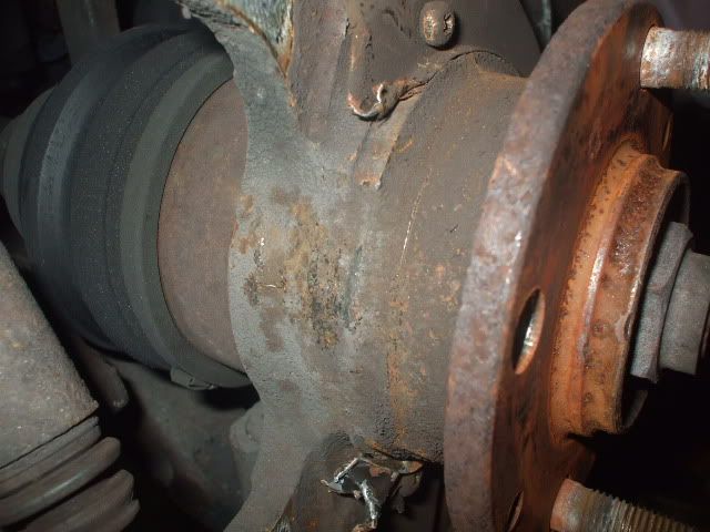

#160974 i was driving home and one of my frount wheel studs snap. i purchased a new one and the old one popped out fine cuz it was smaller but now the new one is to long and i cant slide it in. it hits the suspension. im wonderin if i have to take off the hub to slip the stud in. heres pics.
snapped studs
u can see the hole and whats hitting it in the middle.
i tried to cut the heat shield to allow more room but it still wasnt enough.
do i need to remove the axle nut and then the hub?

#160975 you have to get it pressed out. any shop with a press can do it. some shops may be expensive some may not.
By ikon
#160980 so i have to get an axle nut to take it off then get it pressed off at a shop? :?
By asianrob
#160981 yea. you need to take off the axle and axle nut and take it off the car.you dont need to disconnect the brake line but you need to take the caliper off (its only 2 17mm nuts i think) and the rotor. it would be easier and may in some cases be cheaper to just bring the spindle up there for them to press it on and off.

#160982 but do i have to get the part that the studs go into pressed off or will removing the axle nut solve that.
By asianrob
#160983
ikon wrote:but do i have to get the part that the studs go into pressed off or will removing the axle nut solve that.
removing the axle nut will not solve that.

#160984 grind some off the stud itself. i just put in extended studs, and there was no way of gettin around takin it all apart. but when looking into it i found DIY's on h-t on the "not manufacturer recommended" ways :P

#160987 i just wanna fix it tonight so i can drive tomorrow. i dont wanna have to buy an axle nut. imma grind some of the stud down. thanks.
