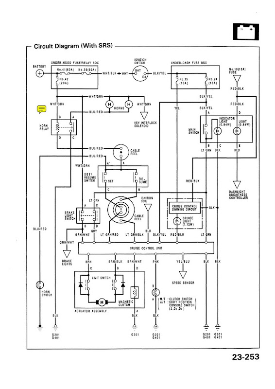

Checked main switch, jumpered the clutch switch harness since I can't get a multimeter up there. Light on dash doesn't work and cc will not engage. I think my clock spring is still good cause abs is not on and horn works. Haven't tried cc actuator yet. I think I got the wrong fuse diagram under my dash...anybody know the fuse numbers? Suggestions?
