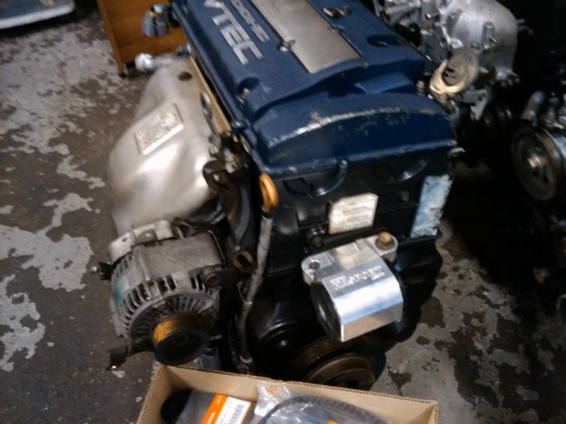

EG6b20R wrote:Preparationssssss!!! :woot:
im just seing the pic for the first time....thats not going to work
By mooze

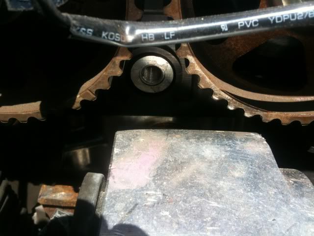

#254472 see how your mount is leaning down ..... like the left side (exhuast cam)is going down away from the cam gears.
it needs to be like this
in line with the cam gears.....
you wont b able to use any of the plastic covers so you can go ahead and take them off

#254476 Image
this should help u see it a little better... its my first start up run vid but you can see exactly how the mount is supposed to sit in relation to the valve cover

#254487 No no that's just the EGh2 driver side mount i was showing. nothing fabbed up just yet.. lol just sitting on there..
Patience my friends. It'll be in shortly... lol. Just waiting on the tensioner for the timing belt. once all needed parts are there then it goes into the bay. I tend to do preventative maintenance before settling things in. Like Timing belt, water pump and stuff.. lol..
