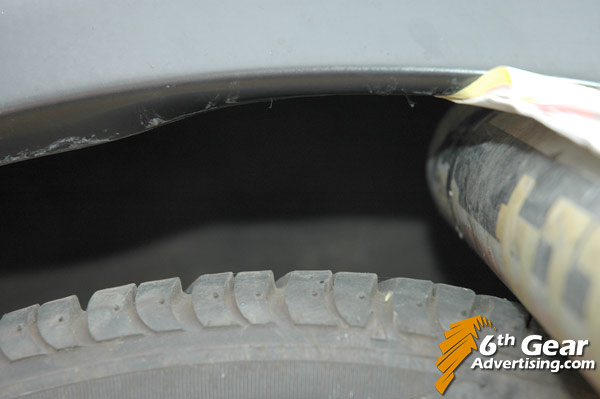

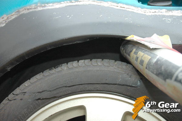

The way I'm going to show you is Free!
The main concern is having your paint crack from the stress, this can happen with either method, but is more likely with the free method. This risk can be lessened by using a heat gun while rolling. The best time to roll is when you will be painting your car.
Put your wheel/tire on and with the car on the ground, look at the amount of space. Find a bat or pole that isnt too big. If you're trying to do this with your aftermarket 17x7" rims with 205/40/17 tires, you might have some problems. I had a set of GSR wheels with 205/55R15 tires, an average size bat fit perfect. Lift the corner of the car up a little so the wheel is still touching the ground. Insert bat (may want to put a piece of cardboard or similar between bat and fender so you don't scrape up your bat). Slowly lower. Now just turn the bat between your fender and tire and roll it along.
Go slow and take your time. I went over it twice and gained about an extra inch of clearance!
