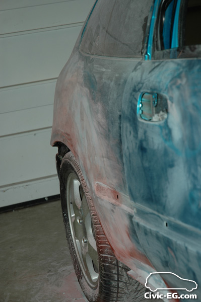

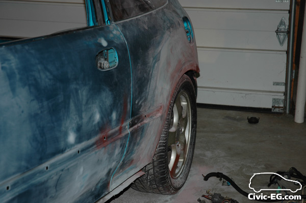

When you are welding, be VERY careful not to get the metal too hot or it WILL warp. The metal on these cars is so thin it can happen very easily. Both sides of my car were warped inward after I was done welding. I kept checking them in the beginning and they were ok. It must have happened at the very end when i was going back and tacking in between all the welds. So I had to use some filler in the warped area to fill in the recessed part. It was very time consuming to scuplpt it back to the shape of the car. But after much sanding, it is complete. This was the first time using body filler and It was hard to get everything perfectly smooth and not wavy. Basicially you will start with a long board or long sanding block. Start big and then work your way down to the minor imperfections. here's some recent pics....
The red primer you see was used as a guide coat. Then when you sand, the areas that you sand through first are the higher areas. Be sure to use sandable primer, not cheap stuff or you will only clog up your sandpaper. I started off with 80 grit to shape, than switched to 180 grit once I got the waves out and it was time to focus on small areas.
