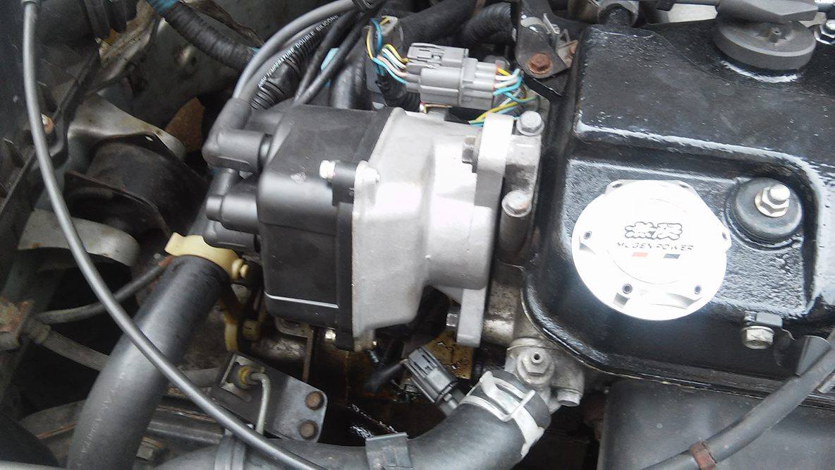

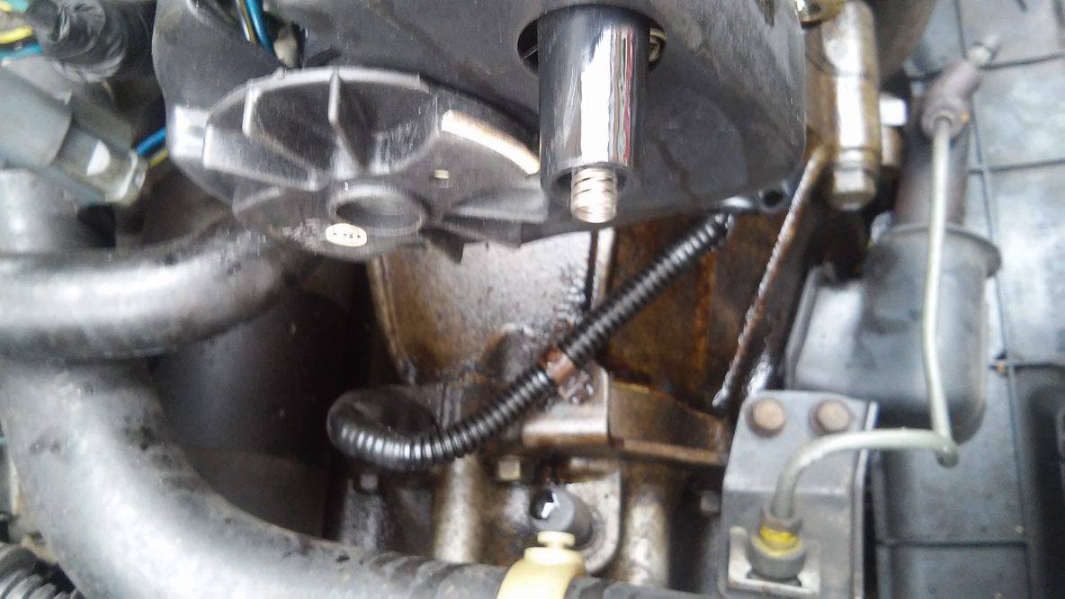

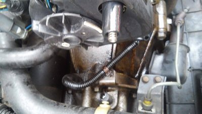

#359660 Cammie, you will need to change the oil seal on the Dizzy. You can order from Honda. The cap doesn't look that it has an oil seal around it either. You will need to replace and while you are there, you can do a tune up. Clean first and then replace the parts so you can see if you have a leak again.

#6908550 They sell the internal o-ring set at autozone. I repaired mine a while back, but the internal wiring started cracking as I moved it around. Be extra careful inside the dizzy because our cars are getting old and the wiring is brittle. The o-ring set was a small challenge to install. Biggest thing is to ensure you get the camshaft connector aligned the correct way.
